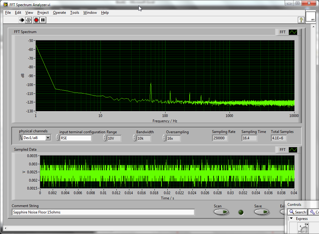

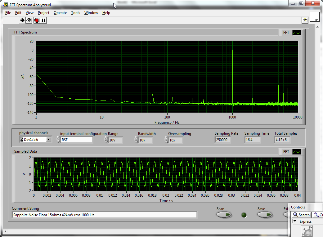

So here's the prototype on the bench, pumping out 1 V rms into a 15 Ohm resistive load, with the buffer outside the feedback loop. That's 100 mA peak output current, hard into class B.
0 rms noise baseline shown for reference, note the output DC offset voltage is only 2 mV.
~0.0001% distortion at 66 mW into 15 ohms open loop. Holy craptasticles Batman!

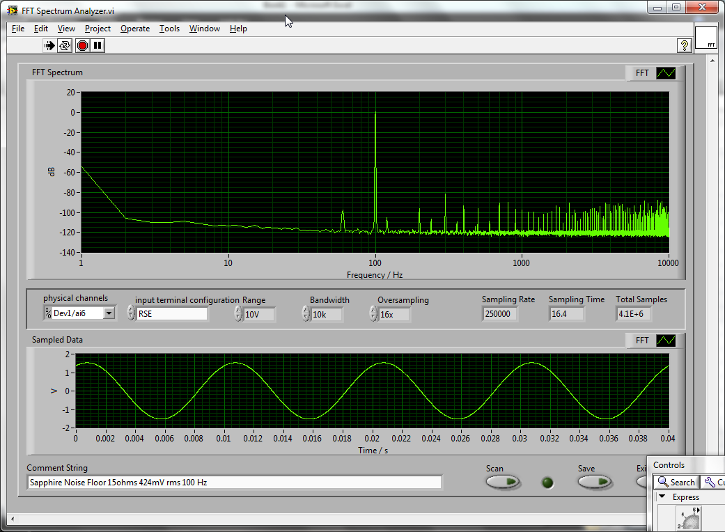

PS The harmonics of the 1 kHz sine are mostly artifacts from the (digitally generated) sine wave signal rather than distortion from the amplifier itself. Anything below -80 dB for the sine harmonics is likely generated by the source. The power supply hum at 60 Hz is most likely stray pickup as the power transformer and circuit board were just sitting open on my desk.
Attached is the 100 Hz sinewave, measured as above, where distortion caused by the digital artifacts on the input signal are more clearly seen. The point is the amplifier distortion is at least at this level or less. The only distortion measurable is the third harmonic at -80 dB. For smaller signals within class A operation basically you are just left with the spurious peaks at -90 dB and below. I cannot measure distortion levels below -80 dB without getting a better function generator.

How do you compute that ~0.0001% thd figure, when you have about 0.012% of H5 ?
edit: btw, such a figure is already pretty good. It beats the 4 transistors, 6 resistors simple diamond buffer by far and should be quite close to a full blown one (with ccs and the like).

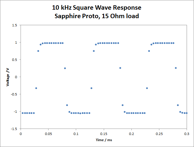

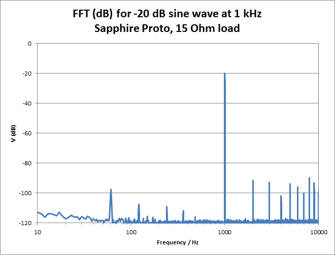

A couple more, last for today. The -20 dB sine wave is clean but for the artifacts from the function generator and a little bit of hum. The 10 khz 1 V square pulse is looks good.
00940: 0.0001 or .01%, sorry I neglected to multiply by 100 when typing the % sign in there.
Thanks for keeping me honest. I appreciate it.

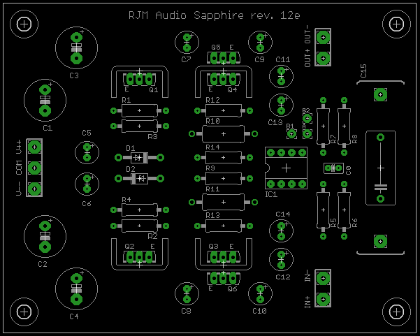

So here's a preview showing where I'm headed with the next board layout.
1. Small heatsinks, and driver and output transistors share a heatsink to stay thermally coupled. This is what I meant earlier by "thermal feedback" and it keeps the output transistors running at bias currents close to those of the driver transistors.
2. Tidied up the A-B1-B2 feedback jumper pads. R14 is now inside the buffer feedback connection, for trace layout reasons. When using the A-B2 connection, R14 should be reduced to zero or 1-2 ohms.
3. C0 is included as an optional bypass of C6.
