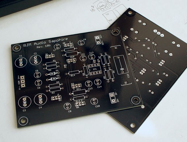

Boards!
Everything looks OK. Not a lot of clearance around the transistors for heatsinks however, I shall have to look into that for later revisions.
This is the first time I've used thermal isolation for the poly fills. Seems to have worked out.
Boards are 100x160 mm, and two are needed for stereo. That's 200x160 in real estate right there, plus another 200x100 for the transformers and diodes and another 200x5 or more for the connections. So about 200x265 is the minimum case dimensions, unless you use an external power supply.

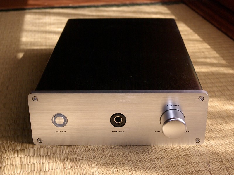

The case arrived, by EMS, just a couple of days after I bought it. All I need add are the RCA jacks, volume attenuator, and a fuse for the included fuse holder. More importantly the only machining I'm left with is 8x 3 mm clearance holes for the boards and 6x 4 mm clearance holes for the transformers and diodes.
As you might guess, I love circuit design, and don't mind building the electronics either, but power tools are just not my thing...
I have everything now but the Mouser parts, which due to a single resistor being out of stock is delayed until April 12th.

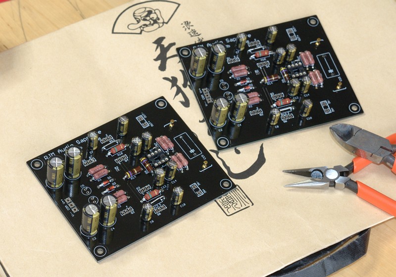

I did some soldering this morning.
This is prototype A. It's set with the buffer outside the current loop, currently with R12,13 at 0 ohms, and omitting C5,6 (the RC filter between the Zener reference and the base of Q1,2).
Soldering was a bit of a pain: even with thermal isolation the pads into the poly fills never seem to want to heat up properly.
Now I'm off to try and match some transistors...

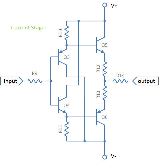

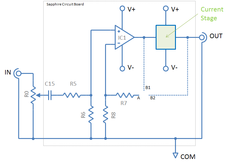

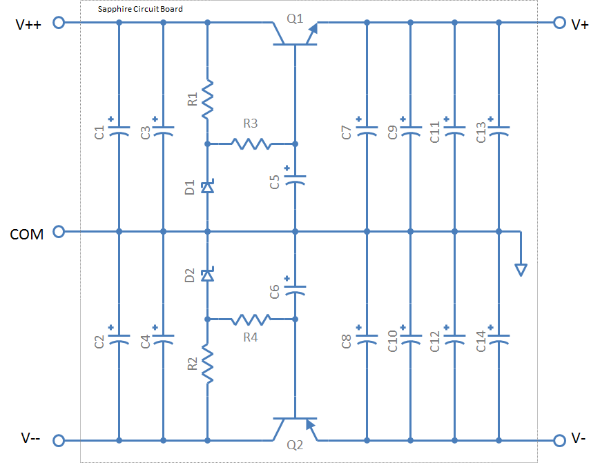

Circuit Schematics
The Zener-based regulator block is lifted from the Pioneer C-21 Preamplifier.
The current stage is a descrete version of the LH0002 IC.
The voltage stage is a generic noninverting op amp amplifier, with a couple of nods to the Bryston BP4.

Finished soldering the boards. A few things cropped up while putting everything together, and the BOM has been revised accordingly. Next step it to power things up on the benchtop and see if they can pass a signal.

I connected one channel to a power supply and made some DC measurements.
Games and theory are all well and good, but there is no substitute for direct experiments.
So, there are a number of problems, so many that I am going to have to retreat and regroup in order to think of about how to proceed.
The board powered up and did not explode. All DC measurements are as expected, i.e. there are no errors in the circuit, layout, or my soldering and connections.
Problem 1. My 62060 Amveco toroid turned out to be a 62062, i.e. 12 VAC secondaries rather than 7 VAC. Oops. Buy more transformers, replace components on the board, or stuff another board. Since the circuit is working, however, I propose to do as much testing as I can on it as-is before proceeding.
Problem 2. Op amp stage is borderline unstable, runs 60 mV hum on the output with the inputs open, much reduced if the inputs are shorted. Probably solved by a capacitor across R7, with have to look at it in detail later.
Problem 3. Voltage drop across R3,4 is 0.3 V, which drops the V+ down to about 4.7 V for a 5.6V Zener. Starting to think this is not ideal since op amps like the OPA27 don't like to have their output voltage much closer than 2-3 V from the voltage rails. R3,4 should be reduced slightly, and higher transformer secondaries and higher V+ a good idea. Rather than having 6 and 12 VAC versions, 9 VAC seems optimal.
Problem 4. The value of R12,13 ... 1 Ohm kills the output current, 0 Ohms probably makes the circuit thermally unstable. Somewhere there is an ideal value but it is going to take some trial and error, and I don't even have testing method in mind.
Problem 5. This isn't actually a problem, but running the prototype at much higher supply voltages than intended meant that Q1 and Q2 dissipated about 0.8 W of heat, but I discovered that the packages only get very warm, rather than burning hot. 0.4 W is perfectly OK, so it makes sense to raise the bias currents a little to take advantage of this. i.e. I was being overly conservative in my power budget.
So while it's not quite back to the drawing board there are a number of steps to go through now, one at a time, before I even get to the stage of being able to give it a listen.
