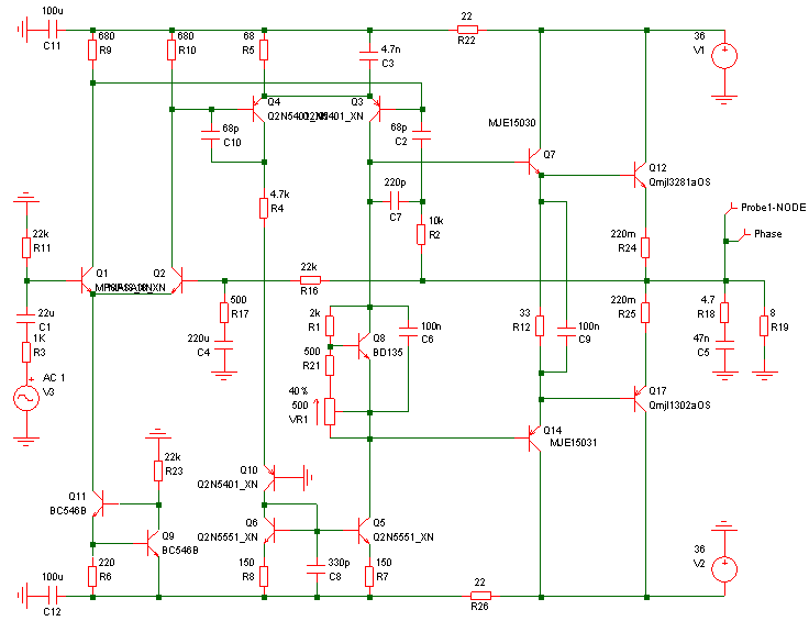

Hi Keane,
If you don't mind, above circuit (in its present form) hurts my eyes:
What are the two 47k resistors to gnd doing there?
E.
Edmond, these resistors can be used to increase open loop bandwidth alot. Open loop gaan wil be decreased by these also what makes the freq compensation easier.
If you know other options to reduce the VAS gain, I am very interested.

Edmond, the image is a thumbnail, if you click on it it will zoom out. I wish the forums had a better image resizing algorithm.
Guys, chill out. I was using Symasym as an example. I know about the 47k resistors, PSRR and all that jazz. Let's not get myopically critical here.
And no, the 100p cap is not just doing nothing. It is a critical part of the stability compensation. It is equivalent to shunt compensation.
Please Edmond, check out the 100p cap, it is not just there for looks, it responds to the voltage at the current mirror input (the frontend rail filters fix PSRR), which itself responds to the current loading of the output stage. The 330pF caps augment this response with voltage loading to make it stable at HF. The result of this compensation is a 2nd-order capacitive input stage loading, like two-pole compensation.
MikeB was very clever, but he didn't design his amps for the lowest numbers, and it seemed people just did not want to understand him. I think it's strange how no one recognizes the Symasym compensation scheme.
To disambiguate, I am just trying to discuss compensation schemes and their performance, I am not interestested in the "sound" right now, and if I was I would discuss it in another thread.
The 47k resistors are inconsequential, they do not affect the concept of the compensation scheme. Let's get on track.

Hi Ben,
You are perfectly right, one can 'increase' the open loop bandwidth (defined by the -3dB corner frequency) by those stupid resistors, but nothing is gained by this utter nonsense (sorry for my harsh words).
Sure, a short circuit to ground, very effective!
@JCX: Thanks for your explanation.
@Keane: Don't worry, I do know it was just an example and I do like to discuss with you the possibilities of TSC.
PS: Symasym 4, i.e. 330pF + 100R, makes more sense to me.
E.

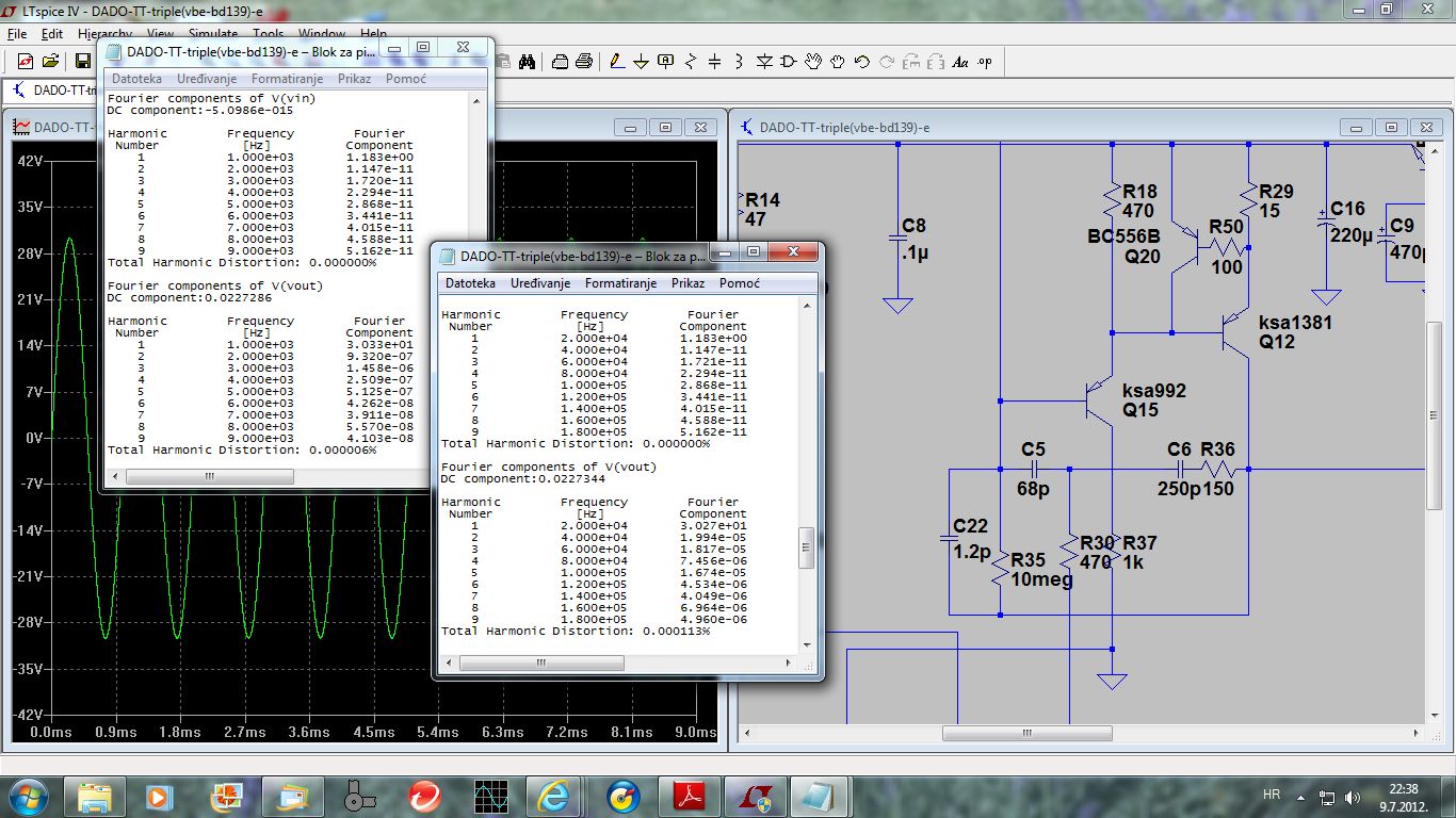

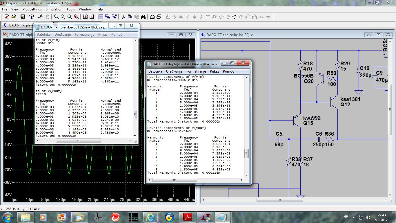

Hi Keane ,
I have to admit that I completely overlooked the subtle but essential interaction between the degen. resistors of the CM and compensation capacitors. Indeed, very clever. Probably, I was too distracted by the 47k resistors to recognize the importance of this subtlety.
In the mean time I've simmed the circuit, which confirmed the importance of the degen. resistors. If zero, the 100pF cap has virtual no effect and the amp becomes far less stable.
I also simmed the TSC compensation, but the reduction in distortion wasn't spectacular, most likely because the compensation was already of the 2nd order. This leaves little room for further improvements.

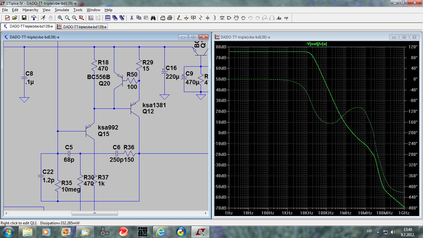

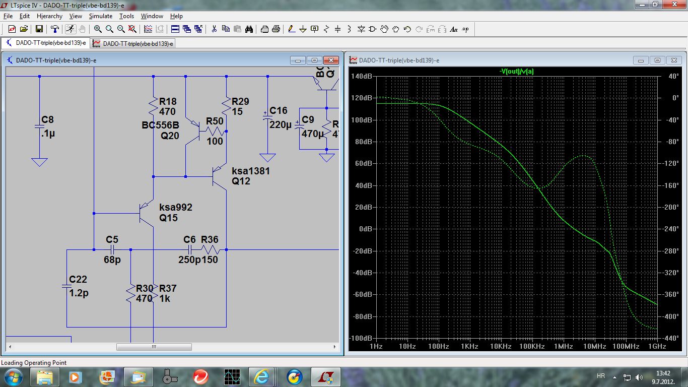

Here are three simulations:
1.TMC pure
2.TMC with feedback resistor and bridged with small capacitor
3.TMC bridged with small capacitor
In the case of pure TMC phase drops to 177 deg. and bridged to 165 deg. I think that this gives better stability.
dado

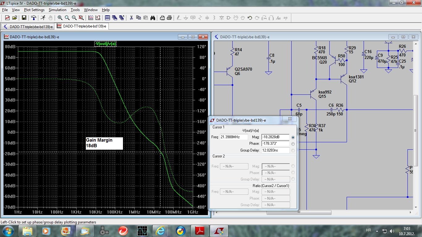

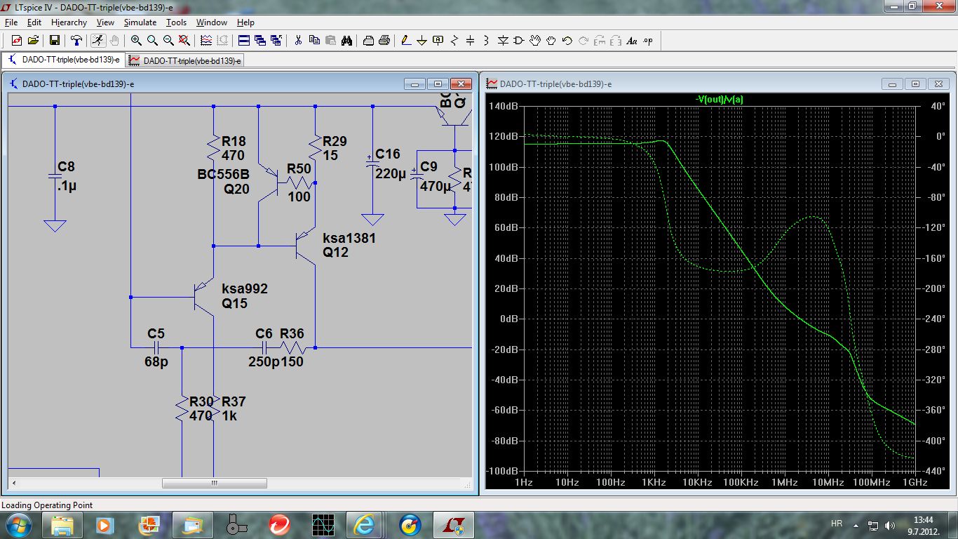

In these discussions of comparative stability it is easier if plots have the 0 dB line as also the 0 phase margin.
Is there a convenient way to force this in LTSpice?
David
Something like this?
dado
