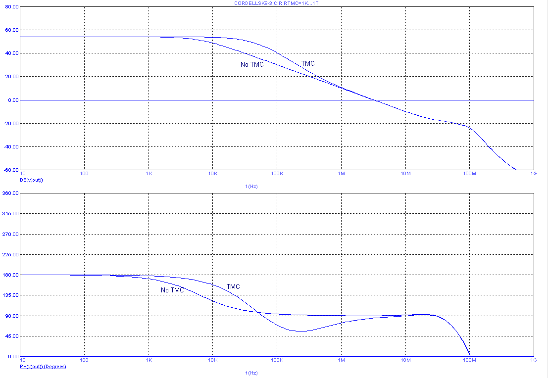

As you know, there ain't no free lunch, though looking at the graphs below, I don't think stability isn't much impaired. At ULFG, 3MHz, the PM of the FB loop is only a few degrees lower (1st pic.). The closed loop response (of the OPS, thus not the whole amp) shows hardly any difference (2nd pic.)
THD20k improvement is about 10dB.

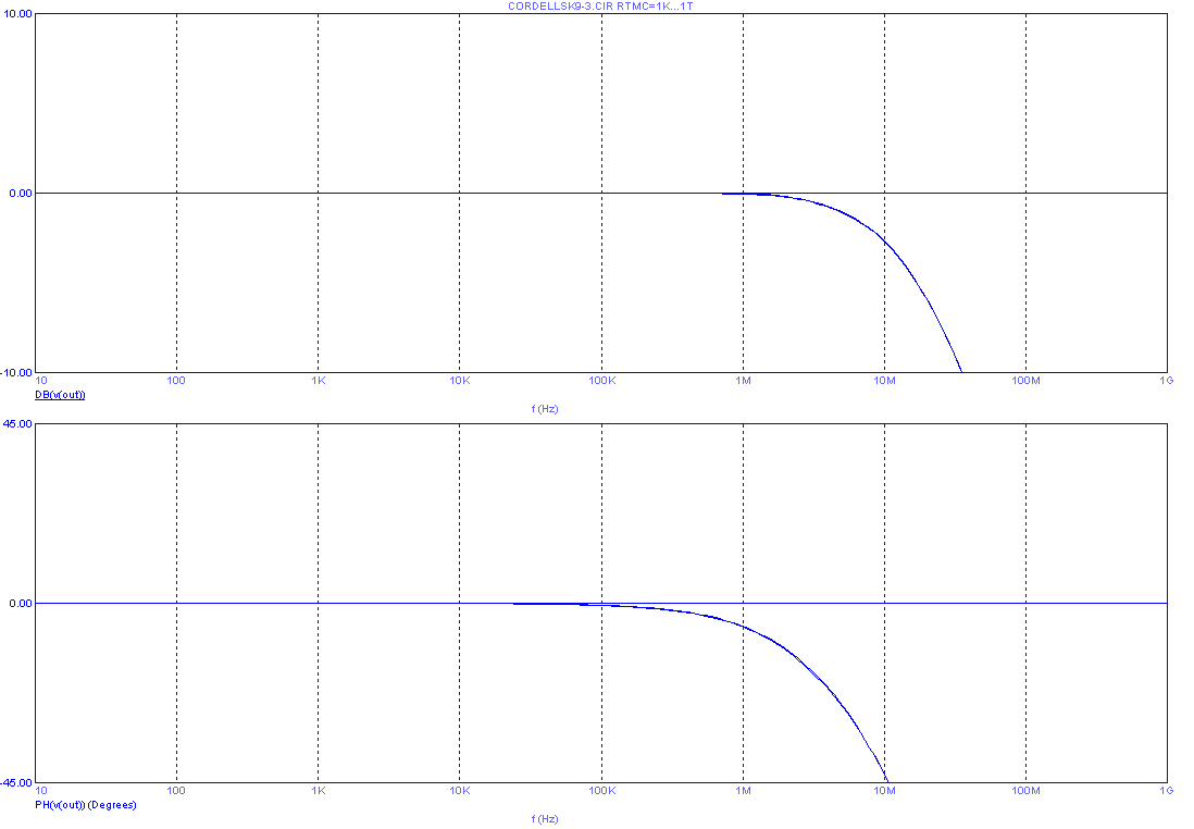

Thank you. I didn't think before I posted.What you see there is the local loop gain of the Miller compensation

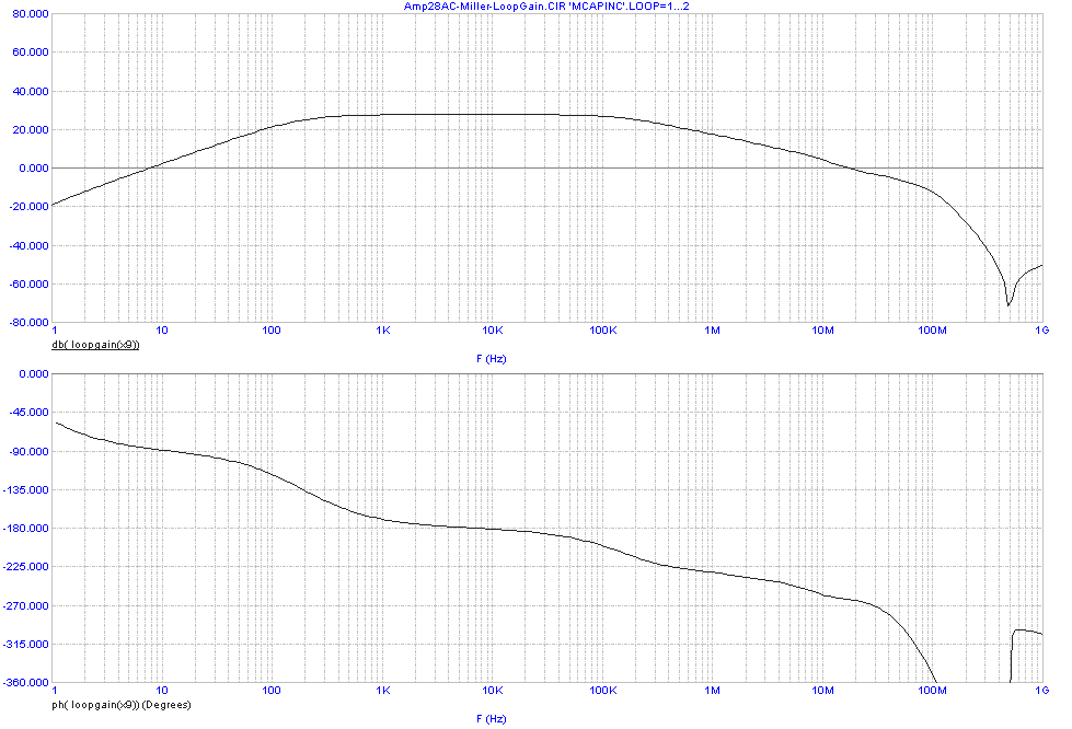

What I see in Fig. 6 is actually the loop that includes the local Miller compensation via C16/C17 plus the feedback via the TMC resistor R33 (To use Fig. 6 identifiers because the thumbnail is a bit cropped))
I am curious about the loop response of just the local Miller compensation.
That would be between the junction of C22 and C23 and R28 on Fig. 12.
Could you show the loop gain for that?
Of course, see blow. As you see, the max. gain is a bit limited. This is one of the reasons I reverted to the original compensation according to fig.6, though with slightly larger capacitors. The other reason is that this scheme performs clearly better (THD wise). I thought that the simpler compensation was just as good, but it appeared that I was fooled by one of the simulations. BTW, I've dubbed the 2nd order shunt compensation (C12...C15, R26...R28) Transitional Shunt Compensation or TSC.
