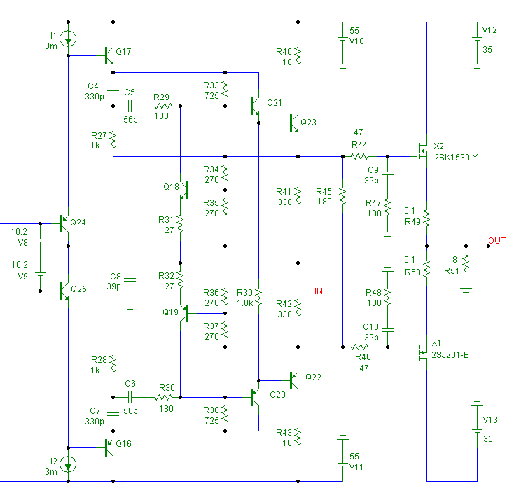

By the way Bob, did you consider the possibility to apply TMC to the frequency compensation of your HEC-OPS as well? Combined with a low distortion front-end, also equipped with TMC, my sims indicate that you can break the 1ppm barrier with this arrangement.
See below how I've done it. Also notice that an extra EF stage is needed (Q24 & Q25, to unload the front-end) and R33 & R38 are increased (i.e. optimized) from 680 to 725 ohms. As for the latter, now it pays off to do this, as the bandwidth of the HEC FB loop has been increased, (around 250kHz, while the ULGF has been kept unchanged: 3MHz).

Hi Edmond,
No, I've never thought of this. Looks like a clever idea!
I wonder how stable it would be in the real world.
BTW, my original MOSFET power amplifier with EC used only one pair of MOSFETs with only 150mA of bias and no source resistors for distortion optimization (as described in Chapter 11 of my book). If we go to 3 pair each biased at 200mA and with optimized source resistors, we can probably do a lot better than my original amp.
Of course, it will run a little warm, but will also have a very generous class A region extending to output current of 1.2A. With +/- 50V rails, this amp will dissipate about 60 watts in the output stage.
