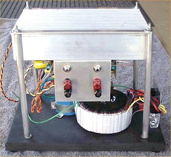

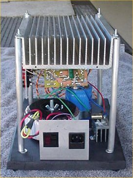

Attached is a photo of the Half Nelson piglet. Those who attended Burning Amp might have noticed it slouching on one of the side tables. The unusual manner of packaging was a matter of expedience, as I didn't have time to wrap any sheet metal around it before the big do. However, with a little tarting up, this kind of open packaging could be made to look pretty nice. Possible combinations: black anodized heatsink, input/power panels and toroid cover with oak base, or gold anodize with black piano finish base. If I can get the thing to perform to my satisfaction, maybe I'll get it some dress clothes

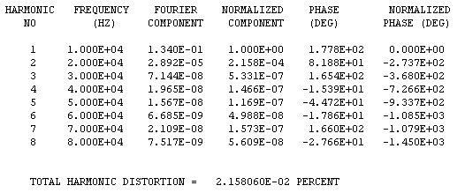

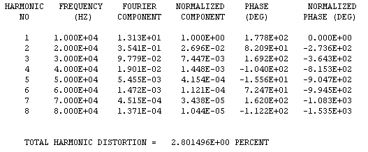

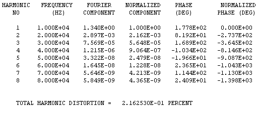

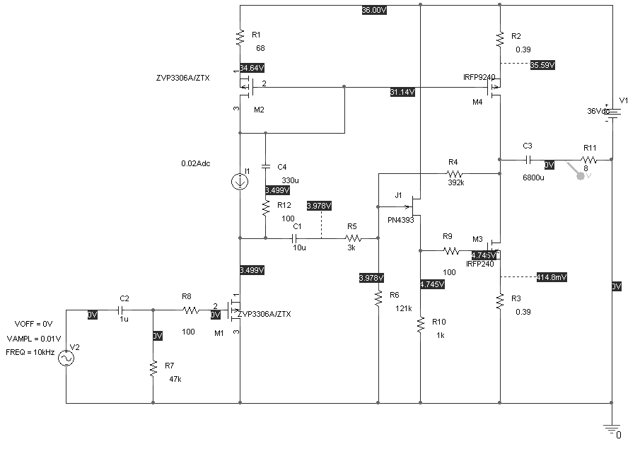

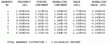

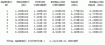

For amusement and edification, I ran a set of simulations on the amp after tweaking the centering resistor values for higher impedance and gain. The JFET buffering allows the use of large values for centering resisors without affecting the bandwidth substantially. The first picture shows the altered schematic with quiescent bias values. Bias resistors were changed to reflect the on threshold voltages of the parts in the library. Gain is around 13X with the new values.

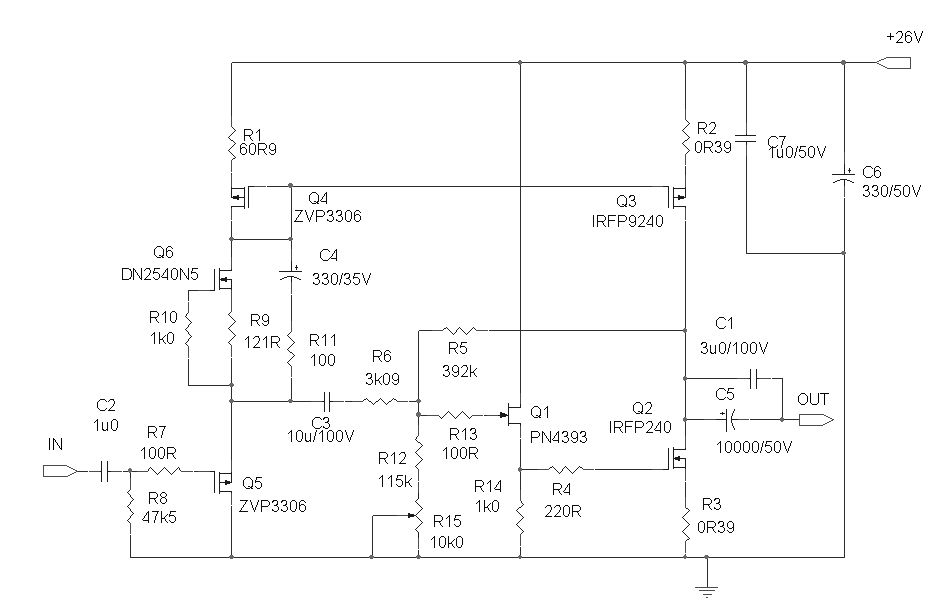

This is the schematic of the current version of the Half Nelson that played at BA 2010. The original LM317 current source is replaced with a Supertex depletion mode fet (less problematic operation, higher impedance). The gain/bias resistors were changed from 47k, 1.5k and 10 k to 392k, 3.09k, and 115k. The pot is used to center the output at ~1/2 VCC. The ouput coupling capacitor was changed from 6800uF to 10000uF. I'll explain the circuit operation in another post - try to work it out for yourself in the mean time.

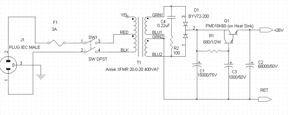

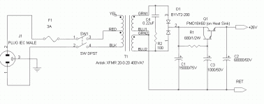

Here's the schematic for the power supply I'm currently using, thrown together out of items that were on hand. The electrolytic caps could obviously be 35V units for some space savings. Others might want to use an appropriate schottky rectifier (100V units would do it, 60V is cutting it too close) instead of the old Philips ultrafast dual rectifier that happened to be sitting in my parts bin. The RC snubber sitting across the rectifier was an old Rifa integrated RC snubber I had laying around - discrete parts would do just as well. The transformer in an old-style Antek toroid with tapped primary and dual secondaries, probably ~400 VA - again, something I had lying around. 400VA is overkill, as the amp only draws 2A from the supply. The darlington used in the capacitance multplier is an old Llambda TO-3 package device that was at hand - it fit nicely on a pre-drilled bracket and socket I already had prepared. A TO3-P package device like a TIP141 or TIP142 would no doubt work just as well. The darlington is mounted to the same heat sink as the amplifier output devices.
