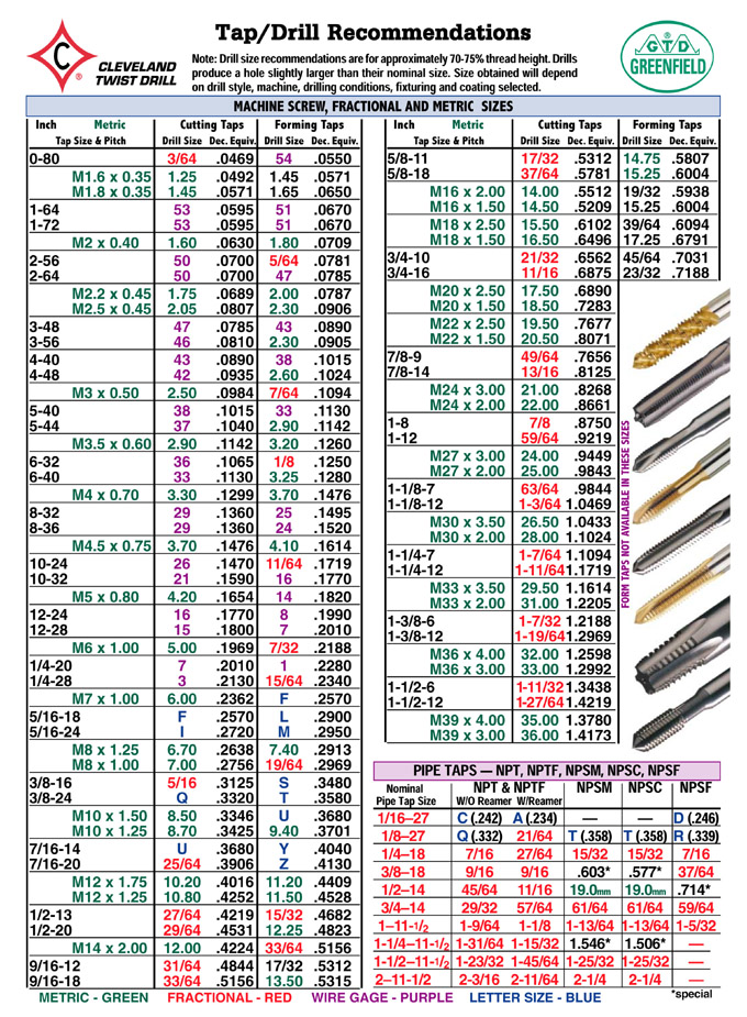

NO !up to 8mm there is a rule - multiply screw metric value by 0.8 and you have drill size
so , for 3mm that would be 2.4mm
anyway , web search is always there , so no need to remember
Look at the tap and read off the thread diameter and the thread pitch. A 3mm tap will usually be marked 3 * 0.5, indicating 0.5mm thread pitch.
Subtract the thread pitch from the thread diameter. 3 - 0.5 = 2.5mm diamter pilot hole.
This gives a "full engagement" thread.
If one requires less thread engagement then select a slightly bigger diameter for the pilot hole, i.e. 2.55mm or 2.6mm, not a smaller diameter as you have stated.
Very hard metal generally work with less thread engagement.
Aluminium and other "soft" metals generally work with full thread engagement.
Using too small a pilot hole can result in a broken tap !!!!!

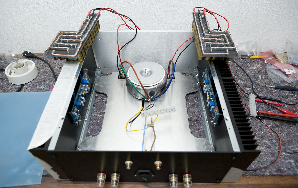

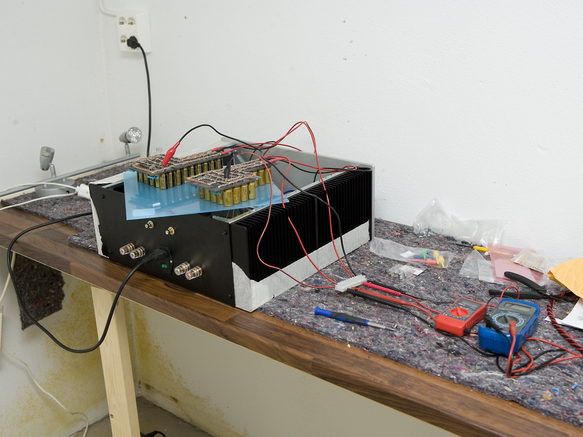

Ran into a problem:
Removed amp and hooked it up to source (CD through receiver,RCA)
It played music fine and while gradually increasing volume at around 80% a light click was heard from the speakers and there from and out an a dominant hum was heard.
Amp did not leak magic smoke, no odour nor visual clues of defect. With no signal in hum still present.
Amp disconnected and placed back on build board.

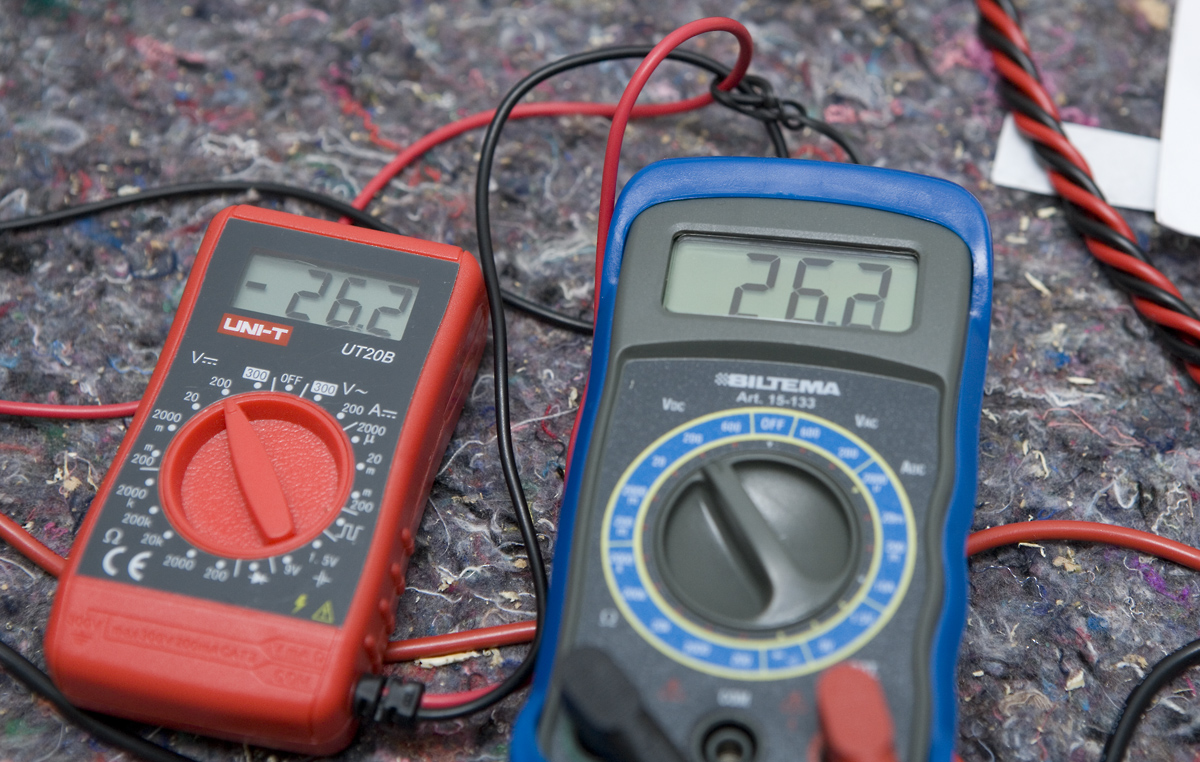

PSU supply normal voltage, bias read zero and offset is 23,3V on both sides.
No visual sign of defects on caps, no heat there.
Bad caps ? Anything else likely to have blown?
Heat sink temp was up about 25degC from ambient with bias set to 600mV, all stable.
Ran into a problem:

Since both channels show similar offset indicate :
Failure somewhere before the boards (PSU/ground) or after the boards (speakers/ground)
Both speakers operate as usual connected to the old amp so they are fine. Speakers are 6,4ohm nominal btw with EQ boosted signal (6dB lift at bottom end and similar lift on high end)
The failure in my mind can not be a single component on one of the F5 boards.
I will tear down the amp into its seperate modules and measure my way up again.
