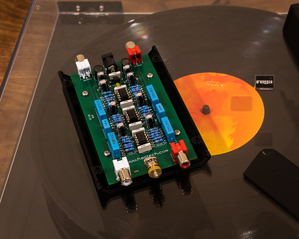

I was itching to try to make something and I saw this thread so I ordered up all the stuff. It was super easy to get everything and I spent a few hours over weekend making it.
My skill level is amateurish at best so it was a good one to try out before I did something more serious. When I first hooked it up it had something wrong in the right channel. After closely inspecting each of my not so very professional solder jobs I found one where the lead (is that what it is called?) wasn't trimmed down enough and it was bent and touching another solder point. I was able to trim that off and hook it back up and boom! It works great.
I have only used it for a few hours and I don't have enough experience listening to vinyl in general to say how it sounds or how it compares. I don't have any ground issues at all. My previous Rega Fono A2D had a ground loop issue that requires some monkeying around but this one works fine for some reason.
Overall I'm real happy and maybe I'll sell off my current phono and buy a new cartridge or something.....
Here is a picture
