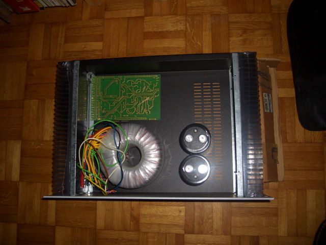

P.S.: I'm building a new Hafler with two boards that I have made the layout. Gold plated traces, six mosfets per channel (2SK1058-2SJ162). I'm going to regulate the voltage for the "signal" side (I have two additionals windings on the transformer), and I would like to use fast (or soft) recovery diodes in the power supply. I'll post more pictures and results as soon as they are available.
