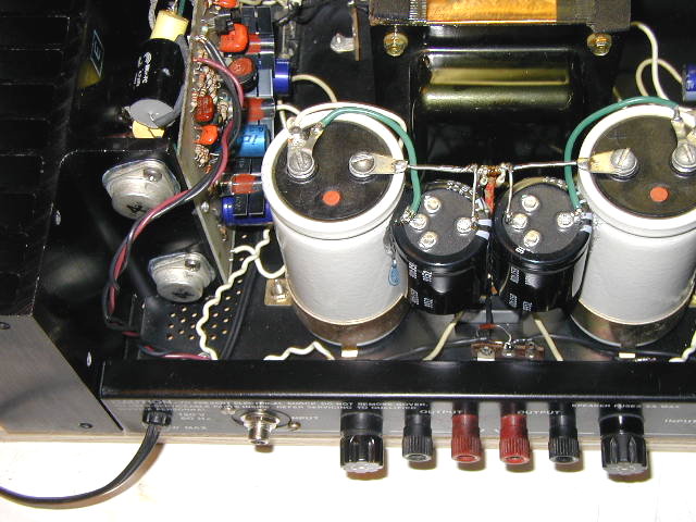

As silly as that sounds, capacitors (for example) that are too large end up ripping the pads and traces as they break free. Also consider that a large capacitor will pick up more noise as it gets larger in size. You might even create and oscillation problem.
-Chris
Use parts that fit, or can be secured to the PCB.Could the group recommend a starting point or am I trying to put too fine of an edge on this?
-Chris
Hi anatech,
Thanks for the advice, you are correct, there is not a lot of physical room to fit this cap in and the space available at the pad locations is not tremendous either - one of the reasons I was not looking forward to a lot of swapping of parts for experimentation.
From some of the pics I've looked at (one attached from Dick West I believe), it looks like behind the board (between the board and the heatsink) appears to be the best spot. Perhaps hot glue or silicone to secure the cap?
I should not be so fussed about shooting for a specific value then? Go for best fit then with a value somewhere in the middle?
I believe the original design cap was a 10mfd 16V NP

Input caps
Hi ddanbo, have you considered using a stacked metallised film cap by EPCOS
these are very small caps of very low inductance.. as an example a 4.7 uf is only
9mm W 11mm H 9.8mm D with lead spacing 7.5 and is rated at 63v, these are easily
mounted on the edge of the Hafler board by drilling lead size holes and hard wiring
I am looking at the RS catalogue part number 191-3373 this is the largest size in this
series.. next question, how good? well NAIM used these as the timing caps around
their 1541 DAC, and were just as good as highly selected polypropylenes used in updated Marantz and Philips top of the range CD players precisely because of their very low inductance, in fact I have used block film caps in some of my xover designs
because the square configuration [blocks] give rise to lower inductance figures,
whereas those SOLENS are round bulky beasts and are not in my opinion all that they are cracked up to be, unless you go for the very best foils, as opposed to metalized film. Anatech is right to express caution with these larger caps too near the
O/P Mosfets as instability can result etc .

Thanks for the replies!
I was able to mount a 3.9 mfd solen PA series to the back of the board similar to the pic in my previous post. The cap seems sturdy enough (cap is quite light) and the lead holes did not need to be enlarged.
The soudstage has definetly opened up and overall sounds good - then again I have less than 8 hours on it so far.
