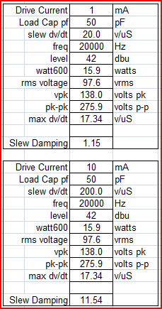

That's a good point. A gyrator load is probably among the lowest
capacitance loads but still finite. A MOSFET would be Crss through the
gate for the most part, with Ciss and Coss bootstrapped. FQP1N60
is 4pF Crss
The 801A has 6pf Cg-p and in-circuit gain af about 6 (=36pf Cmiller)
+ 4.5pF Cg-k
If I run 1mA and 50pf through my slew calculator I get 20V/uS or
about 100V max rms 20KHz sine wave. I would feel more comfortable
with a little more "slew damping" factor i.e. excess drive current. I
would probably design the driver here for about 100-200V/uS which
would probably require 10 or 12mA idle current.
Michael

Michael Koster said:If I run 1mA and 50pf through my slew calculator I get 20V/uS or

If the voltage swing is only 25Vrms instead of 100Vrms, the current
needed will be proportinately lower. My last breadboard was class A2
and used 100Vrms grid drive. I used 10mA on the 417A. So I guess I
was giving you my context. The VT-25 output stage in class A1 will
probably be around 20-30Vrms as you suggest.
Something to keep in mind, in the slew calculator example above
we're asking the tube to actually deliver 1mA of signal current at
20V/uS. If it's going to do this in a linear way with small phase shift
etc. then 1mA should be a relatively small impact on the load line,
implying relatively low Ri tube and op point, and relatively larger
standing current vs. signal current. That's the point in having a
"slew damping factor" which is the ratio of deliverable to required
current for a particular maximum slew rate.

PS I saw slew limiting in the output transformer signal in the A2 amp
> 20 KHz at about 2X the design power of the OPT into a resistive
load. This is probably not a problem, but I think it's something to
watch out for with high impedance output tubes.
Michael Koster said:PS I saw slew limiting in the output transformer signal in the A2 amp
What does this look like? I made some transformers that gave nice HF performance in my 801 Loftin White amp, but were limited in the LF region. I was using it in a multi amp system at the time, so designed the transformer for that. But I wanted to use it as a headphone amp and possible other full range duty, so I ordered some nice transformers at considerable cost. I was surprised that I got obvious waveform distortion at full power starting somewhere above 10kHz. If I backed off the power the distortion went away. I assume this is sort of effect would be slew limiting by the transformer? I was disappointed to see this, but I can't say I actually hear it. But then I don't hear over 10K anyway.
Hmm, what limits the slew rate for the transformer. Inter winding capacitance? I don't normally see this effect, just the usual roll off at the upper limit.
Sheldon
