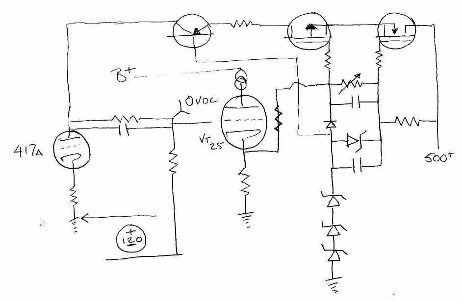

A first, I would need some negative voltage supply with tiny current requirements, like 1 mA would be enough, so a parametric regulator with one 120V Zener will work fine. You may use some VR tube here, it looks nice indicating power-on as well.
Next, I would make a voltage divider from anode of the driver to that negative rail, so DC in the point between resistors would be zero, to drive the grid of the output stage. Then I would shunt the upper resistor of the divider by existing coupling cap. Now, I would disconnect that resistor in SVCS that goes to anode and senses anode voltage connecting it to the cathode of the output tube. However, it's value would be recalculated for a different voltage.
PS: thanks Ilimzn for the info! :)
Joined 2008
Hi Wavebourn, Is this what you mean?

Hearinspace said:
I'll try the MosFet in the cathode of the 417 as well as the IR LED (thanks ilimzn!) but I have a question about how generally to choose the part for this use . I don't see what on the data sheet for the 2N7000 indicates it will be good for 12mA @ 2.5VDC (I just grabbed this Grid Voltage from the 417 sheet, not sure if it's accurate in your circuit or not.) A friend told be it would be IDSS but looking at the sheet it doesn't seem to apply with VGD=0vdc. The only thing that looks like it could be it is the "Ohmic Region" chart at the top of page three of the data sheet . Can somebody tell me what to look for?
The "Transfer Characteristics" chart to the right of the Ohmic region chart is a good first approximation. Looing at the graph, one would expect temperature sensitivity and drift but I find the circuit is much more stable than I would have guessed. It is about 2.5 -2.6 volts at 10-12 mA. The dynamic resistance is about 10 ohms at this current, similar to an LED.

Wavebourn said:
But this is still cap coupled isn't it?
. . . . .Ahhh, what do I know. I'll still try it.
I'll play around with the present SVCS and the cathode loads for a week or so and then try the direct coupled version. Thanks Wavebourn !
