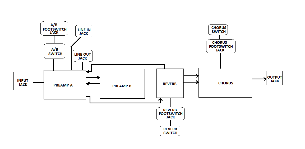

Here is a chart of the overall build:
The line in / line out jacks can be used for an external effects pedal. The original has one 3 conductor jack for a 2 switch footswitch to control A/B channel selection and reverb on/off, but I have separated these, at least at the board level. They can be 2 individual 2 conductor jacks or 1 three conductor jack.
It's tricky to keep track of all of this but I have a better grip on it now. As I break up the original circuit into blocks, I gain a better understanding of how they work.

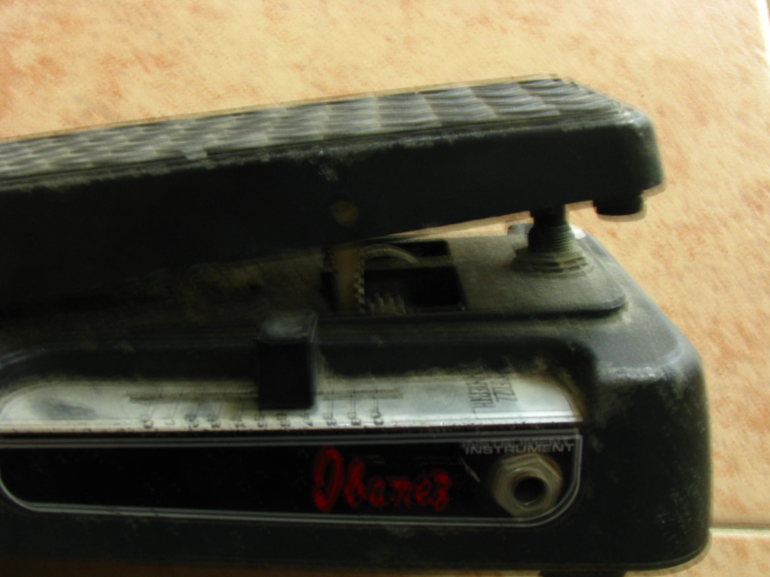

Hi AndrewT, happy new year
Is an interesting idea, most commercial amplifiers possess a footswitch to turn reverb on or off, but that alone, is an all or nothing situation.
With some minor modifications, it can control the level of reverb through a pedal like the ones used for wha-wha, with a pot inside.

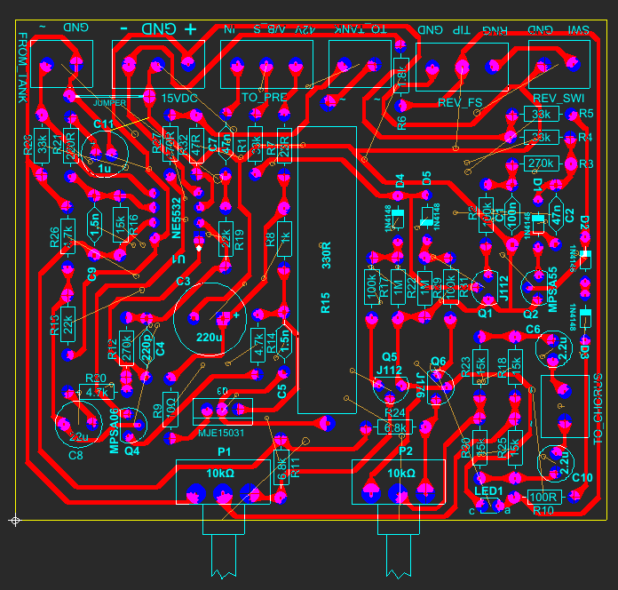

Reverb board is laid out:
ready to etch. It came out to be about half the size of the preamp boards at 10cm x 8.5cm. This time, I double checked the pinout on ALL of the transistors
As I'm out of good transfer paper ATM, I will be using the old standby - magazine paper. I don't have a critical top layer on this, where traces need to exactly line up so the mag paper will probably do ok.
I should have triple checked.
One j176 with the drain and gate reversed this time. A couple of other minor mistakes and once they were fixed, I have a fully functional reverb:
It works exactly as it should and the level of reverb can be set independently for either channel
I ran the recorded guitar through it and it sounded great. I connected my function generator and wow, freaky sound effects! Manually sweeping the frequency up and down makes this wild eerie sound.
Anyway, it works. I need to fix the mistakes on the layout and make a new board but that can wait (at least until I have some decent transfer paper).

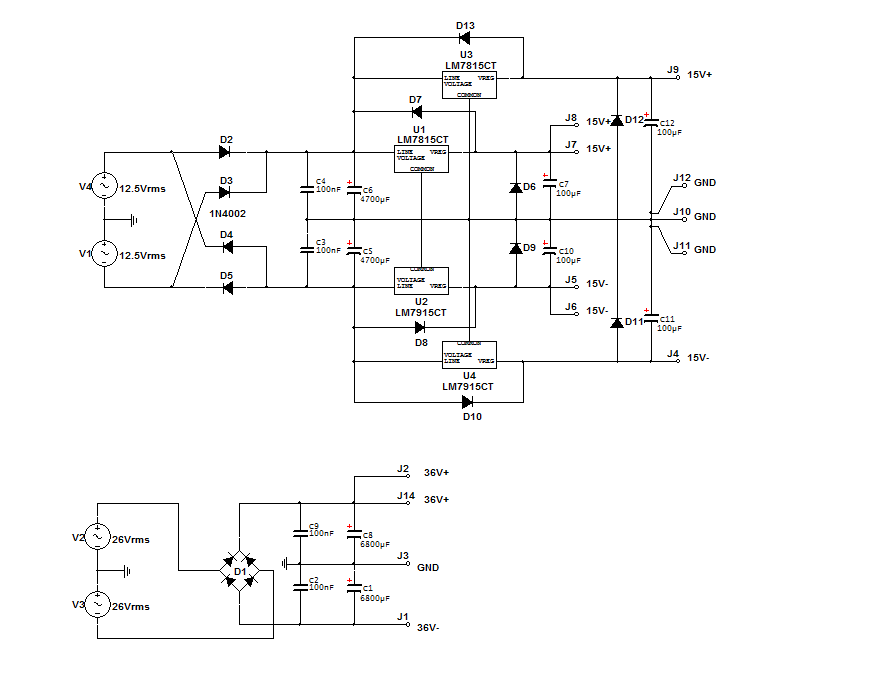

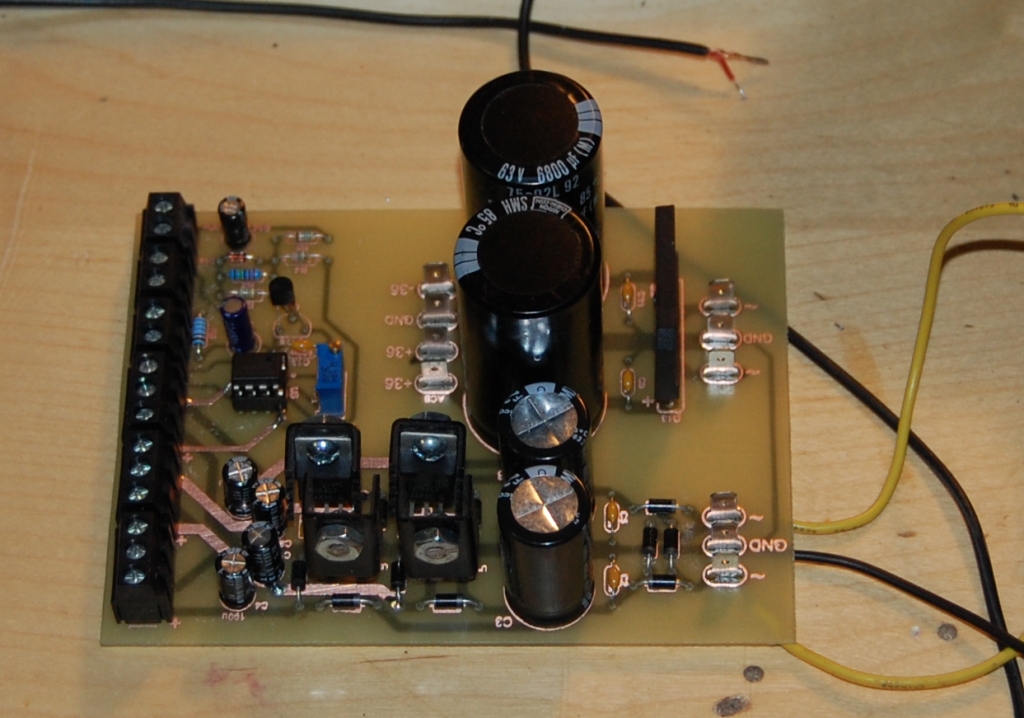

Power supply:
Pretty basic. I had a look through my stock of transformers and the most suitable one for the power amp is a 26.5-0-26.5. It is probably somewhere around 300VA, so it has enough oomph to drive the amp into a 4 ohm load.
The regulated 15V supply uses 4 regulators. I found that the preamps (with the support circuitry) are pulling enough current to heat up the single regulators. Probably overkill but I prefer to be safe and not have to do THIS over again.
The transformer for the 15V supply is a 12.6-0-12.6 @ 2A Radio Shack unit. I have 2 of these that have been kicking around for the past few years and haven't found a permanent use for. Again, a bit overkill but I use what I have.

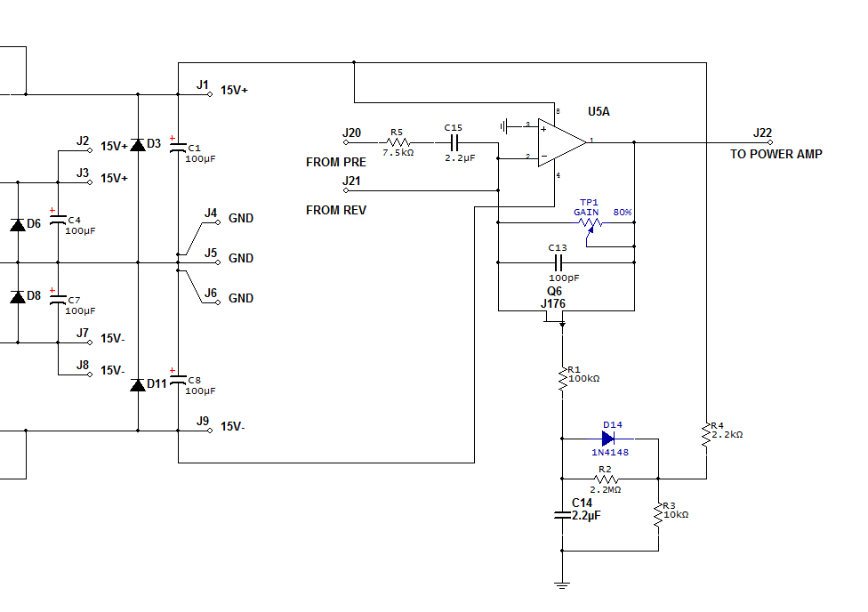

Also on the power supply board is the output buffer:
It combines the preamp signal and the reverb signal and adds some final gain before the power amp.
I have made the gain adjustable with a 100k trimpot and there is a few seconds before Q6 opens, via the RC made up of R2 and C14. This should give ample time for the power supply caps to charge up and the preamps and reverb to settle before there is any output. R3 drains C14 quickly when the power drops.

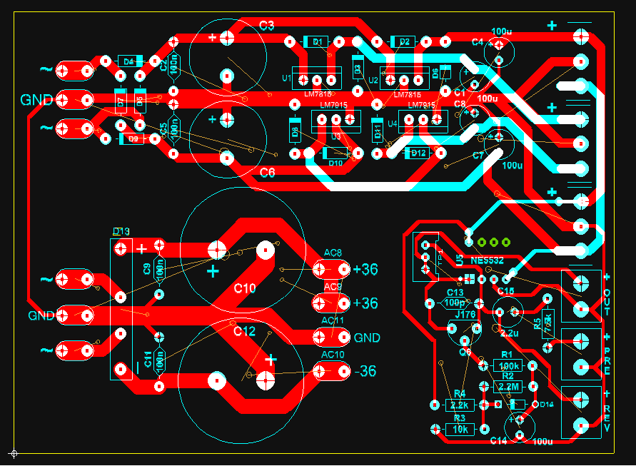

I couldn't get to sleep last night so I made use of my insomnia to etch and stuff the power supply board:
Tests a-ok except one LM7815 is putting out more than 17V. I caulk this up to it being recycled from an earlier project. I'll pull and replace and see if that fixes the problem.
Everything else looks good. The output buffer works as it should, turning 'on' after about 3 seconds.

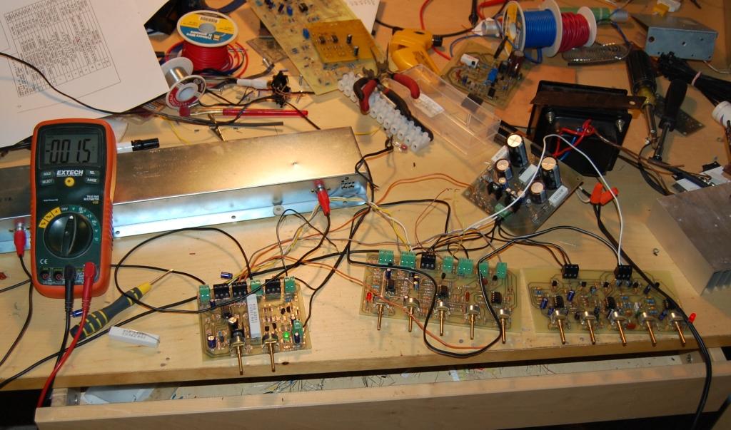

Nothing left to do now until I get the mounting bracket made. Then I can install the boards, the power supply, the power amp and wire it all up.

I think I now have a good base for external expansion (if desired). The preamps are excellent and the reverb seems to be quite good. Getting the project all buttoned up, with a real guitar plugged in and in the hands of someone who can wield it (not me, yet) will be the final verdict.
