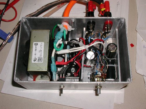

While waiting for the PCB's
Don't try this at home. I've been reading and collecting parts to make a chip amp and after trying to do it part to part and breaking a pin to 2 on my first try i decided to order pcb's. But since i had the parts this is what i got to fit into this little case. It work great except for a slight buzz in the transformer. Output is very quiet. Plan to use it in my garage. Used all carbon composite in PeterD's G2 design. 50K dual gain. 20-0-20 transformer 2 rectifiers. It barely fits and is a mess of wires. The PCB's should make my next one alot cleaner.
