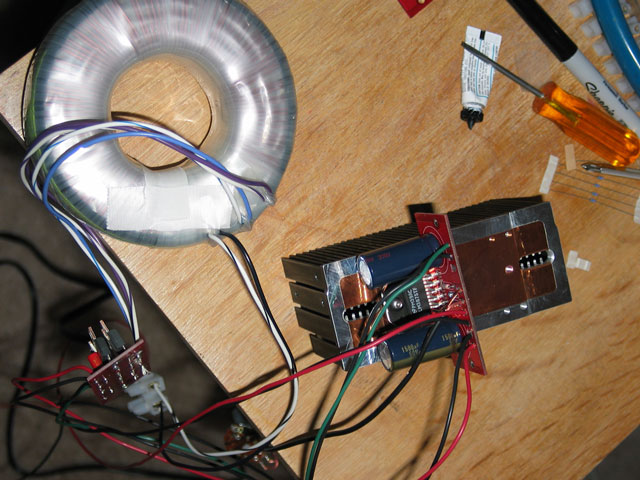

I got my kit from Brian yesterday. Decided today to actually attempt to build at least one channel. Went out to round up miscellaneous wire and parts (had to go to 2 Radio Shacks, they have nothing anymore!) and left HomeDepot (had to get tap to attach chip to old Athlon heatsink) at 4pm.
I had music by 6pm!
This kit is the best! We all owe Brian a ton of thanks for making this so easy.
Thanks again Brian!
Since this actually worked for me, I'm going to throw together the other channel and do some real listening. I used a spare NHT SB2 that I didn't use yet for the living room "home theater" system. It sounds great by itself. Soon I will try both channels on my B&W Nautilus 805s.
David

Yep, a Victoria Magnetics 2x14 150VA that I had for a project that I never started.
I think I paid $60 for that copper cored Alpha heatsink back when I thought I was cool for overclocking CPUs. Then I realized for what I was paying for special parts to get them to run semi-stable at a higher speed, I could just buy the faster CPU. YMMV.
David

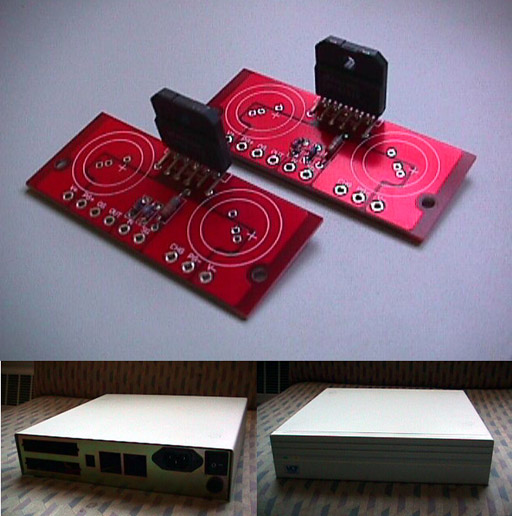

ok, so i've got everything soldered except the caps (still gotta order them up). so here's what i got so far. i'm going to try to cram 2 channels (with the PS in something bigger) into this old case i salvaged from an old external scsi harddrive. i'm gonna try to use some pentium heatsinks (looks like they'll just about fit. paint it up a bit, maybe smooth out the face with some bondo, and deffinately keep the led's. so i guess i got a bit of a head start.....:D

I bought an old instrumentation device to use its enclosure to stuff everything in. I'm a little concerned that the chips may end up being too close to the transformer, they'll be a couple of inches away, maybe less. We'll see how things turn out. If it's too noisy, I'll just find another case. For $16 I got a nice case, power switch, LED(s), IEC connector, and fuse holder. Can't complain :)
