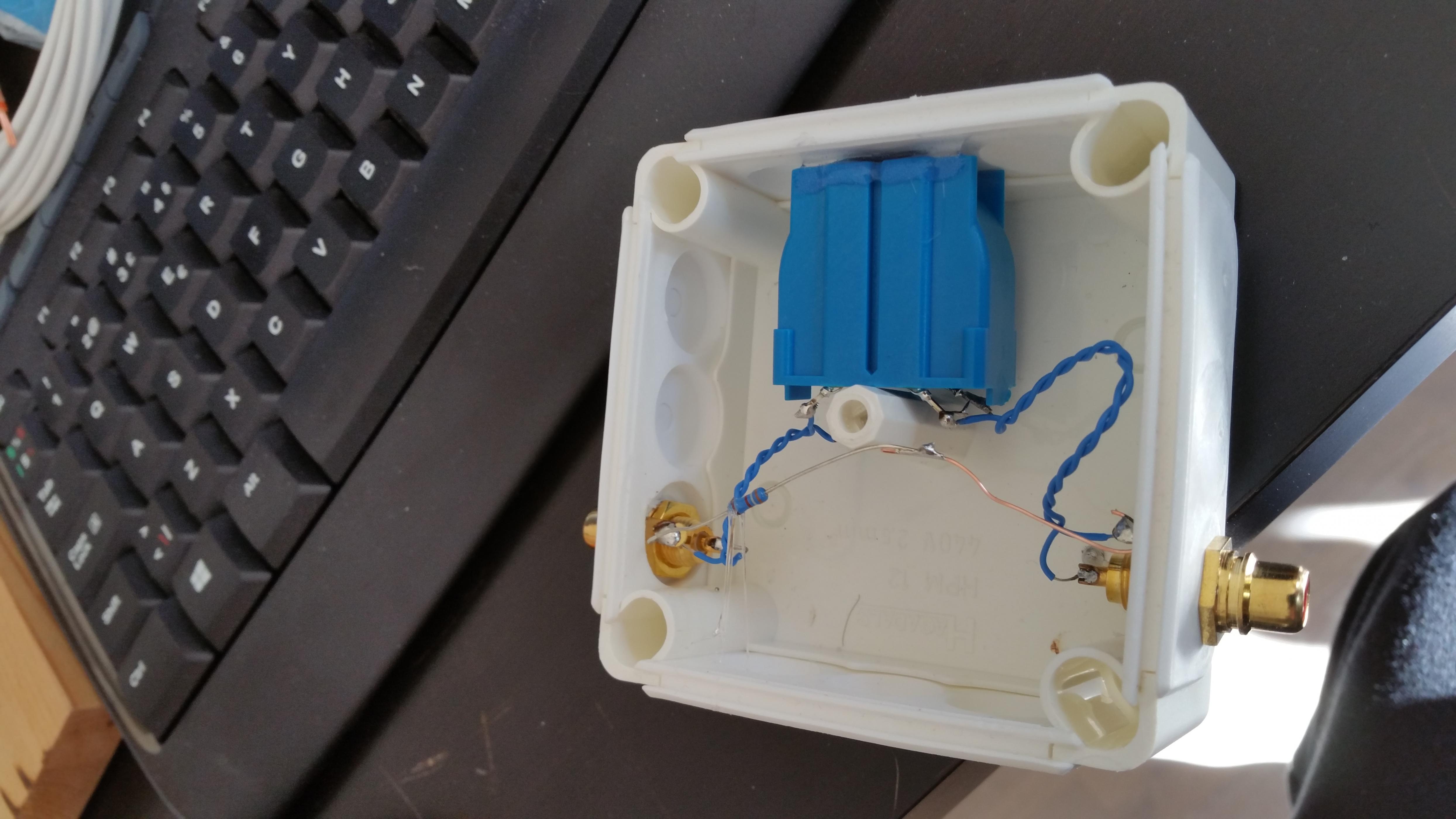

Try this. Before you say it, no, it doesn't cause any distortion whatsoever because it never reacts to the signal. It only reacts to common mode signals so the most it can do is fail to reduce a little ground noise (which still leaves you better off than a groundlift resistor would).
This is the kind of thing you want:
http://www.mouser.com/ds/2/355/DS_EV-EHseries_20110616_web19-8801.pdf
The photo has one on the left I got from a projector TV.

I would not go under 22mH, and not much more because larger chokes tend to have parasitics that worsen performance.
The Schaffner PDF you posted mentions a "line bypass capacitor" as well.
We're not using a line bypass capacitor because we're using the choke on the signal line, not the mains.
Okay, got it. I am ordering it soon. Digikey has the Schaffner 27mH.

It doesn't go on the mains, it goes on your RCA input in the same place as your signal trafo. And there's no line bypass capacitor because we're not using it for mains.

I solved most of the problem I think. It has annoyed me that the firstwatt F-5 that I built with star ground to the PSU-board has no noise, and the tube amp did. So I firstwattified the tube amp with a thermistor, in the same fashion as in the F5. I also moved the tube PSU ground to the chassie ground with the CL-60 thermister in between, instead of it being connected to the chassie at two separate points - one at the power connection and one in the middle, separated by 15cm. All I can say it helped a lot. I can still here some buzz when I stick my head in the horn. I will test the choke like you said in a week when I get the parts.
It could be, but it would be a break in habit to use anything other than an isolation transformer in that position.
The choke worked like a charm. Now there is only a faint hiss, but no scratchy RF noise. The cure was a choke and connecting the grounding more similar to a Firstwatt F5. Thanks!
