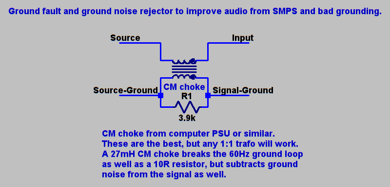

Try this. Before you say it, no, it doesn't cause any distortion whatsoever because it never reacts to the signal. It only reacts to common mode signals so the most it can do is fail to reduce a little ground noise (which still leaves you better off than a groundlift resistor would).
This is the kind of thing you want:
http://www.mouser.com/ds/2/355/DS_EV-EHseries_20110616_web19-8801.pdf

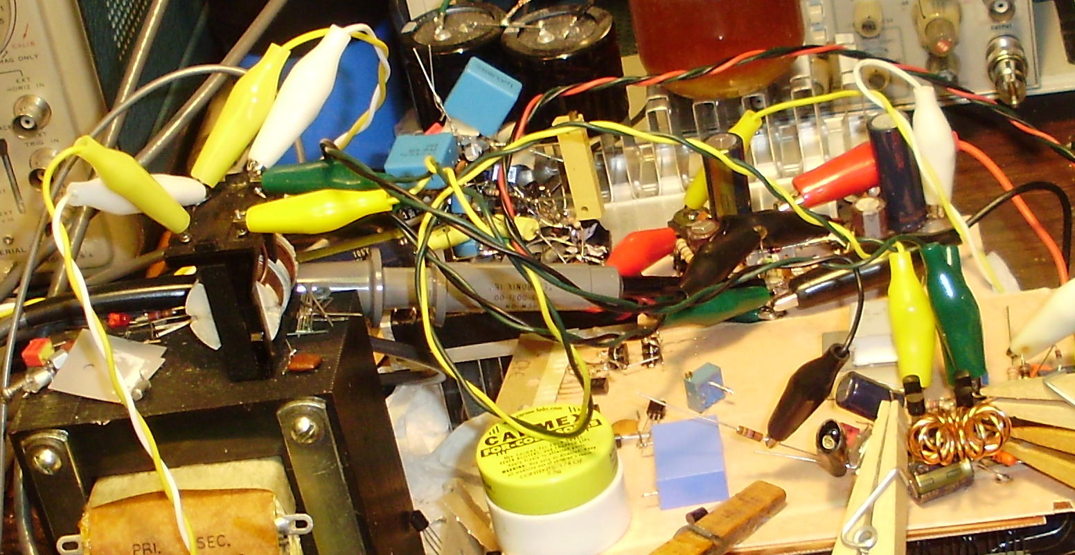

The photo has one on the left I got from a projector TV.
