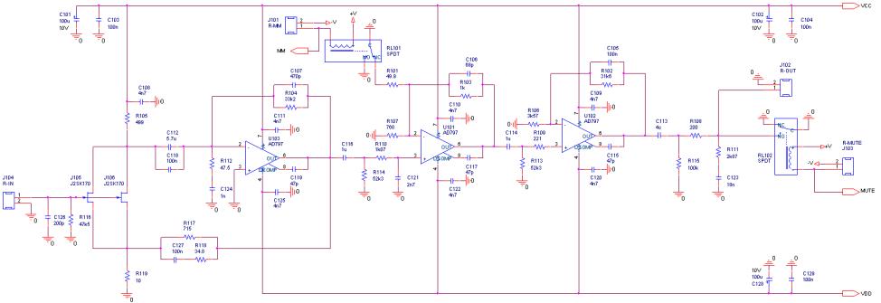

In your schematic you specify the fets running at around 4.5mA. The Fets I have happen to be around 7-8mA IDSS, so might settle around 6mA with 2.2 Rs.
What is the usable range, before Q203/205 will starve out for current? What is the supply voltage out of the reg, +/-15V? What is the optimal/targeted current feed for Q203/205?
I cannot see any reasons not to use LM49710 for U203/U204, which I already have, or are there any? Maybe it's just me, but I found them to sound better in a riaa app and less prone to instability as well.

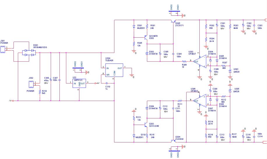

All excellent questions.
1. JFETs should be around max 8mA Idss. If more, indeed there's a risk of starving Q203/Q205. If JFETs have more than 8mA Idss, you may want to adjust R203/R237 and increase a little the current through R202/R240
2. There is no strict bias for Q203/Q205. 3-5mA or more is ok, but don't over do it, otherwise you'll have to manage the heat.
3. The supply voltages are +/-22V
4. You need opamps that support +/-22V. LME49710 usually are fine (I tried them myself), but you are outside the data sheet specs, so no guarantees. Nat Semi is manufacturing an excellent +/-22V audio opamp (LME49870) but unfortunately it comes in SMD only, so you need adapters. My suggestion would be to install DIP sockets, you may decide later what opamps you like. BTW, from the datasheets, it looks like LME49870 is nothing but LME49710 tested and guaranteed at +/-22V.

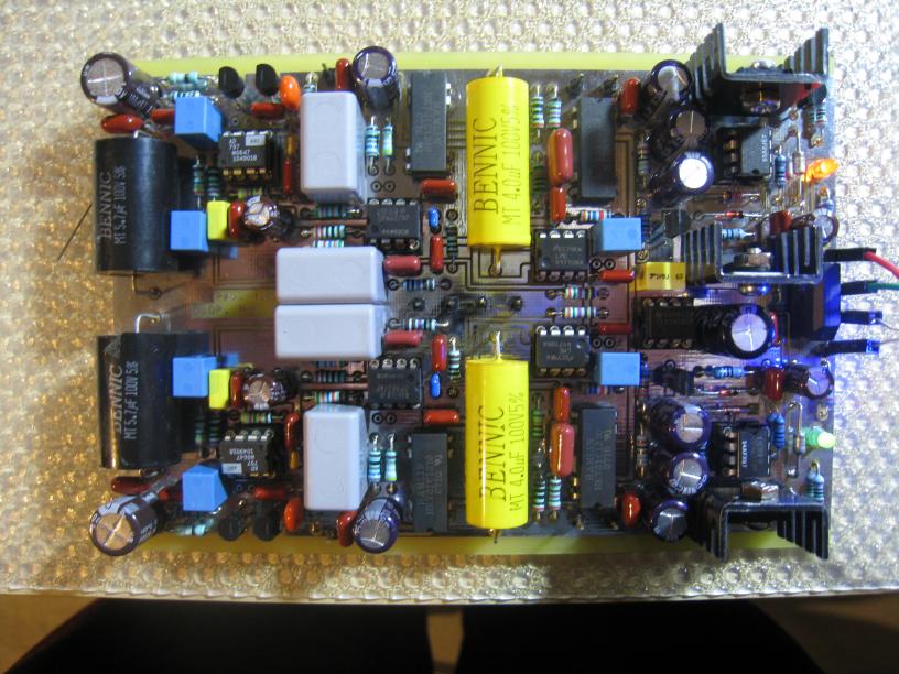

Here's a picture of the finished board. The metal case is waiting for drilling (will happen tomorrow) then the evaluation will start. From what I was able to quickly measure on the board, it's stable with AD797, OPA627 and LME49710, RIAA is +/-0.1dB (but I had to sort the RC's to better than 0.5% nominal and to 0.1% between channels). Noise is around 1nV/rtHz with AD797 in the input stage loop (I'll confirm this after the whole thing is cased and properly grounded).
Will be back in the following days (and of course on my web site, which God knows when I'll find the time to update) with schematics (nothing really spectacular) the implementation (I think the layout is very good) and the measurement and sonic details. Now I need some sleep.
