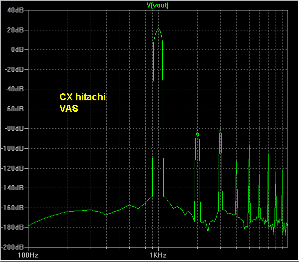

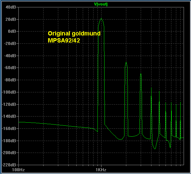

An interesting thing came up while simulating with the MPSA92/42's. Using the same input stage setup , 70mA bias at OPS , and 6ma standing current for VAS ,the high order harmonic content of the MPSA's VAS (I used KSP42/92 models - better) were VERY different from the Ksa1381/c3503's.
The first (attachment 1) is of the MPSA VAS. The thd was X 10 (.015+ %) the extra distortion was all in the 2'nd harmonic (H2).
The second (attachment 2) is of the More advanced CX. Equal H2 and 3 but both are far lower (.0006%).
Both tests were taken with 2.2mA tail current /1Khz / 40V p-p. The MPSA test was with the goldmund resistor arrangement at the VAS (no cascode).I also swapped Ksc1845's out for 2N-XXXX's , no difference with that cascode(input stage) . The input FET pair might be a factor in noise and total stage gain but should not affect the THD much (swapped that out , too).
My conclusion is that possibly a part of the the Goldmund's sound is the result of this dominant 2'nd harmonic distortion component. The lower distortion CX just has less of everything by a factor of 10. Nagsy suggested that we are deluded to run a test like this on a BJT output stage. THIS DOES NOT MATTER , A VAS will have it's own sound and characteristics regardless of what output stage one uses. What you hear on the speakers is a different story , the laterals are superior. :)
You can listen to a input/ voltage stage with headphones in pure class A. I am only simulating to discern what merits , if any... the Hitachi variant that guldmund uses is the "magic" behind the sound.
What we need now to round this off is someone who builds with laterals to give some input. (gatestoppers , layout , gate protection).
I was amazed at the differences a device can make , even in a simulation. We must choose what is best sonically, H2 swamping out higher order components or the absence of these components entirely .

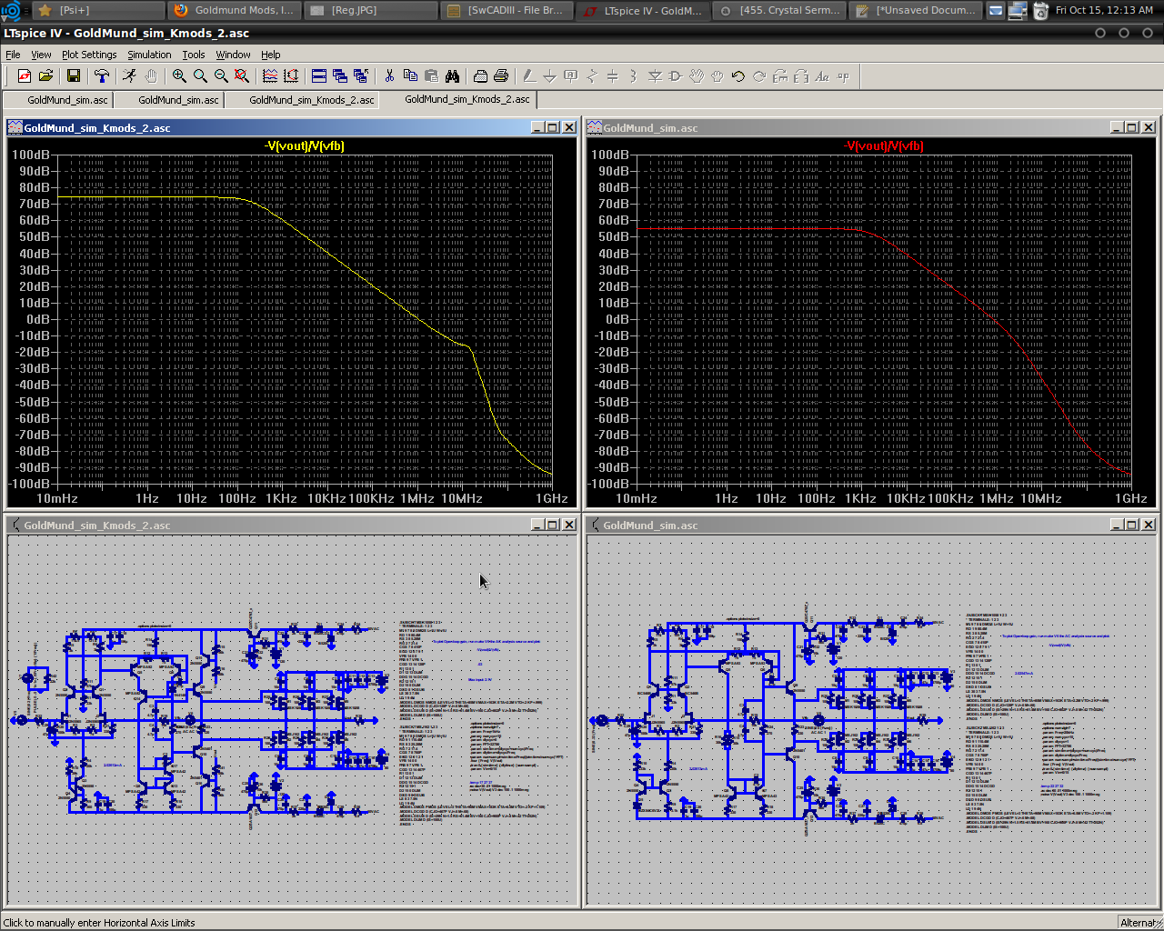

VAS Degeneration
We could remove the VAS degeneration, but this will have an extreme affect on all other aspects of the amp. The first post goes more in-depth about this.
Yes, OLG will increase, but OLG bandwidth will not. For example, look at the difference in OLG between the original and my mod. OLG and BW are totally separate. Open-loop gain increased at DC but the unity-gain frequency does not. So even if we improve bass or 1KHz performance, 20KHz performance will not be affected much as one poster pointed out, after simulating the amps at 20KHz rather than at 1KHz which was my test frequency.
So I would like to propose a new design criteria:
OLG -3db point should not go below 1KHz, which is the BW of the original.
I like the way Jam said it:
Obtain the required bandwidth (audio) before the application of feedback.
Along this vein, those who read the first post know how I described the VAS degeneration resistors improving phase behavior of the amp. As the current flows through the transistors in series, the transistor with the lower transconductance or Gm (the ratio of Vbe change to collector current, which is nonlinear) will dominate the gain of the stage. This means that gain decreases at power peaks, especially at high frequencies where the FETs need a lot of drive. This nonlinearity of gain vs. current demand creates phase distortion. While no degeneration might look good at 1KHz, the amp's pulse behavior will be changed radically, and will be harder to control, because gain will not be constant with power; we may get it stable, but the phase margin will wander with output level.
If we add enough OLG and dope the amp up on compensation, these problems are easy to ignore when looking at the other specs of the amp. However not only is this reported to sound bad, but it is a sign the amp is unreliable. The compensation necessary to sweep these issues "under the rug" is also disastrous for other areas of design that may be more important than blanket THD.
In this light the idea of making an amp perform well before adding feedback makes sense. It also makes for a more reliable design.

- keantoken
