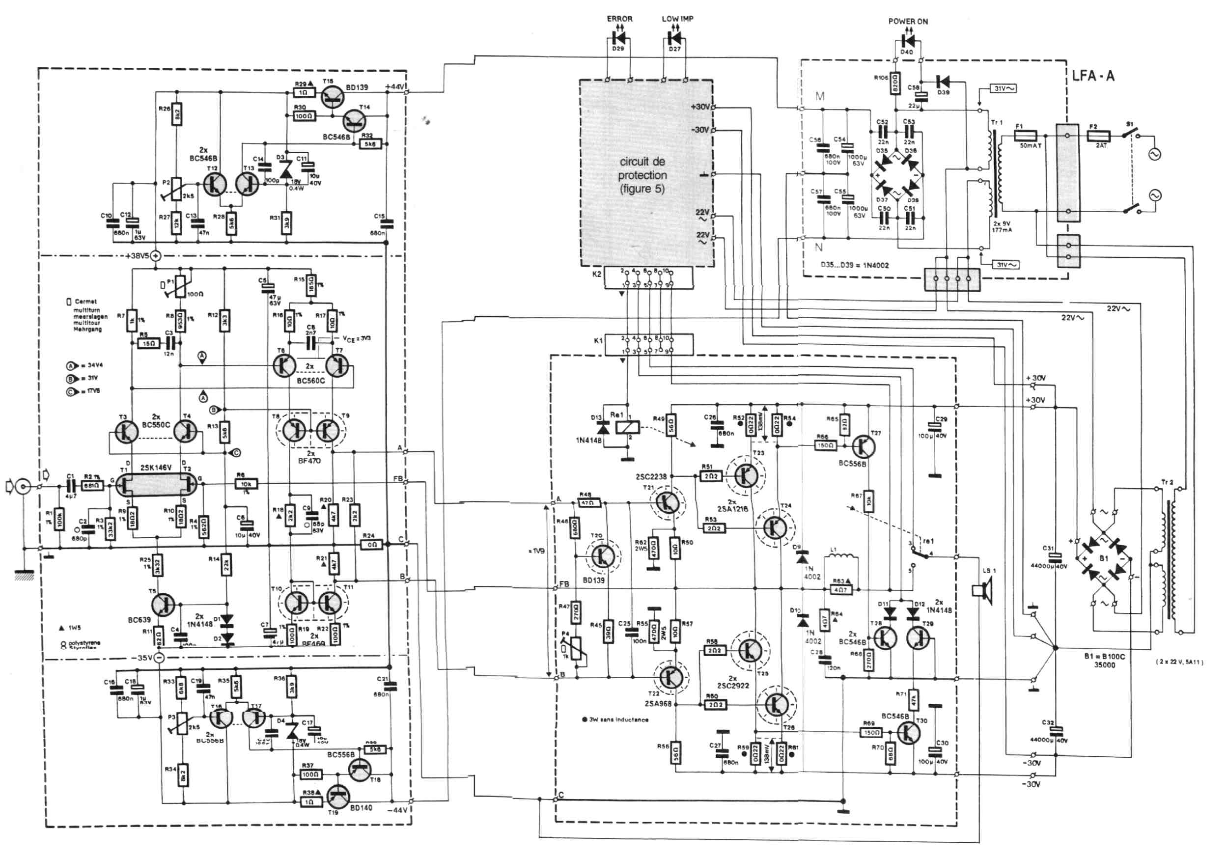

Here is LTspice schematic of Sentec
/Martti

A small issue with the simulation schematic is that the original Goldmund schematic has a 2k7 series resistor in the driver voltage doubler. This will probably drop about 50 volts (assuming 20mA current). This would also imply that the +-80V supply suggested by nagysaudio is higher than what Goldmund originally has. Does not make sense to have lower voltage on the driver rails.
/Martti

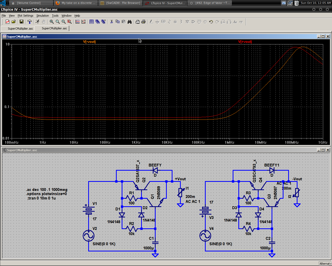

Resulting voltage is no more than 70V with 8mA current, wich
is about the one drained by the front end.
Rising time of this voltage is about 10 seconds after power on..
Here the sim for the original PS and for a modded one as well
as the two schematics.

VAS resistors
QUOTE: Amps with this kind of topology seem to be a fashion at the moment.
This is the first one I see that uses emitter degeneration resistors for the VAS LTP. What's the point doing so?
To increase the linearity of the VAS and to decrease distortion......
regards,
Piersma
regards,
Piersma
Piersma
Not that simple...
Linearity of the VAS increase, but available gain for NFB
decrease as well..
Worse, the gained linearity doesn t manage to compensate
for the said NFB ratio loss, leading to actually higher THD...
Agreed Wahab, but what about the balancing of the diff. pair without the resistors?
regards,
Piersma
If it s the two 75R source resistors, it s not possible
to reduce or suppress them, moreover if high gm fets
like 2SK389 are used, as the circuit would be instable.
Their purpose is not to balance the input stage fets,
but to reduce their transconductance to levels compatible
with a decent stability of the whole circuit..

You would be surprised to what a Low Z (sub mOhm) dedicated reg can still subjectively do over basic amp's sonics if incorporated for the non power stages... Don't think in terms of PSRR and ripple. Think stages intermodulation over rising rails Z towards the highs. A parallel reg at such rail levels would add dissipation and complexity maybe many builders would not spare for a benefit they haven't tasted so to trust in, at least use the lower Z, flatter impedance Cmult in line filter you can. Keantoken had a good proposition lately in some thread as I recall. He could scale it up voltage wise maybe.
Not that simple...
decrease as well..
Thanks. This is about what I expected and simulated.
What if you add a current mirror to the input stage LTP? This adds some more gain to this stage and maybe can compensate for the gain loss in the VAS LTP?
I can't let go the idea since I simulated this for so many hours...
