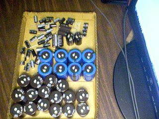

So begins the recapping of this beast , all the best ... 105c @ 100v X 132,000uf !!
stage 1 (the power supply /recapping - inrush thermistors), will be really labor intensive requiring a lot of solder and just massive physical replacement (attachment 1). Once I have all the nicely recapped supplies - (+ -75v main amps) , (+- 40v - VAS's) (+- 30v and +- 12v /5 V auxiliary supplies) that is alot of supplies - 68 caps... I will simulate the blown Voltage modules on LT to determine their method operandi... .

The big blue ones (8 X10,000u @ 80v /105c CDE)and the medium/small ones came today. I will try to replace as many as possible with my 25 watt iron + solder wick (I hope I have enough - 2/ 5' rolls). I might need to go for a 40w iron for the 10 gauge "electric range wire" the stealth uses almost anywhere.

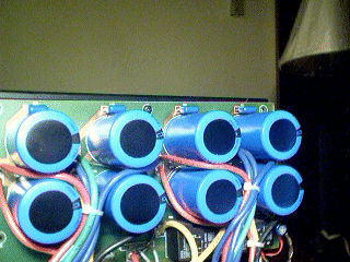

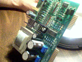

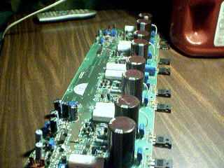

All done recapping / cleaning and fixing the messed up traces left behind by some one other than me !!
pix 1 - the easiest one to do , thick board , thick traces , never touched by previous tech - 80.000 uf CDE caps at 80V.
pix 2 - the input / aux. power supply board. This one also was restored to perfection (and works perfectly) never touched after it left genesis (until now). It has all the input relays/buffers ,+-5v, +-15v, +-30v, and +-42V, and holds the voltage amp boards.
pix 3- Main amp (26,400uf per channel)... this is the heat generator (for those cold northern winters).
pix 4 - The voltage amp , these are both failed .. next I will simulate them because the schematics are vague and incomplete.

WOW! Looking good OS! Amazing work. You changed all the Genesis 85 Celcius caps to 105 Celcius caps. I like that! This Stealth should be a lot more reliable now.
There are two main amp boards (L & R) being recapped (pic 3 shows one)?

I did the other one, too. It just does'nt have the mosfets replaced yet , BTW .. to do this the WHOLE amp had to be TOTALLY disassembled (every dang last screw)There are two main amp boards (L & R) being recapped (pic 3 shows one)?
