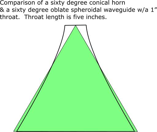

This is a good visual comparison of a conical against an OS curve, albeit not in three dimensions. This illustration was done (I believe) by another diyaudio member, Patrick Bateman.
It's simply like this:
The red dots are the cone, that the WG is asymptotically passing to - it defines its radiating angle. These are the asymptotes of the hyperbola.
