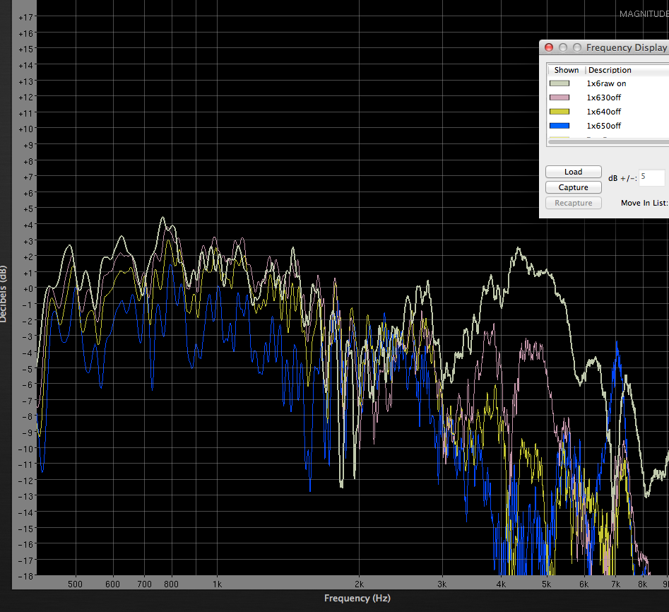

So considering a 6.5" cone midrange, what size WG would typically offer an ideal directivity match to say 3-3.5khz?
As Earl said, to avoid guessing requires measurement.
I measured an Eminence Alpha 6 in a small box on axis and at various angles off axis.
At 2.5 kHz, there is virtually no difference between on axis and 50 degrees off ("waistbanding"), while at 4 kHz around 18 dB difference.
Above about 1800 Hz, the speaker has no "constant directivity", no waveguide will match this speaker's polar response.
The box baffle size and edge radius also affect the direct radiating speaker's polar response.

That's not how I read his post.
I read it that the midrange is direct radiating, not on a waveguide.
Perhaps he can clarify.
And correct....it's on a wide, 12" baffle now as a B&C 6MD38. No phase plug to help but it's cone isn't 'conical' and I suspect (guess) its going to hold pattern to 3khz or so. The baffle being as wide as it is, I could create a shallow guide but I doubt there'd be any real Improvement in directivity at only 12". But the 6" driver allows me more options for a smaller waveguide above....maybe even a horn loaded ribbon, my first plan.
The system is designed modular so it leaves me lots of options with the mid driver in its own enclosure on top of a bass bin loaded with a 15" woofer. I suspect that being to angle the top, HF module will allow me the flexibility to steer the forward lobe and mitigate some of the combing associated with the higher crossover point. That's the plan anyways.
As to measuring the mids directivity, I have far too much ambient noise in my backyard to do this, and no effective in door space either. I'd have to head up to the country and hope the birds aren't in love!

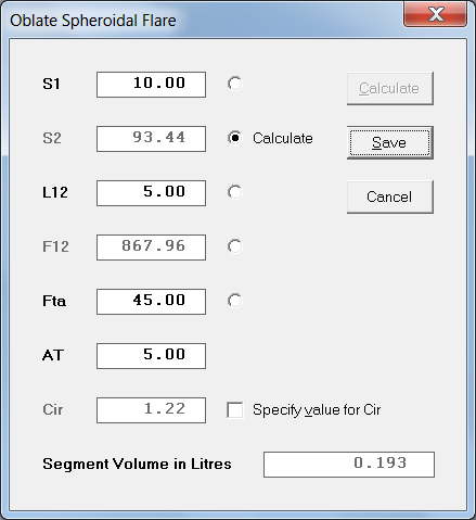

Maybe it has been here before, nevertheless here is the exact equation for OS contour for a non-zero entry angle (phi):
I've derived it for myself to avoid the cut & try approach but it may be usefull for others as well. It really simplifies the process of generating the coordinates. Other variables are as usual.
OK, sorry then to everyone who is not using the "tg" for this function.
Maybe it's just the former eastern block, I don't know, never bothered. Now I know one must be more carefull 😀
BTW, did anyone check if it's right? I did but might make the same mistake twice...
More Formula
Here are some additional formula that may be helpful as well.
