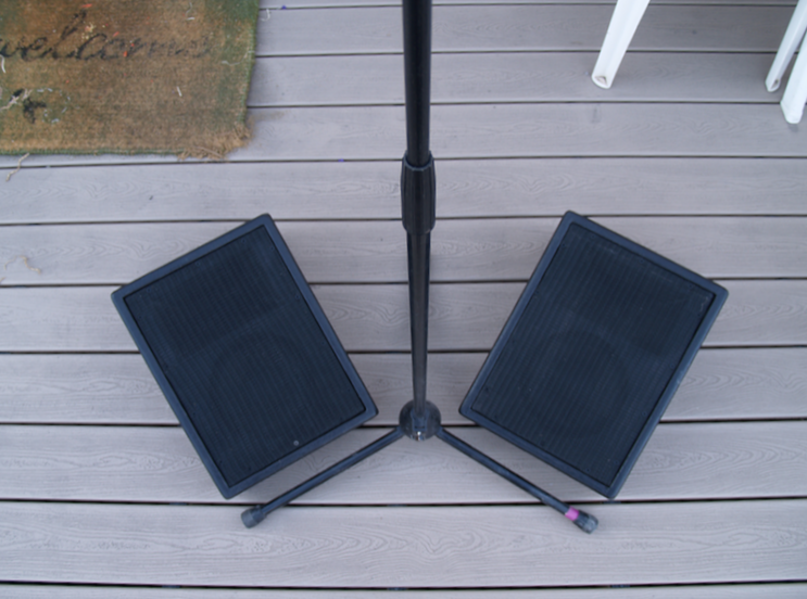

There are not enough details on either of those to comment on, but since they both have round throats and rectangular mouths, they both have to have problems. Which is better or worse is hard to tell just from a photograph. I suspect that the radial design has a diffraction slit to be that wide. That's a real no-no in my book.
There is no clear indication to me that an elliptical pattern is any advantage. For example, the woofer is not and cannot be made to be elliptical so this makes for a bad power response transition at the crossover. That is likely to be more audible than any supposed reduction in floor or ceiling bounce (which according to Griesinger are not audible). And the narrower vertical dimension means a less than attractive lower bound on the vertical directivity control, unless the vertical width is held at the same as the round version, in which case the width becomes excessive. For a given baffle area availability I still contend that round is the better compromise.
All good points which were carefully considered when designing the last set of floor monitors I built using a rectangular waveguide.
Building to a specific baffle size only 14.75" tall, 16.25" total including the cabinet walls, the reduction of mouth area using a round wave guide would have required a much higher crossover point than desired for the application.
Had space for a larger round wave guide that could have been crossed as low as desired been available, it would have been considered, but lacking a lathe, not for long 😉.

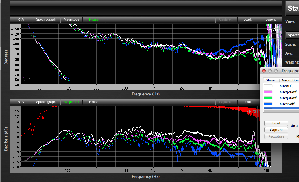

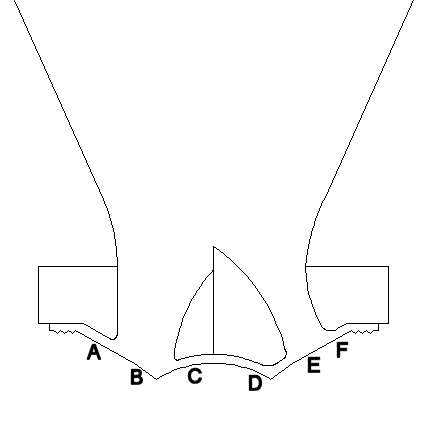

I am retro-fitting a phase plug to a conical horn on an 8" cone intended for use up to 1kHz. The horn was built with the intended throat area at the baffle so I enlarged this and changed the throat entry angle in order to extend it down to the driver cone.
I am in the process of faulting some phase plug designs, ie. the left half shown has been chosen for equal path lengths and the right has been chosen for equal pressure on each side of the ring. I've built the left one but am considering the right one.
With a compression ratio of 3:1, I figure that if the pressure at D, E and F is 0dB then they would add to 9.5dB at the throat, below some frequency... Whereas A, B and C would be at 2.5dB, 0dB and -3.5 dB respectively and would add to 7.5dB of wanted signal and -3.5dB of HOM based on the physical separation of the two entry points against the virtual location of the throat.
With the left phase plug maintained as shown, will this HOM (pair?) cancel itself at the next crossing? Will it continue to increase its path length difference with the main mode and affect lower frequencies? or will it simply be limited to some higher frequency?
On the right side the (average) path length differences before the throat seem to give no problems for two octaves above what I need and would not have the pressure difference. I considered tilting the throat to equalise the path difference from each side of the throat entry but this would seem to be adding an unwanted throat chamber.
Is there any significance to this?
These are hard questions to answer, they would take a lot of study to calculate.
In general what you want to do is to minimize the path length differences from the various parts of the cone to the horn juncture. It appears that neither of these would do that - something in between would be better. Then you need to consider that the phase plug entrance is at the midpoint of the Fresnel zones so that the amplitude is constant (but is a single slot phase plug this is kind of irrelevant.)
