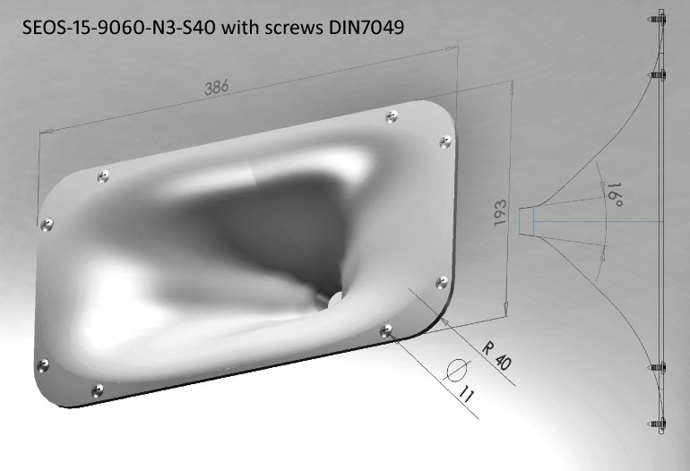

Here is an updated picture of the prototype
Looks like kind of like the popular QSC HPR152i waveguide (Which isnt sold any more, that could change too).
