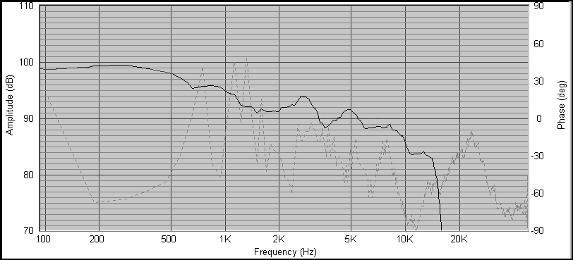

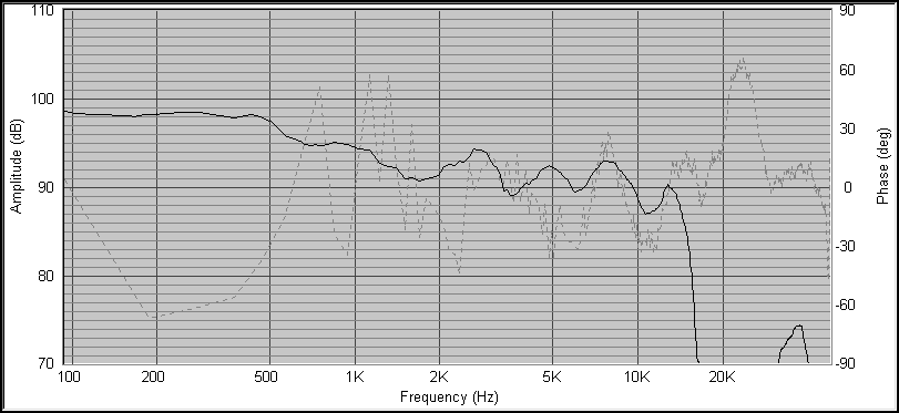

This may be a bit premature, as I'm not sure I'm seeing what I'm trying for. I made a "particle velocity microphone" by removing the back from a miniature electret microphone (the usual WM62), exposing it to pressure from both sides. This gives it a directional characteristic, rejecting sounds coming in parallel with the diaphram (as a dipole is supposed to do).
I mounted this in some brass screen (for electrostatic shield) and made a (not very stable or versatile) holder for it one of those "third hand" circuit board holders. Here is a poor photo of the mic, next to a 9V battery for size (you can barely see the 6mm capsule inside the screen).
The capsule was positioned in front of a constant directivity horn (from a QSC HPR152i), first so that it faced inward toward the driver, and then rotated to achieve the deepest response null I could get. The measurements were made with a ~4msec window to avoid in-room reflections.
The idea of this is that the wanted wavefront from the guide should be spherical, which to a small enough capsule should be reasonably close to being planar. A velocity capsule (like this one is now, more or less) should reject planar waves coming at it edgewise, leaving wavefronts from HOM which will come at odd angles. Needless to say, no numerical measurements are likely from this scheme, but perhaps some comparative picture may be doable (such as evaluating foam or the effects of defects in the throat).
The frequency response from this capsule should be (and is) rising 6dB/octave up to around 20kHz, so keep that in mind in the response plots. The driver is a B&CD DE250. Notice how the mic's response flattens the mass controlled falling response of the driver!
Here are the measured responses, red is with the mic rotated for a null:
Here are the impulse responses corresponding to the responses, the direct-on response:
and the sideways-facing response:
There is a lot of periodicity in the nulls of the sideways response, which might indicate interference between the direct wave and perhaps a wave reflecting back down from the mouth (?) or maybe some other reflections in the setup such as off the mic arrangement (it is all small, but will still reflect some) or something else nearby. So what is left may or not be HOMs.
To be useful, this setup would have to be made more robust, better adjustable in three planes, and testing done in a better controlled environment. But I think it might show some possibilities.
I would guess the periodicity is the reflection visible in the sideways curve at around 1.3m. Is that m for milliseconds or is it calculated meters? It is just as likely a reflection off of the floor, the cabinet, or something in the vicinity.
Figure out the delay between the direct response and the reflection, convert it to a distance and go looking for a reflection that corresponds.
