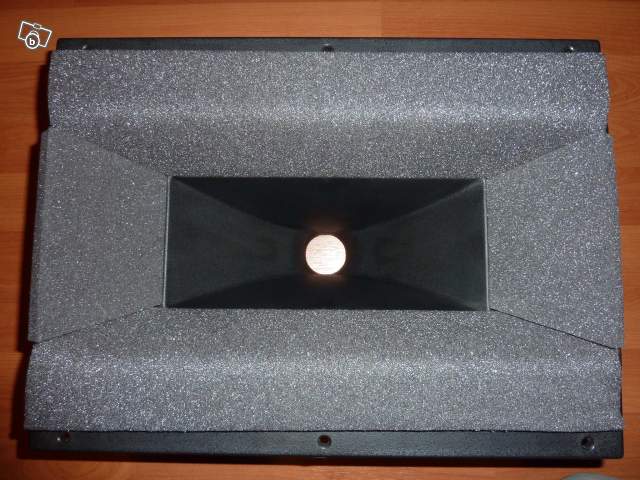

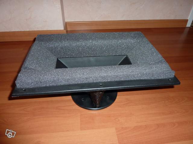

I linked it earlier, but yeah, it's basically a beveled open-cell foam designed to act as an edge termination, but since it's only partially absorptive, it's angled to act as a decent termination even if it were a rigid material. It suppressed the peaking of the WG around the cutoff, and made for a nice improvement in smoothness.
It looks very much like what Peavy did with their quadratic waveguides:

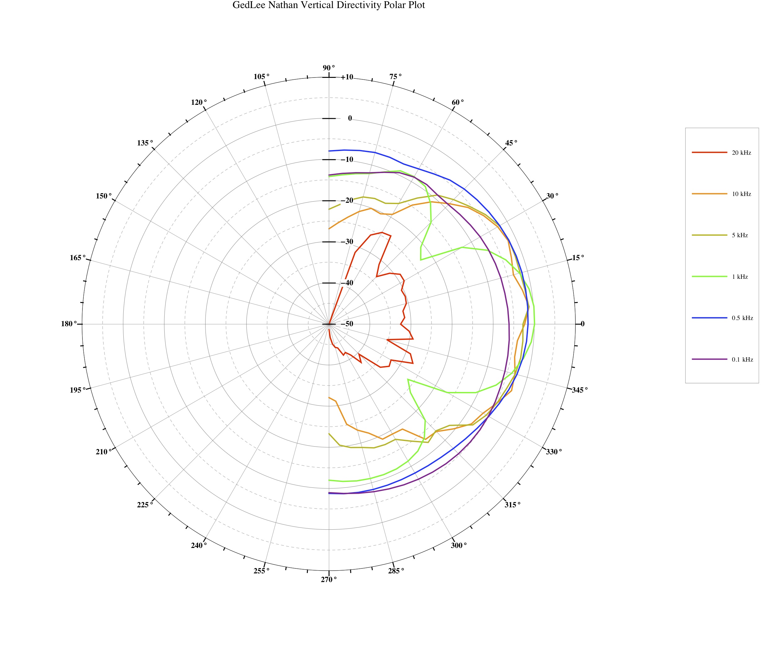

Because it is only 10" vertical height and yields a respectable +/- 15° or larger (-6 dB) forward vertical lobe when crossed between 1.0 and 1.5 kHz.Zilch those are all great points. OF course, Its the 12" OS WG that I have been discussing so I really do not see how the 14" wide 152i yields anything more practical.
The cost, the aesthetics, and the unresolved vertical polar question.Posting jzagaja's 12" OS waveguide design just had little acceptance and I really wonder why that is.
Read the "Horn vs. Waveguide" thread again; Earl's standard at that time was the predecessor to Abbey, and in some respects, the comparative results were surprising. Duke independently selected the Pyle clone of the original JBL EconoWaveguide for his Prisms after doing considerable research and evaluation of available alternatives. It does not suck, and by one view of Brandon's data, the QSC offers equivalent pattern control performance with the additional benefit of a mouth roundover.I guess I just have never seen those measurements. All measurements of Geddes Abbeys are superior to any QSC design measurements so just what did I miss? Some measurement comparisons would help me understand.
Hello Zilch
Isn't that the same as the Nathan used in the Princeton measurements??
Rob
Yes, basically, but the conventional polar plot does not reveal intrusion of the vertical nulls. Look at the directivity map to see that.
Nathan's C/C distance is somewhat wider than is achievable even with the QSC 152i. Frankly, I was surprised to see how low Nathan is crossed to produce a reasonable-height vertical lobe. Earl concedes the Nathan waveguide is too small....
