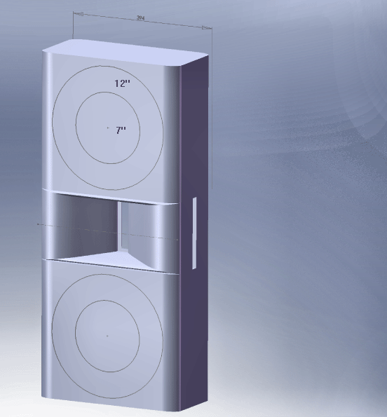

Vent holes in horn.
No, these are definitely not entrance holes for mid range. I had a long discussion with him, but thought it a bit too nosey to ask about details of the concept behind the holes. The mids are separately horn loaded. This is not a Marukami US4437540 type of horn. The EV example is nothing like it.
Iain.
If my guess is right, Michael O'Neil may have mis-stated himself or may be getting misquoted- sure looks like a unity horn arrangement to me. Those holes are entrances for midrange speakers.
Iain.
Just saw something at PLASA trade show(Pro Audio, Lighting etc) I had never seen before. Holes in the side wall of a horn, "to relieve back pressure on the returning wave". If it had been anybody other than Michael O'Neil of One Systems (ex of Electrovoice) I would have passed it off as "sales talk". But I went over to the EV stand, and they also had some new product with holes in similar places. Below is a drawing from EV with holes clearly shown. Any thoughts on the theory behind this? In the one systems product it is not on a coax system.
Iain.
Thanks for sharing - those holes are an interesting thing - though the "back wave (looped refelctions) reduction effect" IMO is the same sales speak as you now read that EV-horn's are actually "wave guides" from now on.
In a few years we possibly will read EV, JBL etc. are no longer producing "horns" nor "wave guides" but "diffraction alignment device" or whatever is hyped then

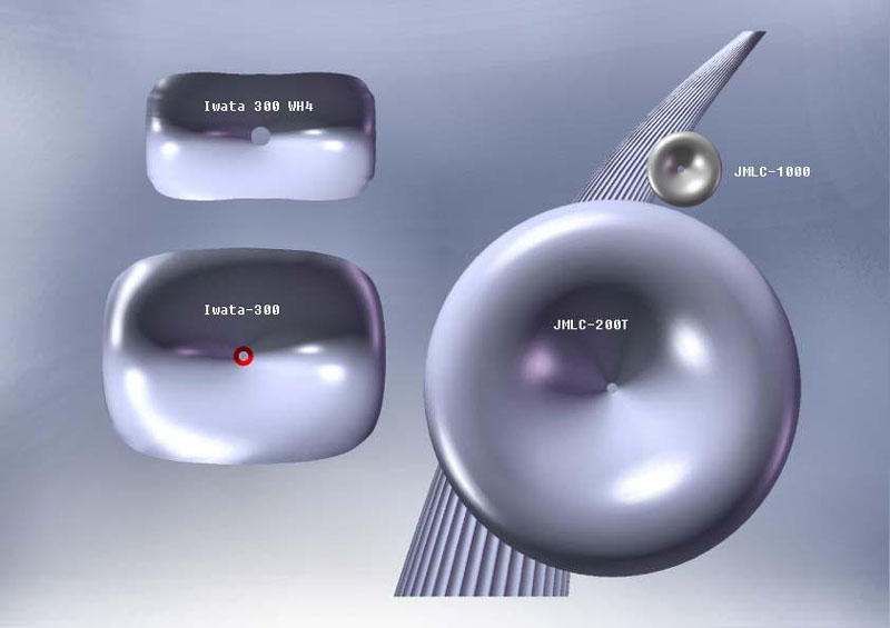

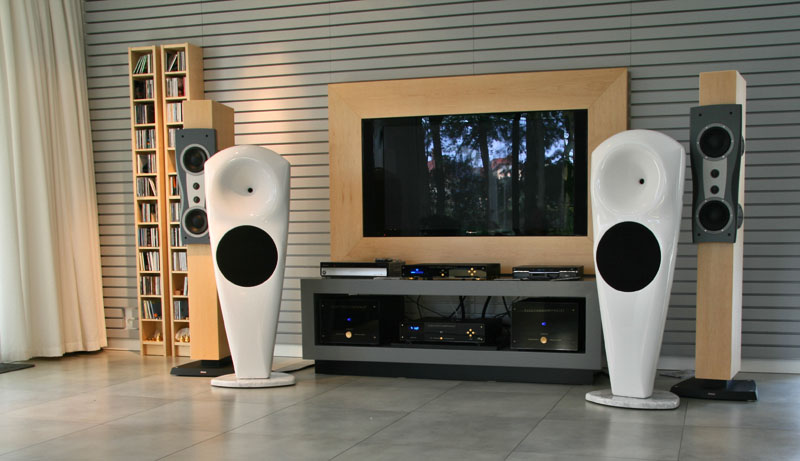

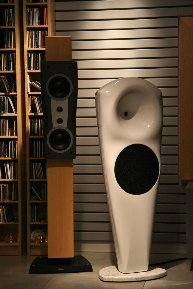

As its a coax construct, there is also low frequency content entering in the area of the HF horn - this may have even more audible impact than what they claim for advertising reasons.
Michael
VERY nice!
Now that you have them with Dynaudio speakers, what about some listening impression/comparison?
Room was above 60m2, highly reflective (windows everywhere) with slight echo. Tonality from Dynaudio was ok, nothing disturbing even closely miked female vocals but cymbals, brass in general lacks energy - I didn't hear percussion from Esotar tweeters, sound without life. Mummies were oversharp (albeit have falling HF response between 20-30deg) and of course lacked last octave. I'll double check everything again and wait for opinion of foam plug on the same WG. Fiberglass was damped with polymer coating. In the same time I'm building two way JMLC horn setup and dipolar AMT waveguide (Gauss type) - then we can make finial comparison.

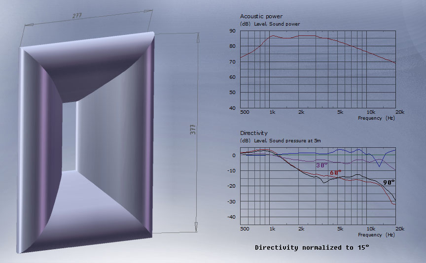

Any thoughts on waveguides designed to operate in a 90 corner?
My motivation is that I have a rather small room to be used for home theater. Getting the speakers a fair distance away from the walls as recommended by Dr. Geddes and others may be quite difficult. However, the front walls and corners themselves are clutter free simple planes, so naturally it comes to mind to try to integrate the waveguide into the corner somehow. This would be somewhat similar to what Patrick Bateman has experimented with in his in car unities.
In order to fit the drivers, etc, the waveguide itself would have to be slightly wider dispersion than a conical 90 horizontally, producing a discontinuity. Alternately you could have a waveguide that looks more like the prolate spheroidal coordinate system, which we know from Dr. Geddes is undesirable.
Another approach might be to treat the corner as a 1/4 space waveguide, make the speaker itself as small as possible and concentrate on smoothing the vertical discontinuity where the baffle meets the corner top and bottom. I'm visualizing something like a sphere intersecting the corner with fillets.
I don't think that I ever said that, in fact, in my book I point out that the Prolate Spheriodal is a "perfect" shape, just as the Oblate Spheriodal is. I also point out what the throat configuration needs to be, and in one of my patents I show how one can create precisely this throat configuration. So I would not throw out Prolate Spheriodal, I have used it before.Alternately you could have a waveguide that looks more like the prolate spheroidal coordinate system, which we know from Dr. Geddes is undesirable.
If the directivity is such that it is less than 90 degerees then corner or free space is basically the same. Think of a flashlight of 90 degrees pointing out from the corner. It doesn't see the walls so their being there or not makes no difference.Another approach might be to treat the corner as a 1/4 space waveguide, make the speaker itself as small as possible and concentrate on smoothing the vertical discontinuity where the baffle meets the corner top and bottom. I'm visualizing something like a sphere intersecting the corner with fillets.

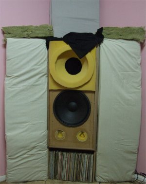

I too want to stay in the corners. I have flanked my speakers with 16" wide absorbers. The total width is around 50" in the corners and I suspect this is closer than recommended...but the improvements brought about by reducing reflections and by bass trapping are well worth it.
Here is a photo (with drapes removed).

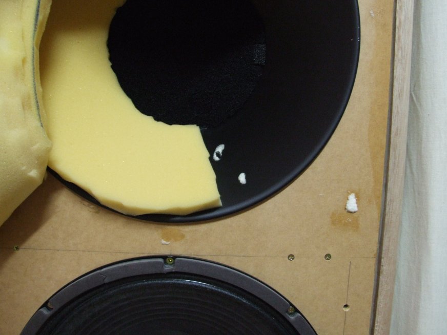

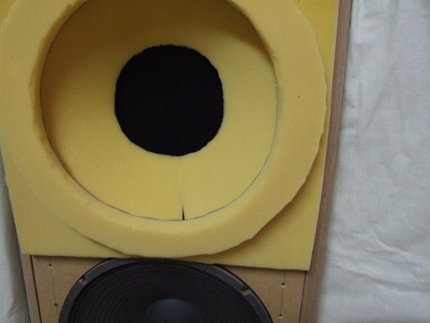

I have used closed cell foam in an attempt to sculpt a mouth termination for my waveguides. These are 90 degrees and 15" at the mouth, and I have fair sized holes in the on axis response.
I am considering using thin rockwool over the baffle around the waveguides. Would it be worth doing?
Dr Geddes,
Usually you'd want to use open cell for this as it'll damp the termination rather than closed cell, which will act like a poor quality rigid termination (rigid as in structural). It'll still smooth ripple but the open cell will do a better job in most instances IMO.
Yes, basically closed-cell is a rigid structure to sound waves.

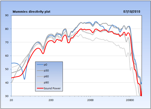

Cool !
You girl friends tattoo my be a good starting point for you - *if* you are after a math or physics degree
Way better if you are more after *understanding* whats going on regarding diffraction is to leave all the math to the software programmers – and just look at the outcome of simus and measurements to get a good picture of what actualy happens
Start out here :
http://www.diyaudio.com/forums/multi-way/103872-geddes-waveguides-56.html#post1847931
And continue here :
http://www.diyaudio.com/forums/multi-way/103872-geddes-waveguides-66.html#post1927585
Once you get around to *read* those plots you will realize by comparison that the whole diffraction story is plain simple.
The conclusions are even more simple:
- you cant avoid diffraction
- you have to see/use (any) boundarys as an allignment device
- penality to bad alignment are looped reflections (CMP behaviour creeping in)
Michael
