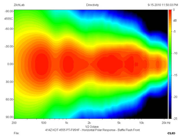

Doug - Earl has been describing an OS profile. The 18 Sound XT1464 is not an OS profile.
In other words, if you want an upper freq. response that is extended BEYOND 8 kHZ on and off axis in an OS waveguide, THEN you generally need something smaller than a 1.4" exit driver.
There isn't anything wrong with the XT1464, but it's directivity is narrower than an OS profile, and past 40 degrees it essentially will NOT match the directivity of the pairing woofer (..and doesn't in the Raptor.) It is of course still a very good design, but it is different.

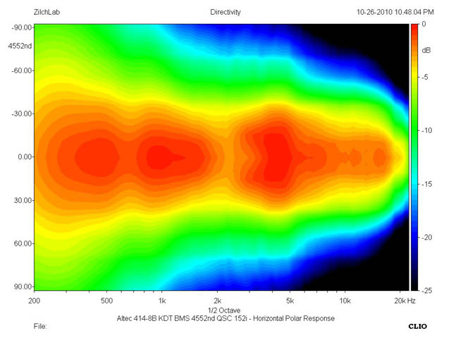

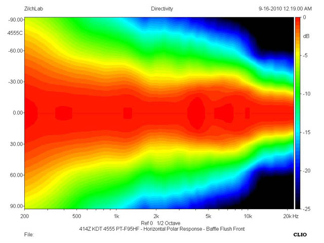

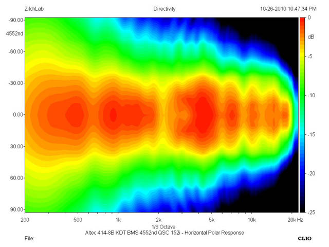

1.5":
1.0":
Larger throat diameter does not support constant directivity as far into the top octave; Earl told us this years ago.
1" BMS 4552nd on QSC 152i does not quite make it to 20 kHz.
1.5" BMS 4555 on JBL PT-F95HF begins losing it down at 8 kHz.
[These are normalized polar maps from 5° increment data.... ]
1.5":
1.0":

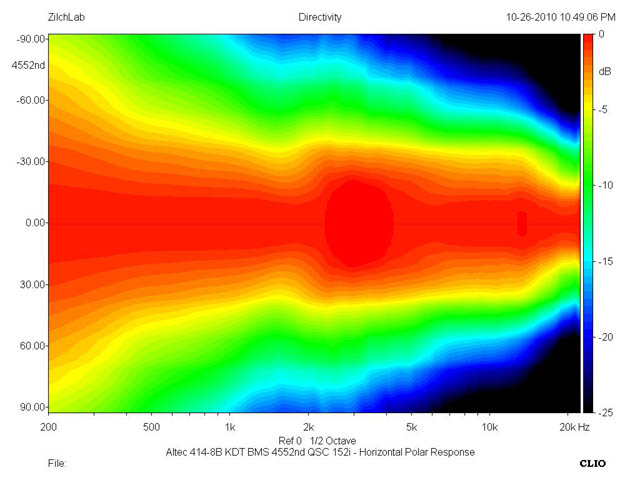

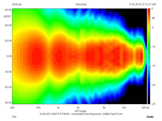

Here are the non-normalized maps, from which Earl might be willing to analyze these designs.
1.5":
1.0"
1/6 octave smoothed also provided below:
1.5":
1.0"

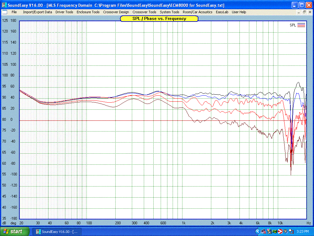

No thanks. The last time you asked me to do that, you crucified me because you didn't like what I had to say.
They all look heavily smoothed. Send me the raw data and I'll post them plotted the same way as I do my own.
Yes, smoothed and normalized to illustrate the difference we are presently discussing.
Elias was able to read the CLIO MLS measurement files. Can you do the same?
Otherwise, I will reprocess them into ASCII data files, 2048 points max. My options are:
1) Display Frequency Data
2) FFT Frequency Data
3) Time Data
512 points sufficient?
3) Time Data
