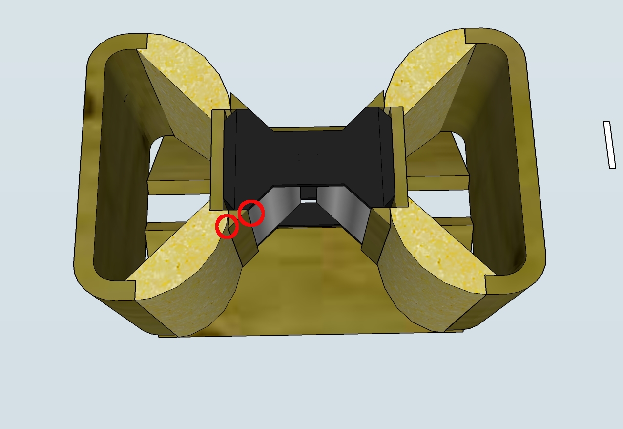

One project I'm working on is a set of horns for Heil AMT1s. Would love some feedback from the good doc. The profile here has been modified, with the MDF roundings flattened to maintain a straight expansion as well as prevent constriction of the wavefront and associated diffraction.
Would love to hear your opinion on how this will operate, Doc. The profile is close to OS (straight wall into a gentle flare at the end) but obviously we're talking about a ribbon source not a round one. Earlier on, there was a post simulating something very similar from Mige0:
Dipole Horn, Dipole Directivity Control Device

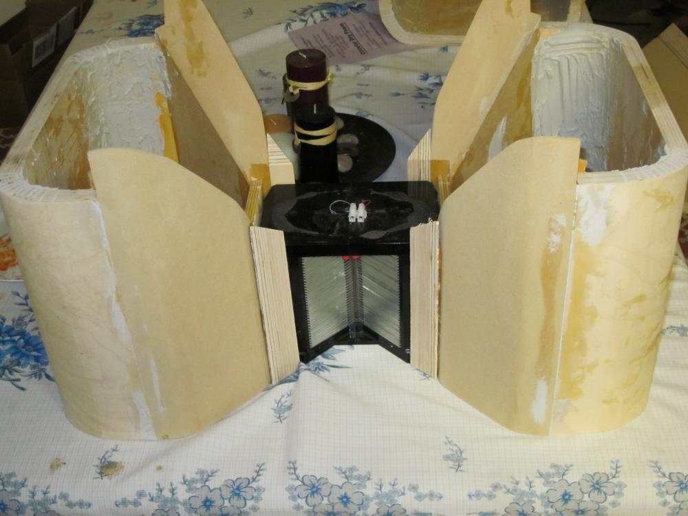

First shot is the underside to help explain assembly, second is as it would look in use. The bottom plane would be the top of the woofer cabinet.
That was an interesting page. I've doodled similar sketches for the Beyma TPL150 monopole for a project later.
The profile beyma uses for their hornloaded version is similar to what I've done- I won't call it OS but that's the closest match, a straightwalled flare with a short roundover termination. Mine wraps around to the rear of course, because it's meant to stand on top of the bass cabinet. The Beyma is intended for baffle mounting. I plan to use some acoustic absorption on the bottom plane (the mounting surface for the AMT) since it's so close and I want to minimize any potential comb filtering.

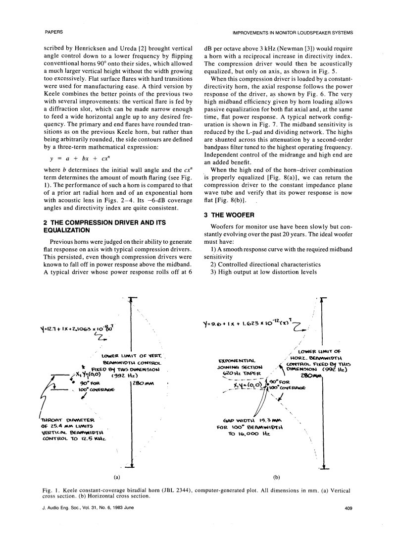

Looks like an ideal case for a Keele CD flare as used in the JBL 2344 (4430 horn). This gave a very consistent 90 degree beamwidth and great polars. You can use the same flare horizontally and vertically, although the ribbon length will preclude getting full beamwidth to a very high frequency.
The text explains the calculation of the flare.

Cool beans. Yes, my thinking was that it should act very much like an idealized form of the Keele and/or OSWG. I'm not sure whether I'll include the top section or not, given that there's some LF directivity imposed by dipole cancellation and HF directivity imposed by the height of the source, it seems like the horizontals are more critical to include, and the top may not be desirable.

Now that we have split the "real driver" ("sound generator") from the horn at the right place we could look at your design where possibly could be seen room for improvement.
As you are certainly aware of, any horn contour that have kinks is sub optimal. This holds true very generally as any kink creates reflections that get looped in the horn and also can not be corrected upstream (EQed) because they happen in time (CMP distortion).
At the first inch of the horn / waveguide there isn't much you can do with both a compression driver or a original Heil.
But then what I'd suggest is simply to remove all kinks of horn / waveguide contour in the first place.

Mige0: I have already sanded the projecting rounded portions down. When I first looked at the assembly, it seemed like less of an issue than the render (or real life) show. It's been corrected. The intent was always to fill the assembly-to-heil gap with foam window gasketing. The remaining "plywood triangle" to MDF gap is in-process of being filled with Bondo
