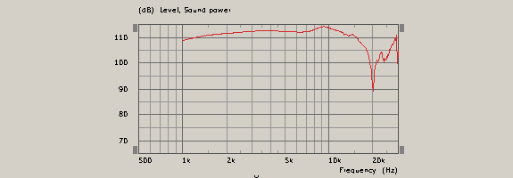

I thought I throw this sim data up to see what points of views anyone has.Doing some investigation on compression effects, it seems the compression driver tends to provide a constant power response? If this is true, shouldn't an OS provide a flat response without EQ?
What kind of point of view could anyone have with so little info? Sound power of a lawnmower in the rain?
To answer your quoted question; no, compression drivers do not produce constant power response, they can't. Above what has been called the "mass break point" (where the mass reactance equals the damping), the power response has to fall. IF compression drivers DID produce constant power THEN an OS waveguide would be flat. But that is not the case.
That is basically a sim of around 39mm diameter concaved dome diapragm operating with a 26mm diameter throat coupled with an OS wave guide. Since the polar data looks really nothing like CD should with the high frequencies rising, I did not post them. It was the fact the there was a flat power response that I found interesting. The driver is not a realy driver, just taking the parameters of a 1" driver and changing the diaphragm diameter.

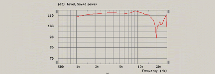

In the process of trying to get more accurate sim results, I thought I'd post the following to show how close one can get.
Joined 2003
Update. From a whole bunch of data from sims, I decided that the configuration for this data (23cm diameter at baffle blending edge) is interesting enough to test. Pretty close to an OS. What really worries me is that manufacturing tolerances seem pretty critical.
