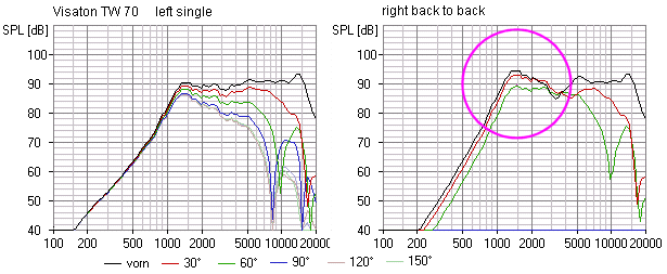

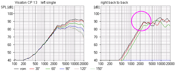

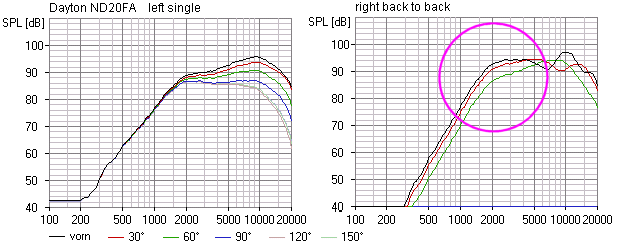

Michael,
I am not so sure about that. Everytime I try to turn some tweeters into (sort of) CD devices by putting them back to back in dipole fashion, the response in the (sort of) CD region has a tendency to fall - compared to the single naked tweeter. :rolleyes:
Below are simulations, but I could veryfy the sims for the Dayton with my own measurements.
attachment.php
attachment.php
attachment.php
Maybe it's because of the first dipole notch that's causing falling response. In theory one get's multible notches in dipole, but in practise the notch deepness may not be very big and seems like response variations.
- Elias
Did you measure it yourself? Would you be so kind to post data that is less smoothed (1/6)?
Yes I measured the data. If 1/6-octave wavelet is fine I can post that :D

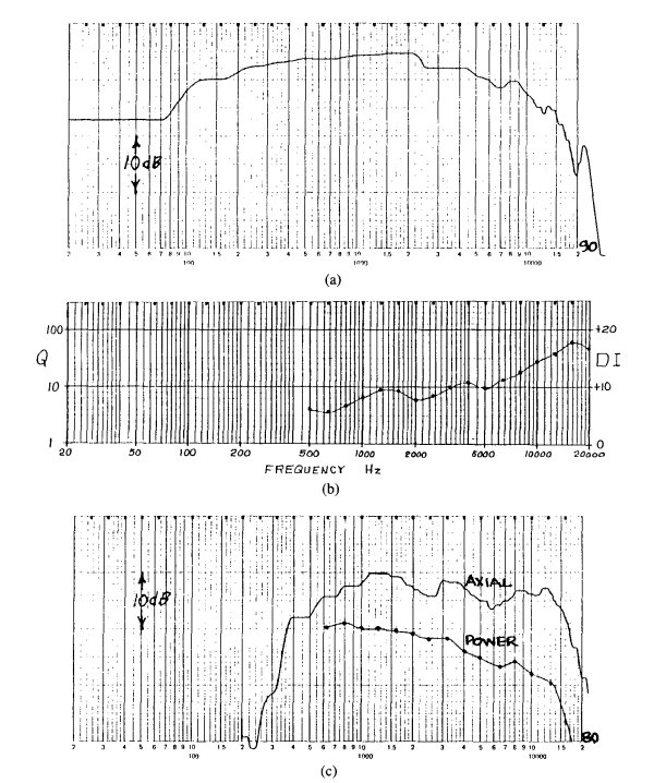

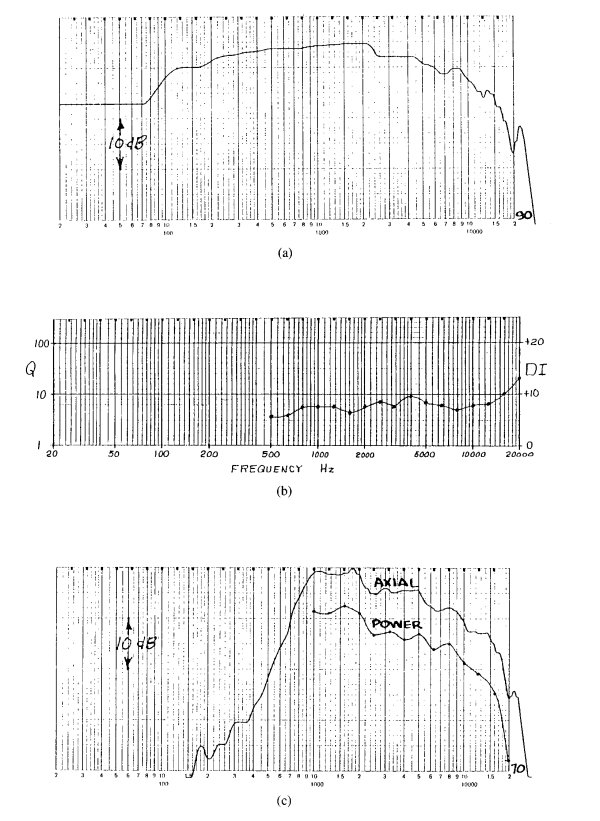

Or just saying it's wrong with nothing to back that postion up. The key to this is it follows the devices power response, whatever that is. With a compression driver it's real predictable what the outcome is. That's why I asked you where your compression driver and horn measurements were but of course you don't have any that support your position. Here is more support for one of those silly mantras and anyone with any real world experience using CD horns and compression drivers will tell you it absolutely the "one truth"
Here's a few quotes
Previous horns were judged on their ability to generate flat response on axis with typical compression drivers. This persisted, even though compression drivers were known to fall off in power response above the midband. A typical driver whose power response rolls off at 6dB per octave above 3 kHz (Newman [3] with a reciprocal increase in directivity index. The compression driver would then be acoustically equalized, but only on axis, as shown in Fig. 5.
When this compression driver is loaded by a constant directivity horn, the axial response follows the power response of the driver, as shown by Fig. 6. The very high midband efficiency given by horn loading allows equalization for both flat axial and, at the same time flat power response.

One more time and maybe I can make this a littlke clearer so that everyone can follow it.
Power(f) = R * V(f)^2, where R is the radiation impedance (real part) and V(f) is the frequency dependent source velocity. This is a fundamental law of physics and is not open to argument.
Now Power(f) is also the integral of Pres(f) ^2 over a surface enclosing the source (think of just summing all the points on a sphere), where Pres(f) is the pressure response, another fundamental relationship in physics that is beyond question.
Now back to the first equation. R is the radiation impedance and it is also well know that this term always becomes flat - independent of frequency - at higher frequencies, -this is true of any source with a waveguide, horn or not. Lets assume that we have CD, then Pres(f) is not dependent on directivity and the Power(f) will go as the square of Pres(f). Now if further, Pres(f) is flat (independent of f) on axis (or any axis since it is CD), then it's simple to see that the Power(f) will be independent of f and the pressure is independent of direction. This is what makes CD desirable.
This all means that if the Power(f) is independent of frequency then the velocity of the source must also be independent of frequency. But no source acts like this, all sources are resonant devices and above resonance the velocity must fall at -6 dB/oct (for a constant source voltage). This means that if the device is CD and uses any normal non-EQ'd source that the Power(f) must fall at -12 dB/oct above resonance and at higher frequencies. This equates to a pressure response that falls at -6 dB/oct for any real source which exhibits constant directivity.
A piston source has a changing directivity and it just so happens that its directivity narrows at precisely the same rate that the power falls. This yields a pressure response on axis that is independent of frequency, but the source is, of course, not CD and its power response falls with frequency.
The extent to which any source is CD can be seen quite simply by looking at the HF falloff. If it is less than -6 dB then it must be getting narrower at HF - 0dB (i.e. flat) and its directivity must be narrowing as a piston (narrowest) and if it is -6 dB then its directivity is not changing, i.e. CD. All real sources will lie somewhere between these two extremes.
This is all simple math and if your results do not agree with these then they are incorrect and you should try and figure out what you did wrong.
