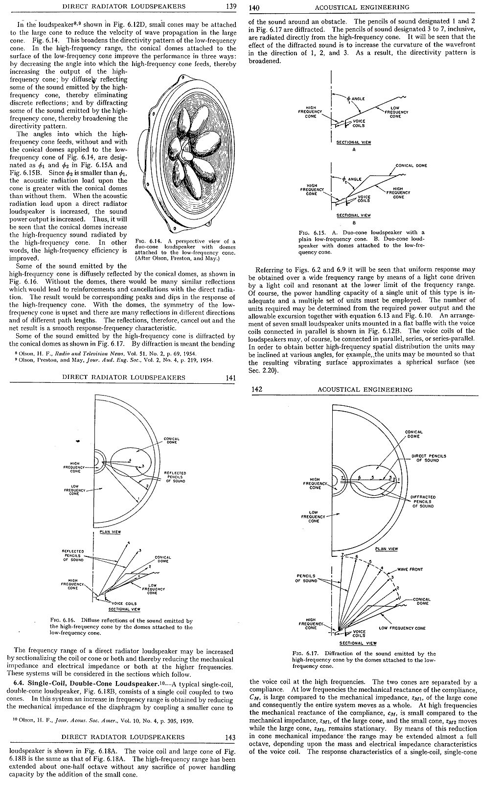

Earl,
Any comment on the technical merits of the "bumps" in this WG?
According to a magazine review, Klipch says: "the wider the horn becomes, the more inconsistent it becomes, especially at extreme high and low frequencies. A conventional horn with a large mouth and shallow depth will cause sound waves to lose contact with the horn walls which can result in less uniform dispersion...by adding bumps to the horn, the XT design slows the flare of sound waves and forces them to hug the horns walls, leading to better dispersion across the frequency spectrum."
I don't see any reason for them - not that logic or scientific rational has anything to do with audio.
What does the manufacturer claim, or is it asking too much for an explaination?
Yea, H.F. Olson came to mind when I saw them as well.
Before criticizing the idea out of hand, why not look at the patent that was assigned to Klipsch (last year, I believe). You can then get an idea about the problem, solution and application.
Regarding the text from a advertisement, I would not rely on that for information.
