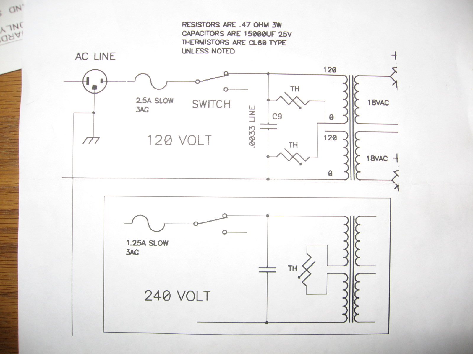

When I look at the Nelson Pass owners manual, the Power supply is connected to the chassis ground via a thermistor.
Yet from what I can determine Christian's wiring diagram does not connect the PS to chassis gnd.
I have also seen diagrams with "star ground" configurations where even the
-ve speaker terminal is connected to the star ground as well as the PS and
input signal ground.
Will all of the above work in the same way are these other methods for special applications??

I think Christian left the thermistors off of the power supply board. The thermistor is to help prevent a ground loop. I plan to wire it in according to Nelson's circuit. I think he has pretty good judgement.

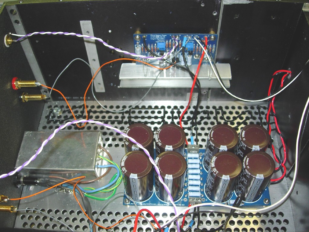

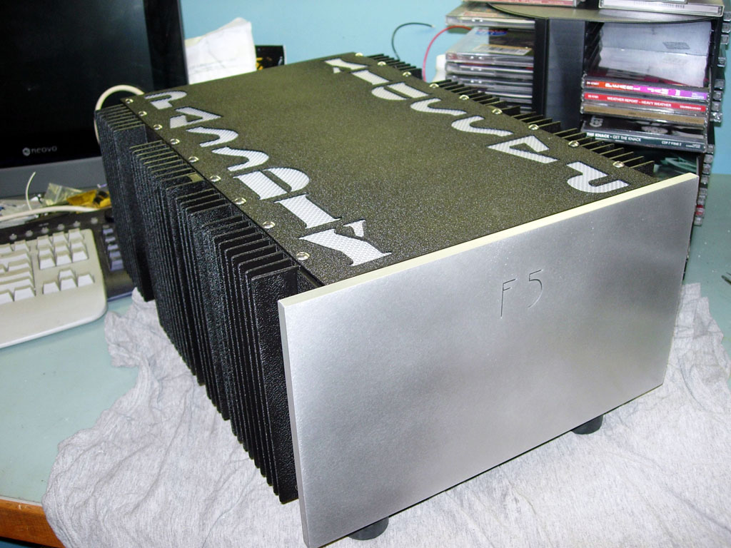

These pics show how I built my F5.
The first pic is the thermisters
the second pic shows the 2 ground wires from power supply pcb
the third completed
I figured that once it worked I would go back and shorten and generally clean up the wiring, however it sounds so good I have just been listening.
I would think it's right, because the amp is completely silent with volume at max and no source playing. I connected the power supply board to ground.

For your safety both chassis and power supply need to be grounded. The chassis directly to safety earth (the 3rd ground pin from the power connection) and the power supply to either safety earth or chassis (since the chassis is/should be connected to safety earth it's the same thing) via a cl-60 or other disconnecting circuit.
As far as the 2.2k 3Watt resistors on the power supply, they are optional, used to drain the caps on power down for safety. If you have speakers connected they are not necessary and perhaps sounds better without them. The R3&R4 2.2k resistors do not need to be 3Watt.

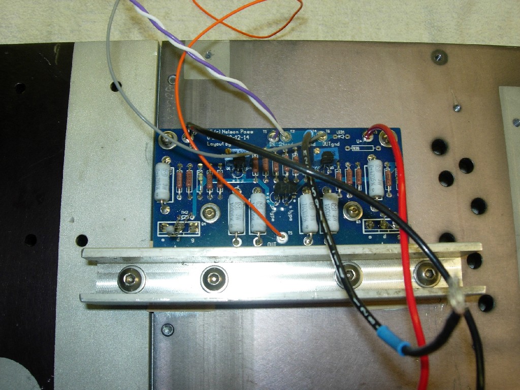

Is that a hunk of u-channel alum. to clamp down the outputs?
That would give some extra finned cooling. How did you bolt it?
Through the mosfet holes or not.
Yes, dimensions are 3/4" wide x 1" tall x 1/8" thickness.
here is a pic of the bolts, they are 10-32, and are on both sides of the mosfet.
