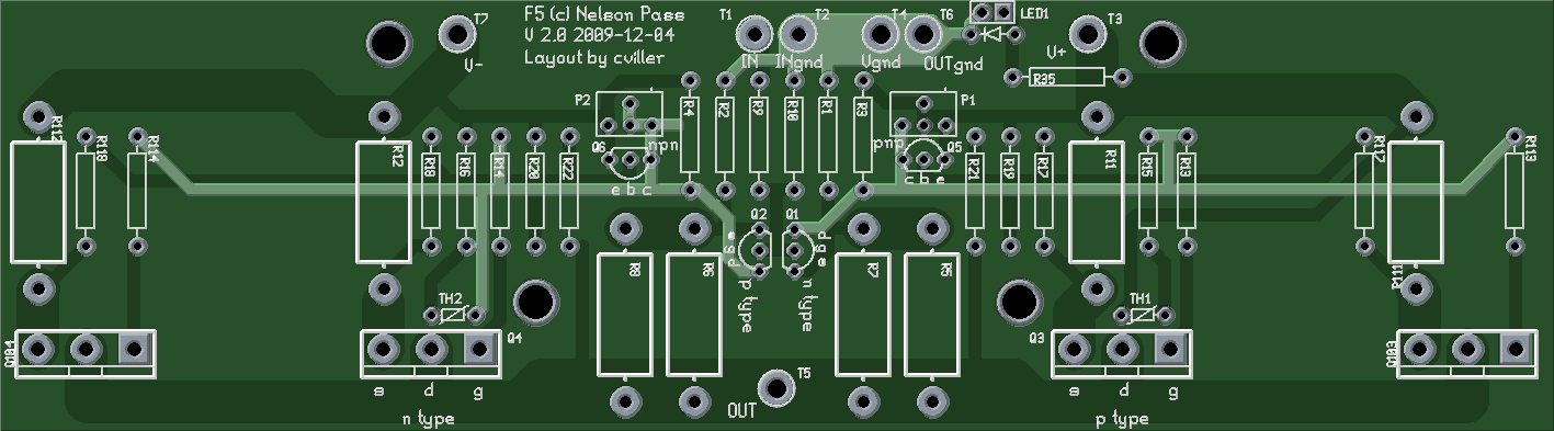

F5 version 2
Ok, this is not the final design, but here is what I had in mind.
The board is 180x50 mm

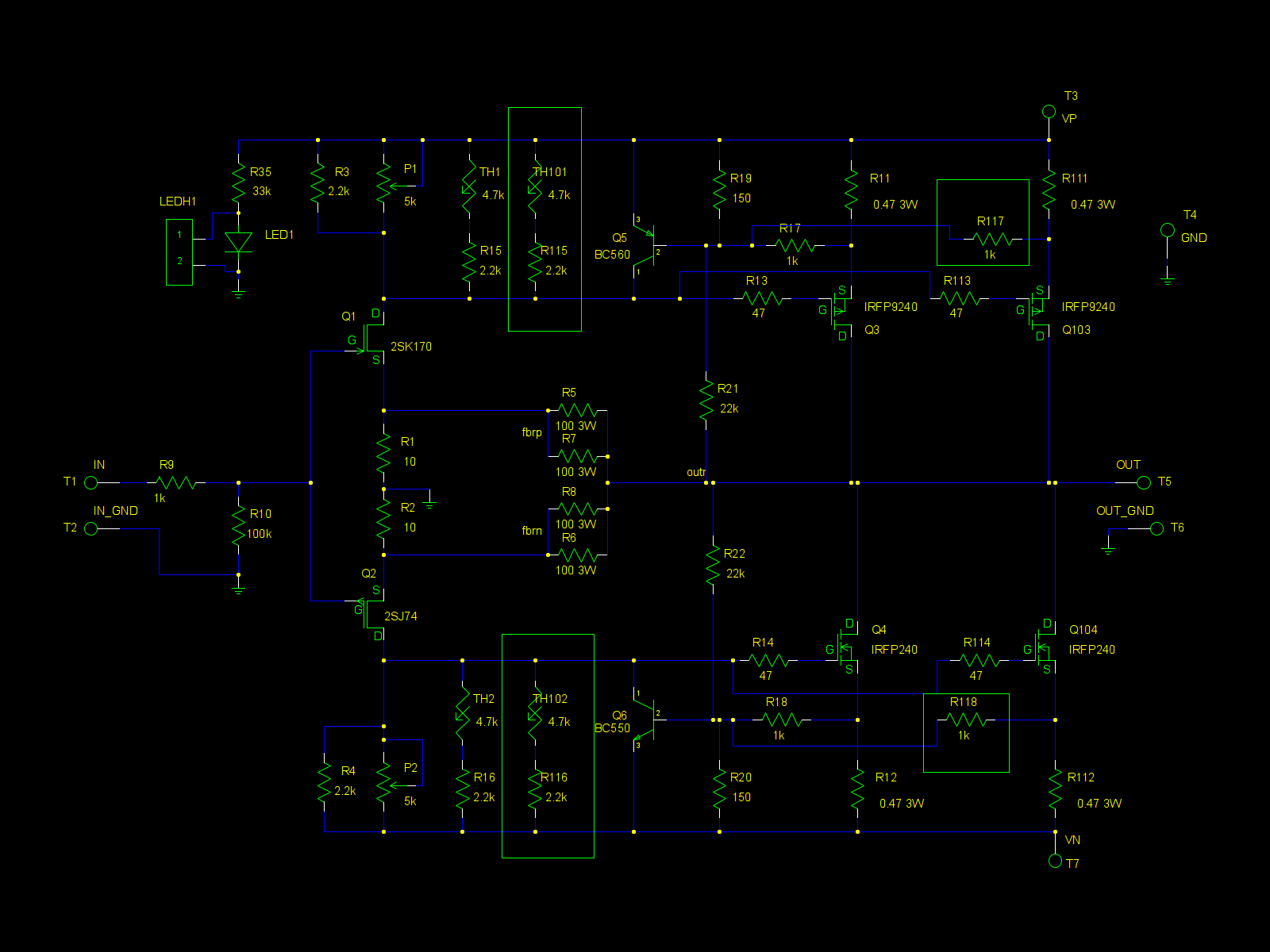

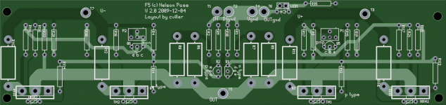

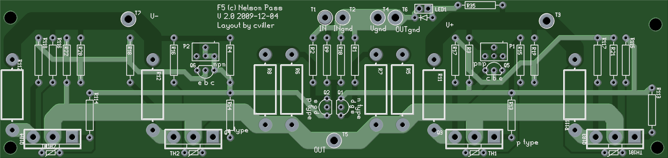

Ok, here is what I have come up with. I need to clean the silk screen, but besides this it should be pretty functional.
The board is 190x45 mm. You may notice that I have placed the thermistors differently. This is to make it easier to mount. The drawback is that I had to run traces in between the mosfet footprints, but this should not pose any problems IMO.
Any comments?
Looks nice with the parts spread out a bit. Not that I would use two pair of outputs but are the pairs too close together?
Why would someone use two pairs of outputs with the same current as one pair?
Well I have added the extra footprint mostly for people who likes to use more devices - as an extra option. But you are right if you run them at full throttle, you'll need to make sure you can transfer the heat away. You can use a copper spreader if you like.
I think people who wants to do this will probably end up running each device at 700 1000mA or so - if you want to push it further you need prohibitively large heatsinks imo.
