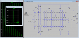

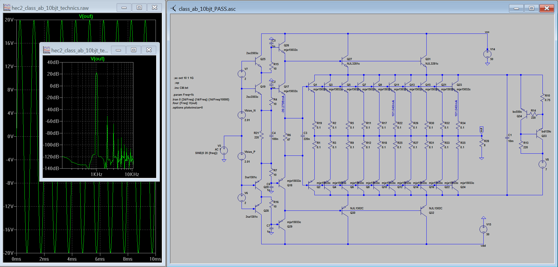

C3 serves to speed the switching off of the output transistors, a 220nf is enough.
Nelson Pass has many years ago invented a circuit that can overcome the problem of using high bias current, in this example the bias current is 1A but the amplifier only waste a bit more than 25w per channel without the pass circuit the amplifier will dissipate a bit more than 100w or 200w in a stereo amplifier.
Also the .asc file if someone want to further investigate the concept.

Pawel this is only a test circuit to demonstrate a concept, in a pratical circuit the output transistors should have base resistors.
edit: and the pre_drivers transistors should also have base resistors and caps to ground as the drivers transistors have, to slow the circuit.

Segio, you used 100 uF for C3 in your previous schematic, that is why I asked.
I will simulate your OPS and let you know.
UltimateX86, if we omit the emitter resistors from the output the distortion will be lower but the problem is that in doing so the stage becomes thermally unstable, so in practice those resistors can not be omitted.
I really don't recommend the Sziklai pair for class AB, because the distortion at the crossover region is worst that what can be achieve with the darlington pair. In class A the Sziklay is more linear than the darlington, but again I personally don't recommend class A (just ecological issues of course :) ).
