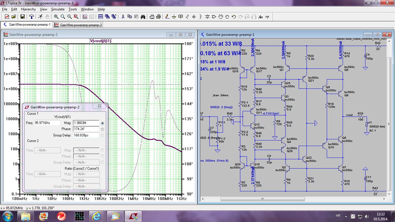

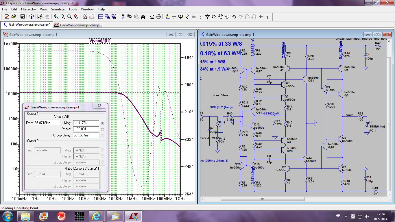

here is the IPS output impedance, it's quite high(2Mohm) and that is why is not easy to find good power buffer with enough high input impedance.
Damir
...Surprisingly how an amplifier with no GNFB can easily oscillate...
Hi Dadod,
yes, ngnfb,
maybe its voltage gain is ~1,
but please remember its current gain is h u d g e
