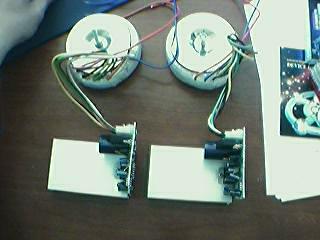

The solution for that is using the 50k multi-turn pot, as I use.
Carlos, as a matter of interest, have you measured the values across the two trimpots? If so, what are they and are they close to one another?
Yes, I did.
With the pot in place and tuned to 0.0mv DC offset, I measured something around 4k, if I remember.
I was surprized at such a low value.
Much different than 18k.
Ah ha - now IF I can find it, I think that I have a 20K trim pot somewhere around here!
Aha!
Yes, 20k should be just fine.
But it should be a multi-turn pot, or else you'll struggle to tune DC offset, it's too sensitive with a normal pot.

Yes, I did.
Carlos, I have just tried 20K trimmers in my GC monoblocks and got a variation in DC offset between 28mV (0r) and 24mV (20K)but nowhere near zero.
I wonder if, when you measured that 4K it could have been 46K?
I've stopped for lunch now but this afternoon, I will put a 30K resistor in series with the trimmer and see what happens.
(I should be out on my bike but the Portuguese have taken all the sun again )
Hey Nuuk,
No, it was around 4K what I measured.
And before mounting the pot I measured it was about the middle of its resistance (25k), and I mounted it in a way it decreases resistance as I turn the pot leftwise.
After mounting it, I turnd left, and left, and left...
When it hit 0.0~0.1 mv I stoped and measured the pot.
It was around 4k.
I don't know what's happening in your case, but the pots are cheap and you could buy two of them and test.
