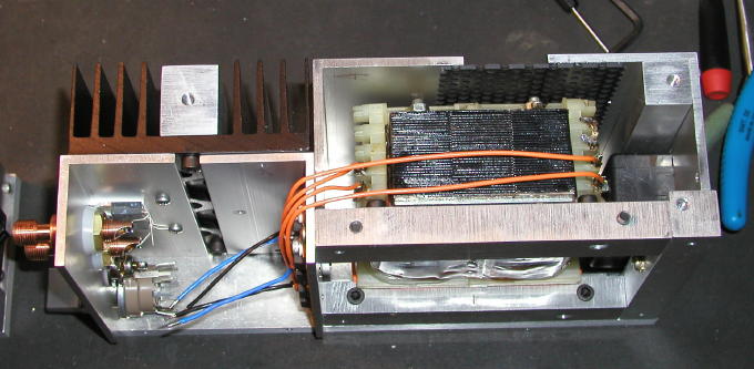

Recently I had a chance to redesign my monoblocks. I removed TDA7294 chips and installed LM3875. I also put there 1000u/50 BG N type caps (2 per channel) with 4.7 BG N bypass right at the chip. I used Caddock 220K feedback resistor and stepped volume control at the input with 3 10K Vishay S102 resistors and 5 positions only. The pot is in series, without connection to ground. I also used Cardas wiring inside.
Initially on a first try the sound was so disappointing that I couldn't believe But after 2 days the amp is singing indeed. I guess it's BG that needed more time to improve. One mechanical area that was quite critical was a bottom cover on the circuit side. Initially I used 1/4 aluminum plate with a brass spike in a center. The sound was kind of flat and not involving. I took out that plate and placed a piece of 3/4" maple block and the sound open beyond my expectations. Adding another strip of 1/4 acrylic under the wooden block improved it even better.
This is the best gainclone I made so far I guess. And this time I keep Fedde happy too as I used stepped volume switcher

Better IC pins?
I think that its great the way you've situated the chip to allow the pins direct proximity to the output binding posts. Can’t make the signal path much shorter than that. Have you considered trying to beef up the pins by laminating copper or silver conductors to them? I cant imagine that the IC pins were designed to do anything another than be tinned conductors.
I was also a little surprised to see the shielded split core transformer. Was there any specific reason you chose this over a torroid?

The main reason was size and shape and the way it could be mounted. I got those transformers 20 years ago and finally put them to good use. Soundwise there is not much difference than toroids.
The pin from output to binding post is less than 6mm. I might beef it up later. As to the other pins there is no need as everything connects directly at IC's case.

Peter Daniel said:This is the best gainclone I made so far I guess. And this time I keep Fedde happy too as I used stepped volume switcher
Very happy now, thanks

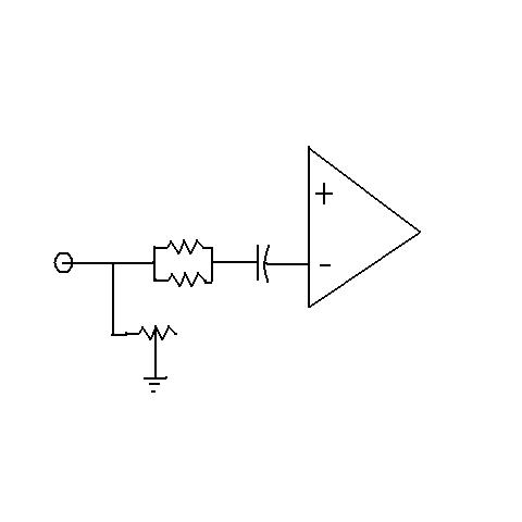

I have been reading these posts for a while... have a couple of questions to be sure I am on track:
1) a multi-turn trim pot (50k was mentioned, could 20k be used?) on the non-inverting input to ground will allow adjustment of dc offset. How does this pot do this? I am trying to understand what it is actually adjusting.
2) instead of using a 50k pot and a 10k 1watt resistor for the input, could 2 20k Vishay S102 (0.6W) in parallel be used with a pot shunted to ground? I attached a picture to show what I mean. This way the signal only passes through the vishay resistors, yet a plain jane pot can be used for volume control. The volume pot only shunts to ground, so it should eliminate the need for a high quality pot, and allow for a much broader adjustment range than a couple position stepped attenuator.
I tried it, but there is no really good regulation with 50k pot, as the pot should be in a range of 300ohms to make fine adjustments with volume.
As to the first question, depending what configuration you are using, but when the other input is connected through resistor to ground (same value as feedback resistor?) the offset should be less than 10mV and this is perfectly fine, without need for additional trimpot. I'm connecting the other input directly to ground and offset is less than 30mV. I understand tha offset issues are more important when bridging and paralleling amps and then the pot might be required.

I thought your schematic used a 50k pot on the input... I got the schematic from the main post of yours (very long one on gainclones) around post 890 or so. If you don't use this, then a 300 ohm pot should be used for volume control instead? That just doesn't seem right to me. Could you post what you did for your latest version on volume control where you mentioned you used 3 S102 Vishay resistors for a stepped attenuator? What would the input stage look like if I did not want volume control on the amps at all?
I realize with good parts that that the offset is minimal. The configuration is yours mentioned above. I know the trimpot is not required, but I assume it couldn't hurt, right?
Thanks again
50k pot will not work with a circuit you suggested, when fixed 10K resistor is in series and 50k variable pot between input to ground. In that case you need a pot around 300ohm to get proper control range. If you are using 50K pot in regular arangement (as on my older schematic) it works fine. What I did recently in my monoblocks, I set it up in a way that I have either 10k or 20k, 30k, 40k in series with input (by adding consequentive 10K Vishay resistors), without any resistance connection to ground. I have only 5 settings on my switch, but for now i like this simple arrangement as I don't listen very quiet It is usually no extra resistor at all, or only first one. I would say that might be the best pot there is, if you are not picky about perfect volume level.
Mach_Y said:I realize with good parts that that the offset is minimal. The configuration is yours mentioned above. I know the trimpot is not required, but I assume it couldn't hurt, right?
Actually the gainclone circuit is very sensitive to all the parts used and the pot might indeed hurt the sound. But I didn't try it, so can't comment for sure. But I prefer to keep things simple.
