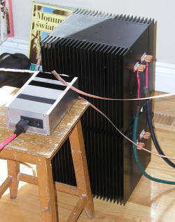

Anybody knows how the bootstrap cap really works?
The usual way I would suspect. It "bootstraps" the drain load of the VAS (Voltage Amplifier Stage) and thusly allows more voltage swing on the positive going halvewave where normally the VAS Stage limits the Voltage swing.
Sayonara
This boots ar made for???
Yes !!...and it does increase the open loop gain,so reducing distortion, as the drain load resistor with the bootstraps behave like a constant current source...!
So if the value of this capacitor is reduced the distortion increase at low frequencys...

Peter,
Impressive construction of the monoblocs. Layout so neat and short, utmost compactness and really cool looks. Very clever indeed.
Regarding the bootstrap capacitor, I think you can (almost) safely remove it from the circuit - only beware some (100 -150 mV) DC offset on the output.
Proper grounding schemes for inverted and non-inverted amps differ indeed. Will it be audible in your particular layout is another question. But yeah, one usually does not want to share input and output grounds in non-inverting amps. Another thing to beware with non-inverting circuits is to keep input and output well apart from each other because they are in phase with each other and can interfere.
Concerning the sound differences between LM3875 and TDA7294, it’s my personal guess, that you will newer get those two sounding equal and that is because the different circuits and semiconductor types encapsulated in these chips. What you describe as (I am quoting you here) - It offers somewhat thick and veiled sound, as if I were looking for something through a thin mist, more like a haze. Obviously, it lacks involvement and I really don't know if this can improve after burn in time - in my personal experience this is a typical MosFet sound.Others may disagree on this.
Lowering the PS bypass caps may give you more similar sound to the LM3875 but degrades the overall bass and low mid performance IMO. Also PSRR of the TDA7294 is only 75dB compared to the 120dB of LM LM3875. Bypassing PS bypass caps with 100n film caps (very close or strait to the pins) is considered as a standard with all OpAmps in order to prevent them oscillating.

This is the case with some conventional discrete circuits where the load is a resistor. In the TDA7924 there is already a current source in the load section, so no, it does not raise OLG.
In theory this cap can be totally omited with this particular chip.
I was considering that, but how can you keep them apart when input and output are just pins on IC separated by few milimiters? Anyway, those amp is more resistant to oscillations than LM3875.
