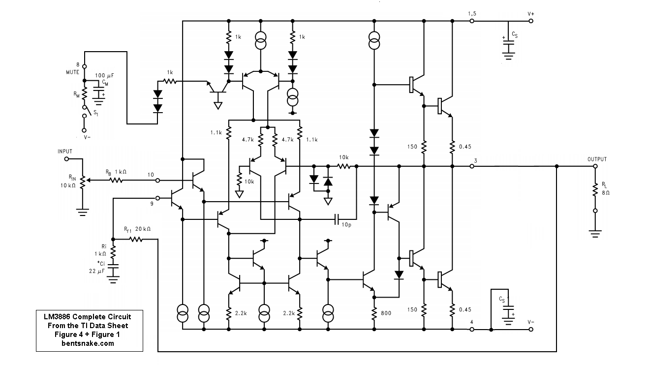

Attempt at offering an explanation for the new symptoms. (DC at higher volume)
When the current demand on the negative rail is high the voltage/current at pin 8 (mute) drops below its threshold and mutes the chip. When the current demand returns to the positive rail the chip is unmuted. If this is what is happening then the chip will output the positive signal and mute a large portion of the negative signal.

Interesting idea, Mark Whitney. Meanwhile, maybe it will help visualization to have a complete circuit. Posted is the circuit from the TI data sheet. Components from Figure 1 are edited onto the chip schematic on page 7 without any changes.
Of course, the data sheet shows only a partial schematic, TI doesn't give away all the goodies. But you gotta go with what you got.
