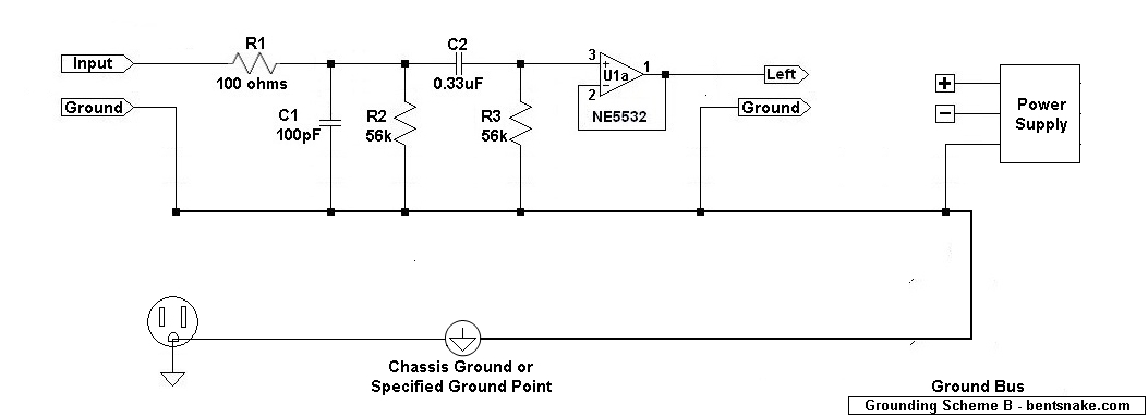

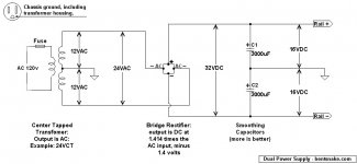

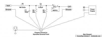

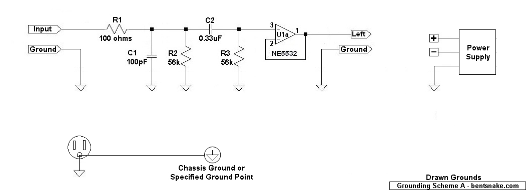

<< In my power supply, I do not have the earth connected anywhere, how do I connect it? >>
To cover this point only, I just happen to have some illustrative circuits.
First, just to cover all bases, is how grounds are usually drawn. Second is a "ground bus" that's never used with ICs (maybe tube circuits still use it, I don't know). Third is the correct star ground that's used with ICs.
There's also an extension of the star ground that involves two star points, or a "binary star," with the two points then joined into one. However, even though this binary arrangement has been around at least since the mid-90s, currently there are disagreements and what I consider some pretty bizarre ideas about how to implement it, so I'm ignoring the whole thing until ongoing research (mine) reveals what's what.

Sorry to be picky again, but there is no speaker or load negative. There's only power supply positive (Vcc), power supply negative (Vee), and ground. Ground is created by the power supply, and we consider that it has no polarity, it's just ground. (which is not so, but we agree that it is, so close enough)
The ground created by the power supply is always ground, and the only ground (another fun li'l fiction), so the speaker connects to an output and THE ground.
<< I do not have any balance on the amp, the balance is coming from my computer's sound card. When centered, there is noise, and noise disappears when either is driven in isolation. >>
Just guessing, I greatly suspect nothing about your amps, much about your input circuit(s). The two inputs should not be connected in any way, except at the single ground point. Certainly don't have them connected by being grounded to the chassis, again except at the single ground point.
However, if you can get everything plugged into one wall receptacle the problem might disappear.
