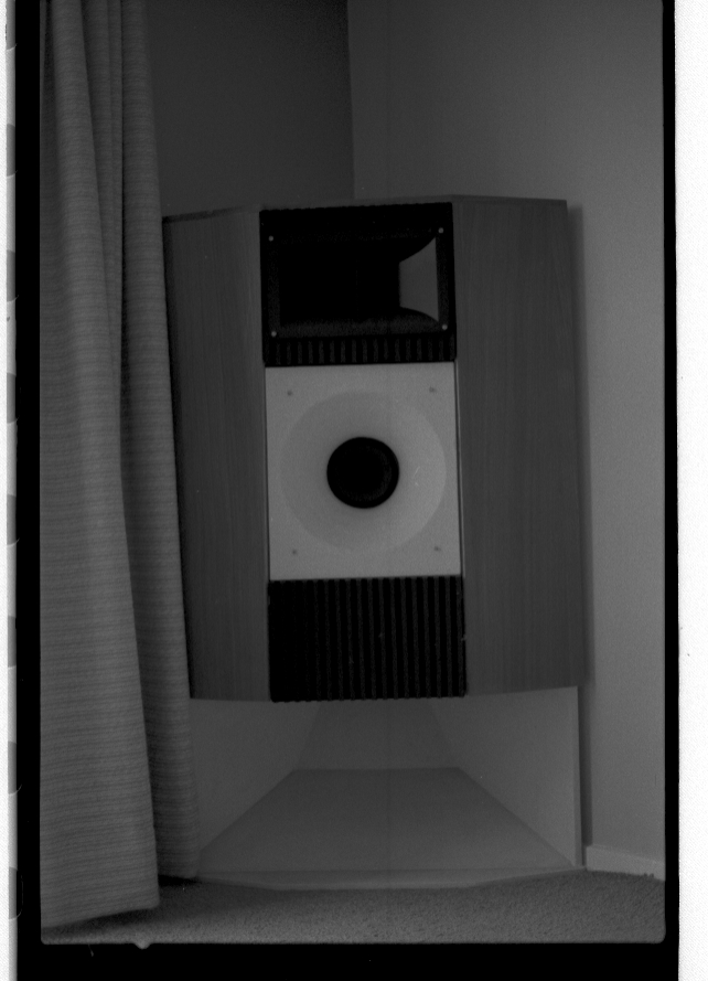

Great thread with some beautiful examples. I discovered it while looking for ones built with Hemp FR8. I have a pair of Hemp FR8c which I have yet to build an enclosure for, I am intending to build an Apra Grande (nice one earlier in this thread). I have a history of building things just to find out what they’re like. This picture might intrigue some of you. Sorry about the quality - it is an old photo scanned in.
It is a corner horn. In 1974 Jack Dinsdale published a series of articles in Wireless World on horn loading. I built this corner horn just to see what a horn did. It was a lot of effort for a cheap driver. It used an Eagle 6.5inch FR. It produced a huge room filling sound for very little input power. I can’t really say much about the sound quality –it was a bit shouty I think. I made a plaster of Paris horn to Dinsdale’s data and there was a small rear chamber which coupled the folded horn. A picture of this speaker appeared with reprint of Dinsdale’s articles in the Wireless World annual collection in ’74 or ’75. (I had a copy but someone "borrowed it".) Dinsdale did tell me that it would be better with Lowther PM6 units, which I never followed up. They were much too expensive for me.
I later added a Decca London ribbon tweeter shown in the photo. I used it for a few years then built something else. (A Deccavolt reflex cab with 10inch Volt unit crossing over to the ribbon)

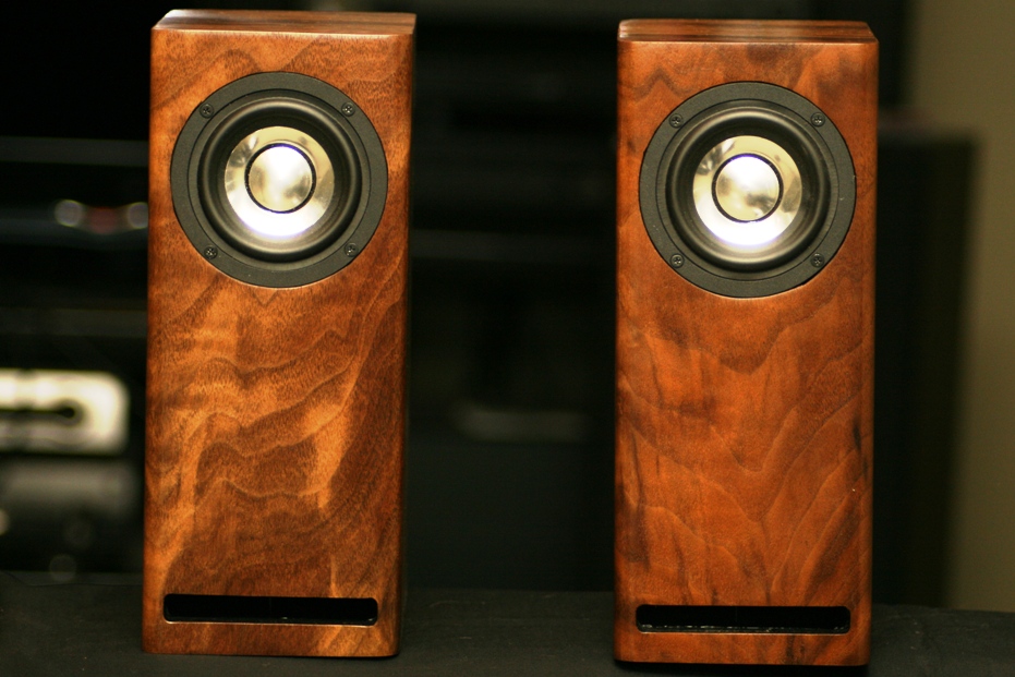

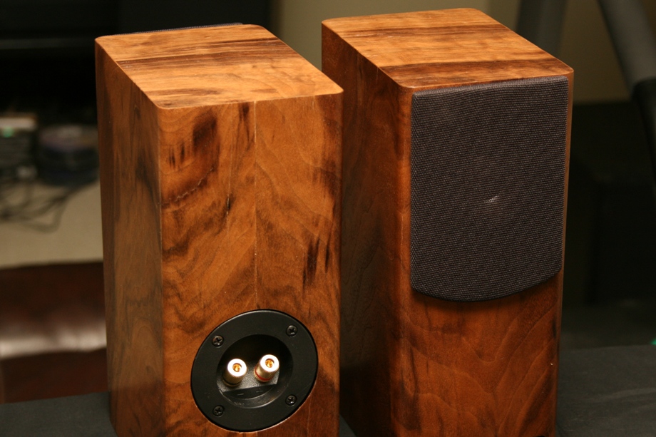

Now see, this is exactly what I was talking about. Just look at those pic's, I mean really look at them. Study the details and craftsmanship. Incredible.
I agree with you 100% Jman. Malibujeff's Martellos are indeed an incredible work of art, making then visually as wonderful to look at as I suspect they are aurally to listen to!
