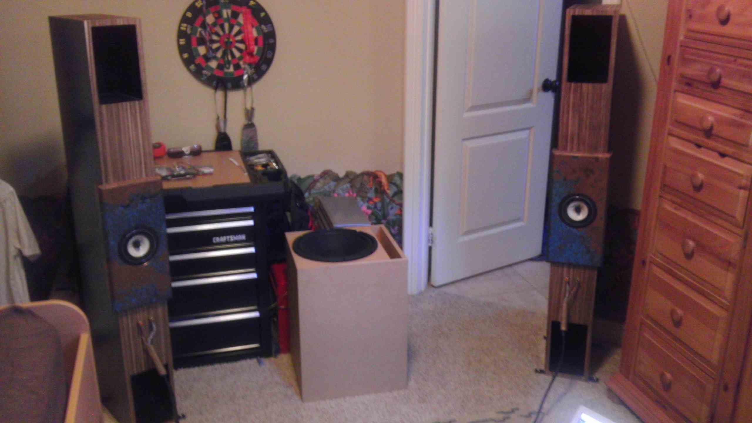

Aiko FE108E Sigma

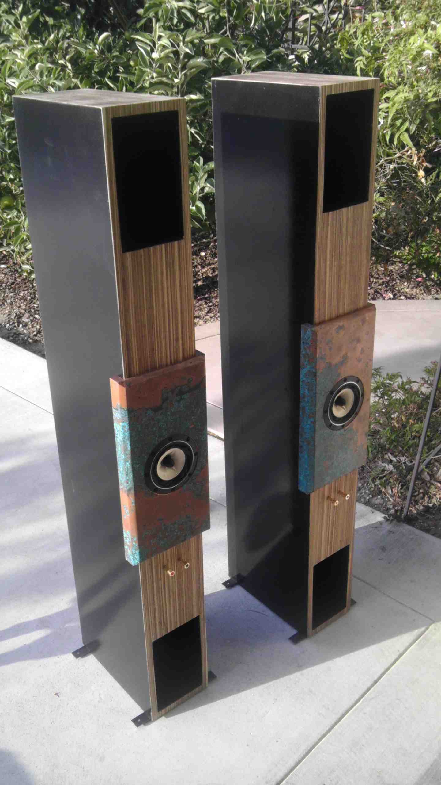

Here's the new Aikos, I finally finished them. Quite a lot of work went into these, probably between 30 and 40 hours, mostly on finish.
Zebrawood veneer on front, back and top.
Copper veneer (Azul Copper Veneer 24" x 18" - On Sale: $39.50) Supra-Baffle
Medium/High gloss black finish on the sides.
FE108E sigmas courtesy of Dave (Planet10) with phase plugs and cone coating. Thanks Dave!
I only have about an hour of listening in as I post this but they sound amazing. It's incredible... They are fairly dynamic too which is nice. Even with the tiny x-max and relatively small cone they can go pretty dang loud without worrying about excursion.
I've got them crossed to the negatively tapered horn I build last weekend for now, they are actually running full range with the sub crossed in, not to worry though I'm watching them carefully. XO is fairly low, around 70 Hz or so, it is nice being able to cross that low, I can't tell where the sub is at all.
Once I get all my chickens in a rom (or something like that) I will move them to their final resting place on the other side of the room and hook them up to the sofa subwoofer to get some REAL bass

I love the copper -- where do you get that.
Patina Copper Veneer Stock List
I used the smallest size, cut in half. I designed the baffle around the veneer so it fit perfectly. There was none left over and it wraps around behind the baffle by about a quarter of an inch for a pretty tight pressure fit.
The baffle is sort of removable in a worst case scenario. Its glued on but I can probably knock it off with a mallet. I would have screwed it but there was no way to do so without it being seen
The copper is my favorite part. It was worth every penny. It's even better looking in person than in the picture.
I made those outriggers from some flat steel bar and some #8 all thread. I sharpened the all thread and bolted it onto the steel. It actually looks pretty good, and it cost less than $10, which is a huge savings over commercial outriggers. They are incredibly stable, much more so than my other speakers.
