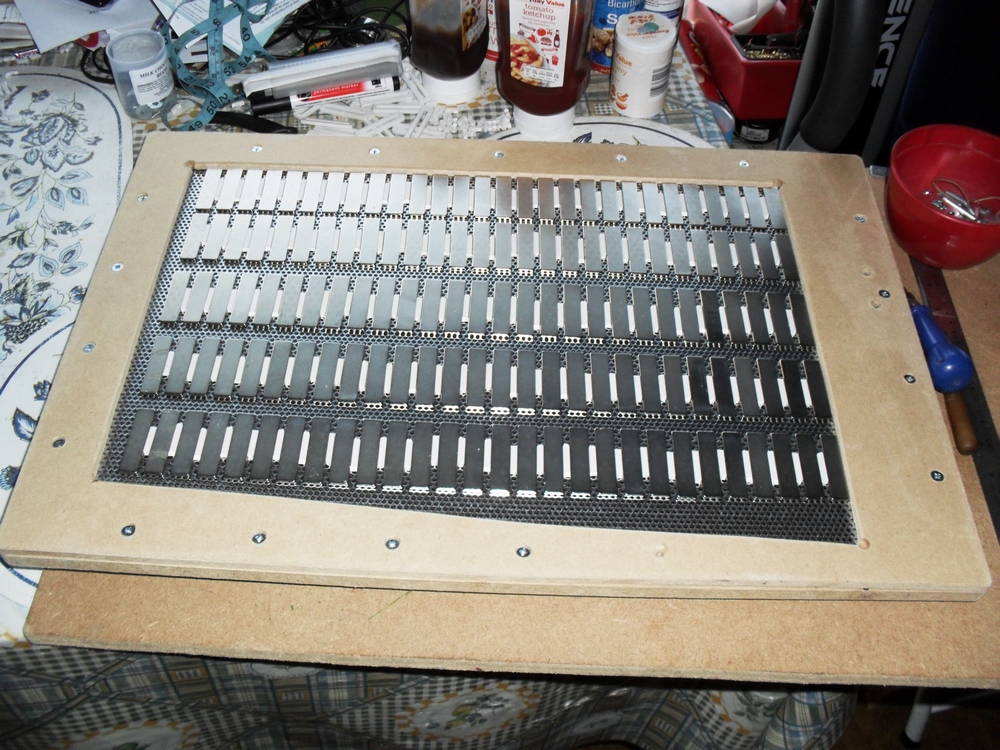

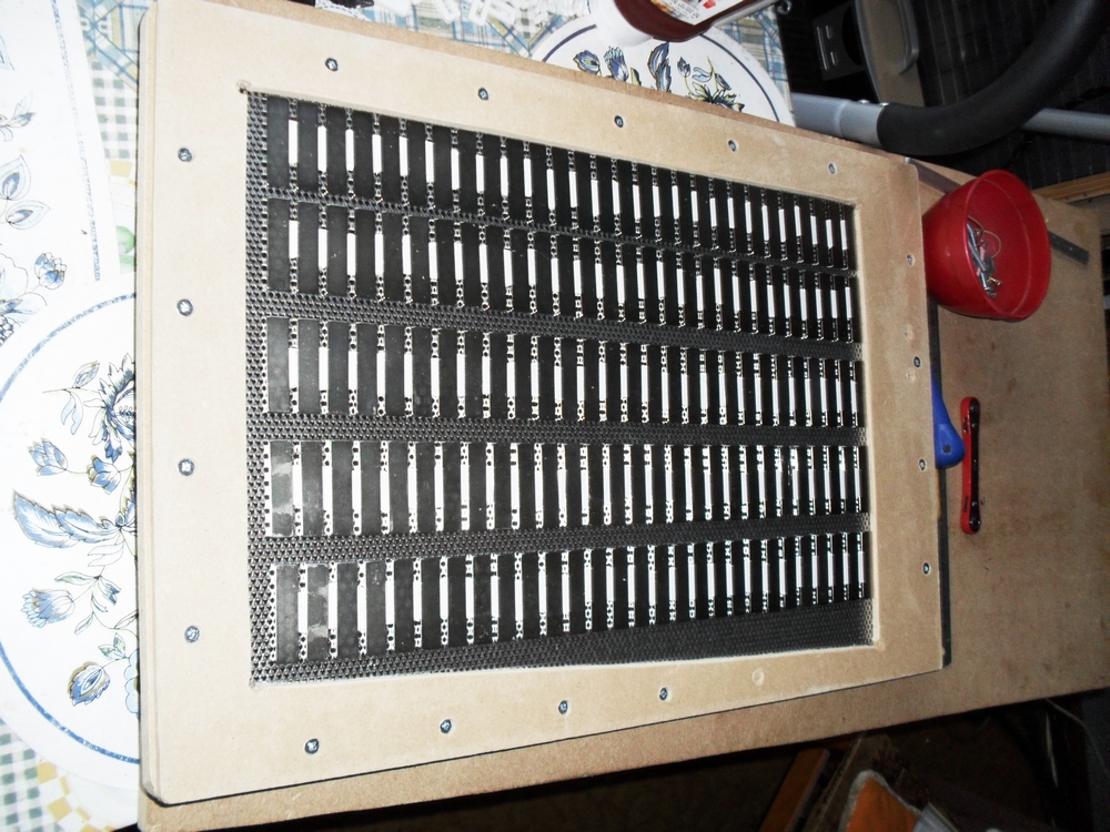

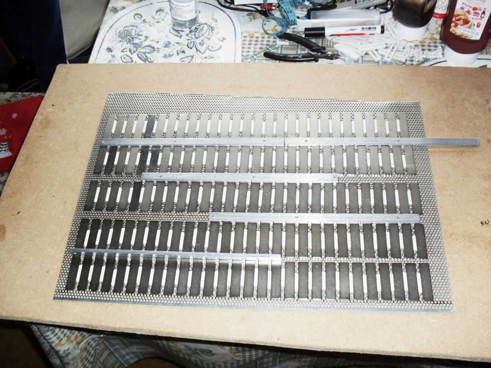

NEW DESIGN TRIAL
Have decided to try new design with about 3.9 mm gaps between the magnets, my son using some software worked out the gap size for improved sensitivity. We shall see, or not. Will use 3.9 mm wide plastic strips too keep the magnets apart. If this is a lot better, it will mean a lot more re-builds and more magnets to build more speakers. Wish me luck, and keep your fingers crossed, my back doesn't give in!!!

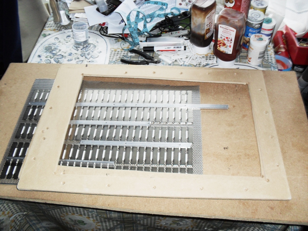

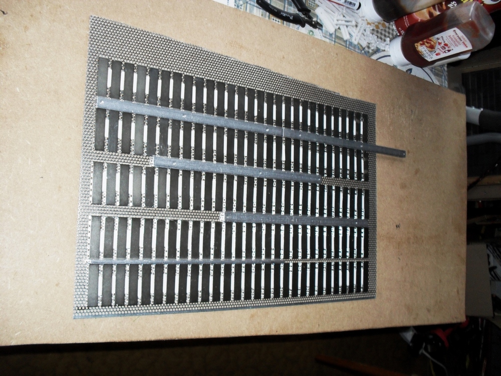

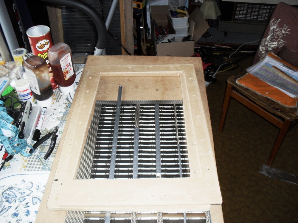

BUILDING TO COMPARE GAP AND NO GAP BETWEEN MAGNETS
Using 50 x 12.7 x 3 mm Neos with 3.9 mm gaps between N & S.
Which one is the monster? Have used all my 3 mm neos, only have 60 6 mm ones left, but have few more ferrites as well, with the success of the magnetic tape one, I will probably build some more of these if I can duplicate the first one which was as sensitive as a neo one. This was a big shock to me, you live and learn or not. I am still learning, surprise, surprise. Still there are so many different parameters involved, you will always be surprised. One of the perks of DIY!!
There is one song on my USB stick which sends one of gapped planars into a frenzy of resonance really loud, the other one is normal on this track. Changed them over just in case it was the amp, but no still makes the loud noise and diaphragm moves about an inch or more, any ideas???
Funny isn't it have played over 3,000 songs with no problems then one track comes up and everything goes tits up on 1 diaphragm. Just shows how strange music can be. Makes you wonder whether you know what you are doing at all! You think you have solved a problem then this happens, well such is life I suppose. Still have not found a similar problem yet on the pair I am using at the moment, with any other track. We shall see, one never knows what's round the corner.
