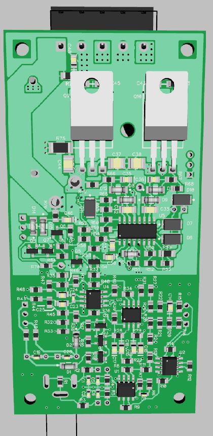

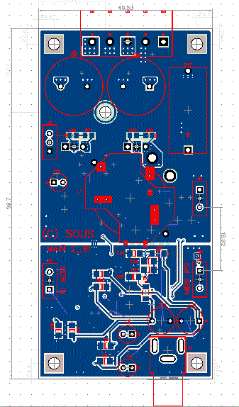

A new version of the amplifier with improved parameters and more convenient to install.
hi sous nice layout .please share your schematics and photos of your project

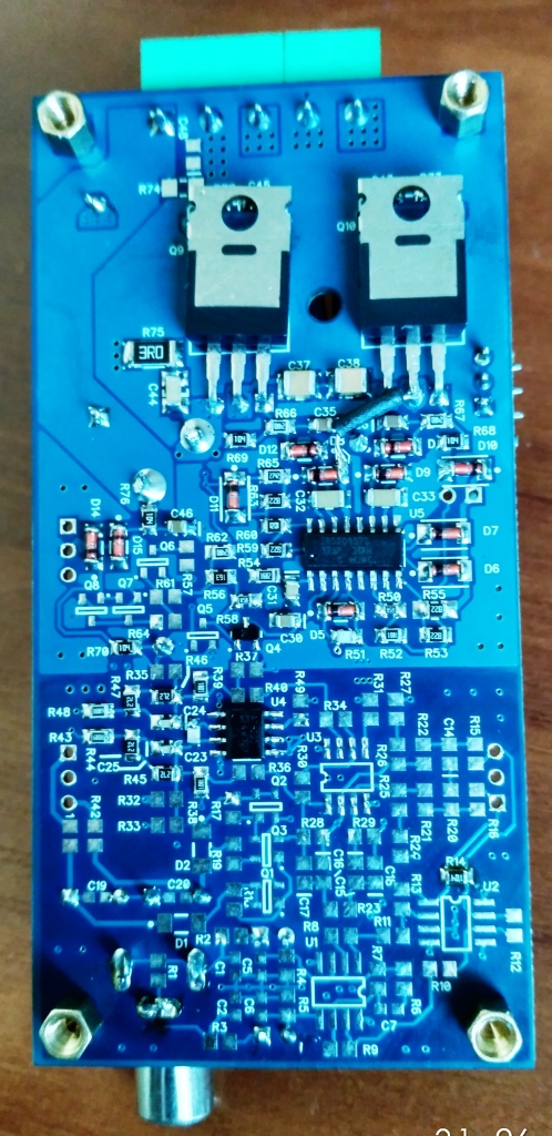

The fully differential modulator worked well, but the implementation of the PCB made the assembly very laborious.
I simplified new device as much as possible.

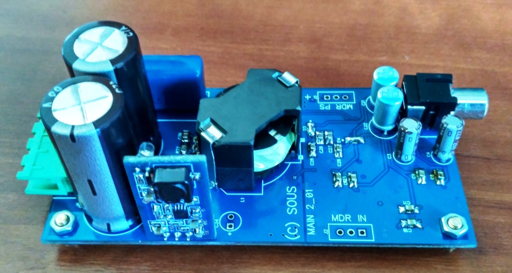

First prototype
Very neat design, thanks for sharing!
and, how is the output power for 8ohm load?
AgreeThank you very much Erica!
Power is limited by output transistors.
Service step-down stabilizers can operate up to +/- 90V.
I think 200W at 8Ohm should be for IRFB5615
For IRFB4227 it will be necessary to increase dead time, I did not try.
Yes, i want to know the working range of the dc-dc convert to support the gate driver circuit,
Also, i had try to build the amp with the IRS20957 plus IRFB4227, the dead time setting to 25ns, with the regualted power supply(daul 90V) to get 450W output for the 8ohm load! This IRFB4227 is very good MOSFET.
