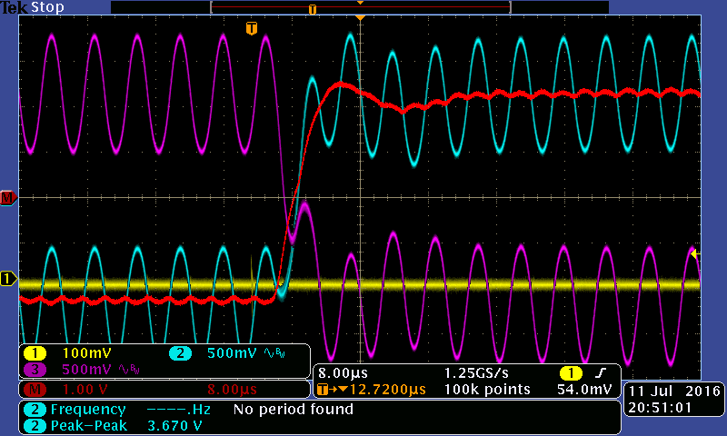

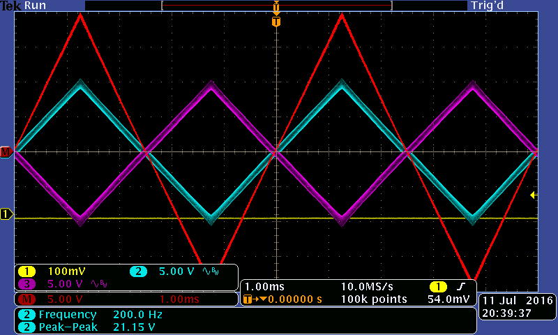

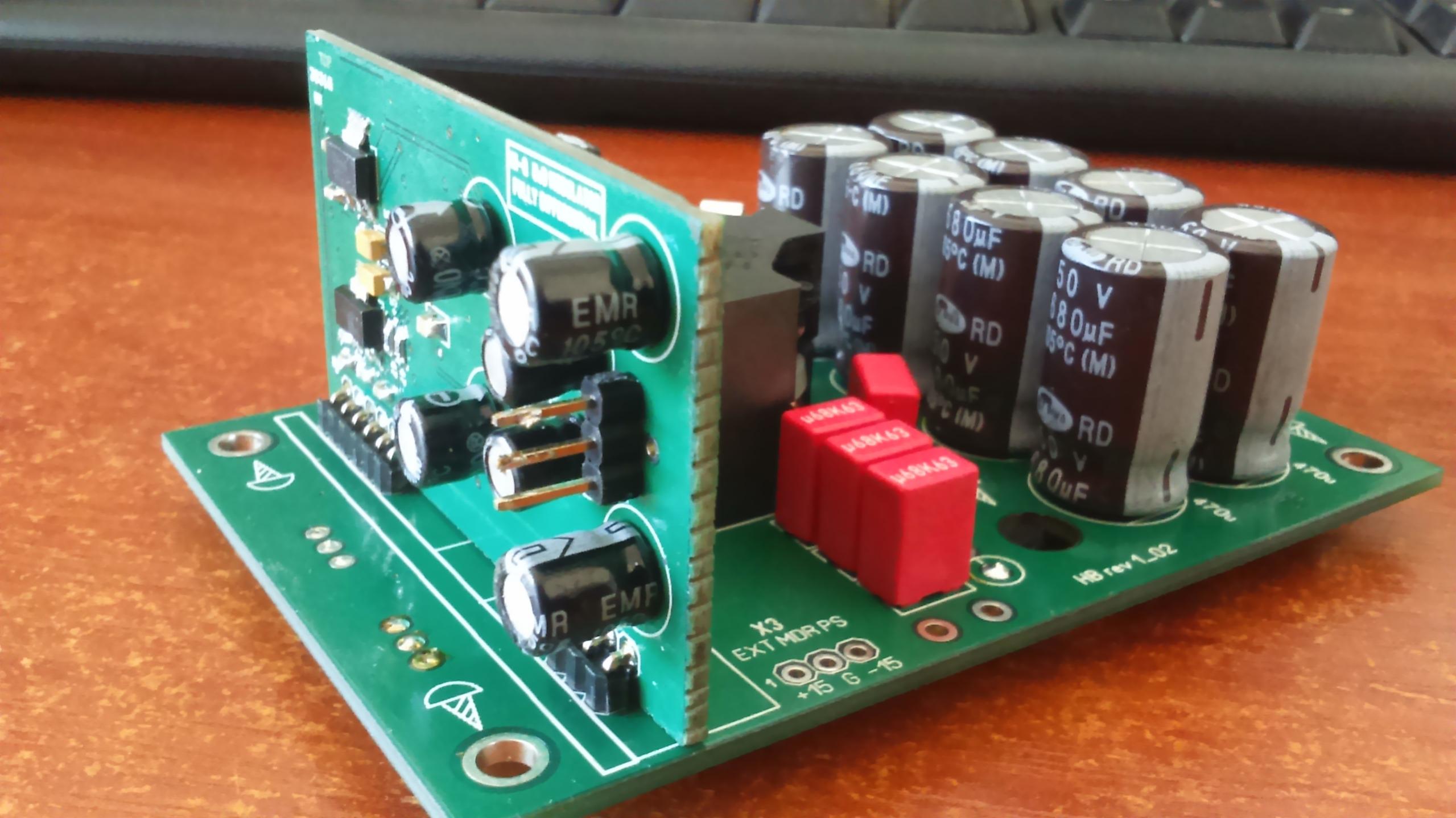

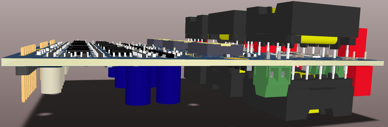

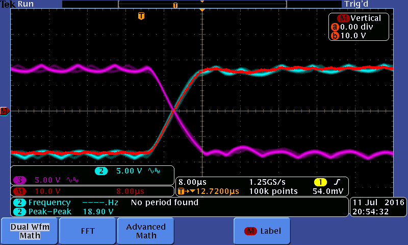

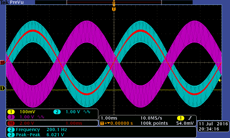

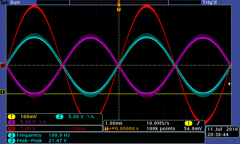

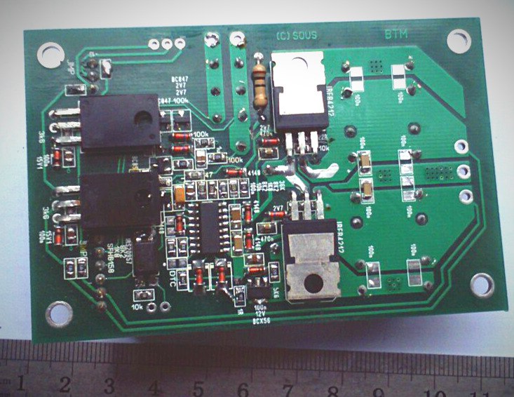

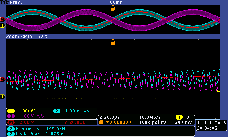

I have results, but I'm not satisfied with it yet. I only achieved -102 dB SNR because of a small interference on the breadboard prototype. It should be around -110 dB with only gaussian noise, but the basic concept works exactly as intended. It is not on PCB yet, but the 4 layer PCB design (6 channels of 80 W or more full bridge on 100*100 mm) is very close to finish. I hope with a correctly designed PCB will not have the interference.
These are the signals observed on scope (red: differential output voltage):
Small signal:
Small signal and carrier:
Large signal:
Large signal triangle:
Small signal transient response:
Large signal transient response:
View of PCB:

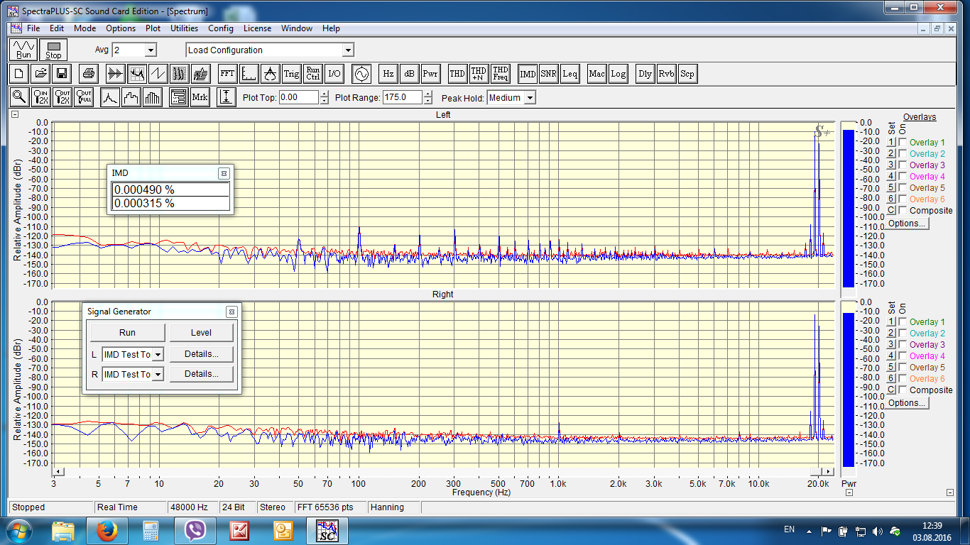

IMD test 35Vp-p
I still can see the attachments.
Very nice result! As soon as I can get rid of interference I'm going to measure distortion figures also.

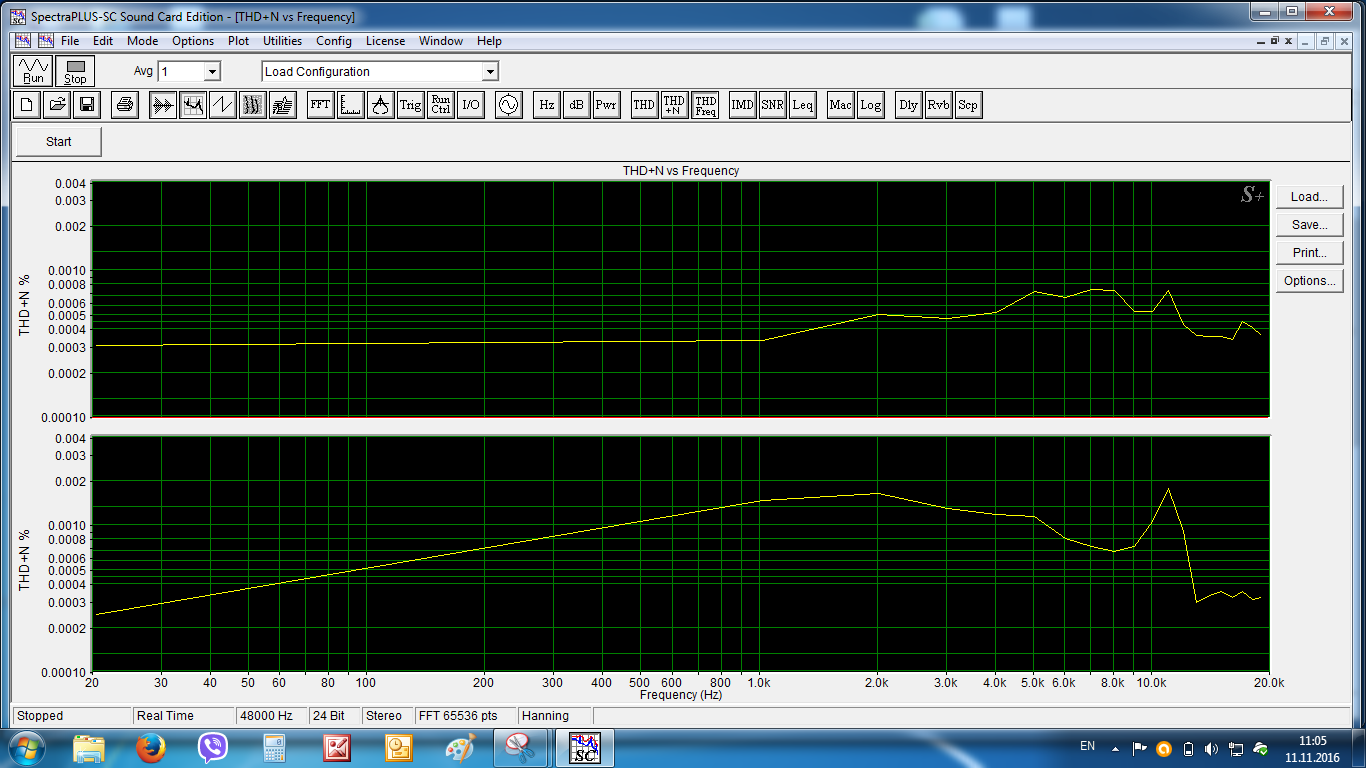

A new version of the inverter slightly improved results, in addition I have used step down converter LM5008 for the IRS20957 power supply
10W
3.3 Ohm resistive load
THD&N vs freq

I must say that, nevertheless, failed to get the values that are achieved in the original ncore.
The circuit layout is very critical to the power section of the inverter. It is advisable to do a 4-layer board. And the dynamic dead time control is desirable
However, it turns out a good amp for home use, THD + noise 1-15 watts less than 0.0015%
