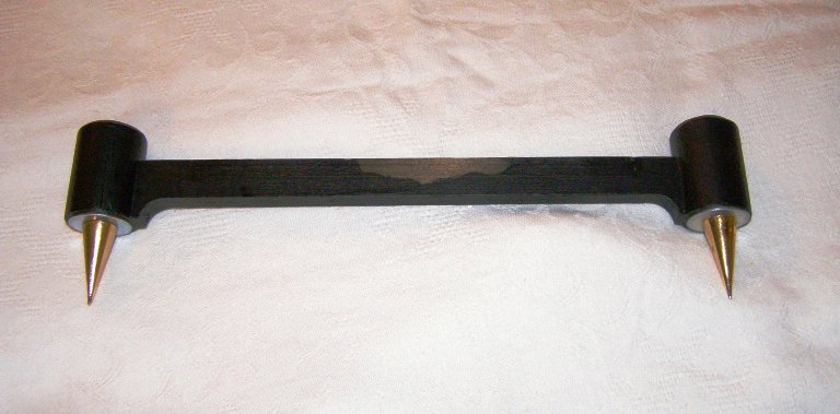

OK. A few have asked about the outrigger spiked feet. These are hand made from 10mm x 25mm Oak strip I had left from another project and offcuts from a broom handle. The spikes are Moncor jobbies http://cgi.ebay.co.uk/Monacor-Speak...omeAudioHiFi_HiFiSpeakers&hash=item5197c442e7 threaded into the broom handle offcut. Painted matt black and recessed (rabbited to you Yanks and Canadians) into the speaker base.
I made them for two reasons: 1). My listening room has a suspended timber floor with heavy wool carpet and this can cause bass boom without some form of isolation from the floor. 2). The FH's are only 7" wide and the outriggers give much better stability. They achieve both these aims. Piccies below
Wow, nice work Toppsy! They look very elegant and classy without being overdone or overblown etc, kind of like the very lovely and super sexy Kate Winslet!
