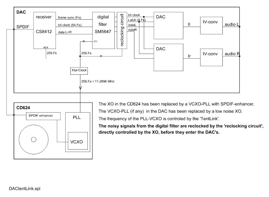

Theoretically the TentLink could be better, but trust the coaxial connection for the clock from transport to DAC! The frequency is only 11.xxx MHz. Good coax-connections with B&C-connectors are able to conduct microvolts at frequencies of 500 MHz, so..... it is absolutely unaudible!!!
In the posting of Telstar were two links to the TentLabs-solutions. Read them first, the ask again.
BTW.: Be careful with the names 'XO' and 'VCXO'. I know that even TentLabs is sometimes confusing with the names of their products. I always talk about:
'XO' (which is a very stable not tunable Xtal Oscillator) and
VCXO-PLL (a Voltage Controlled Xtal Oscillator, which voltage controls the frequency (a bit) via a PLL-circuit (Phase Locked Loop)).
The last one is always more noisy than the first one.
With the TentLink you need a VCXO-PLL + SPDIF-enhancer in the transport and an XO in the DAC. The clock-connection between DAC and transport is only to synchronise the VCXO-PLL in the transport to the XO in the DAC.
With my solution, you will ignore the VCXO-PLL. Just put the XO + SPDIF-enhancer in the transport and connect the XO-clock to the DAC. If a DAC should be powered on without clock, it does not harm it.

I drawed the TentLink in the same way as the DACprincipe1...5 to compare them more simple.

1. A CD-player (here often called 'transport') always needs an internal clock, because powering it on without a clock will harm it! There is NO 'jitter-reason' for it. Whatever you do, make a special circuit to-avoid-full-power-on-if-there-is-no-clock, or simply build in a slave clock (like in the TentLink) to avoid that the transport will be powered-on-without-clock. OK?
2. I do not believe in 'special cables', interconnects', 'interlinks' with gold-plated cinch plugs with carbon wires and/or special braids which are not soldered but clamped, etc. etc., or whatever they are called and costing a fortune. I even do not believe in 'line induced jitter'.
As an (analog) radio engineer, I know what the problems are. A decent 50/75 ohm cable with B&C-connectors will always satisfy if the EMC-problems will have been solved. For here this takes too much for explanation (if you do not force me)....
3. 'They' do not talk about an extra PLL-VCXO to enhance the clock from the receiver. Not every source (at least in a professional environment) will have more than one output connection: SPDIF or AES/EBU. In case a decent extra PLL-VCXO in the DAC is a second best solution!
In general: WHAT IS THE JITTER-PROBLEM (apart from building a low noise oscillator)? Why is it not enough to reclock the signals just before the DAC's (PCM's) with a low jitter clock?
Apart from cross talk and other coupling of circuits, digital circuits work digital most of the time, but during the switching they operate analog. In other words: jitter never will be 'filtered out' completely by reclocking it once. We should do this as many times as possible at any possible level.
Therefore enhancing (=reclocking) the SPDIF in the transport helps!
Question: Could reclocking the data between receiver and digital filter be of help? I never saw this and I never tried....
