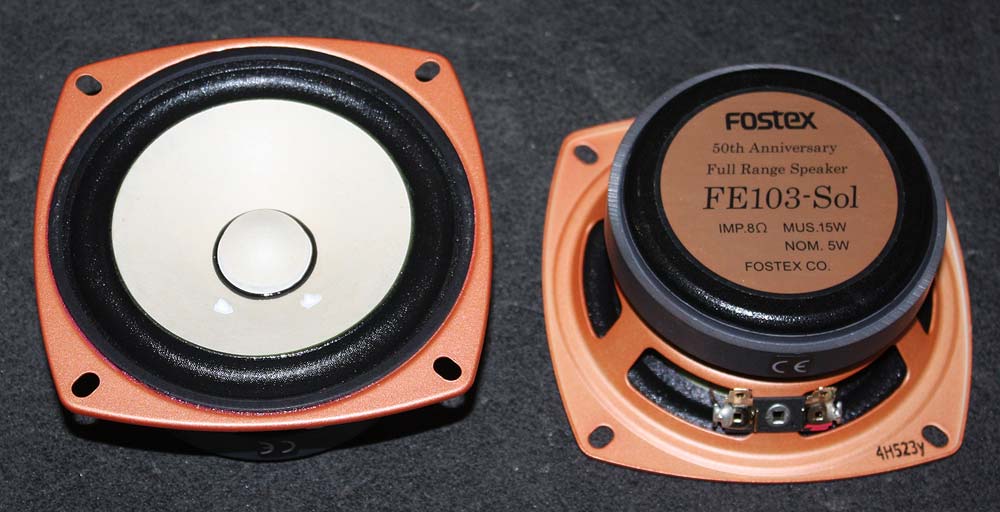

Just off the breal-in bench
attachment.php
dave
